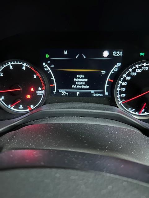

2022 LC 300 Vx 12,000Kms - Message on dash - Engine Maintenance Required Visit Your Dealer

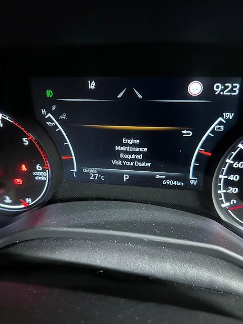

Interestingly, When car starts, wrench symbol and 6904kms - Then no wrench symbol and actual kms
I know another LC 300 owner who had the same message, ended up being an injector cap issue on cylinder 5.
Does anyone have any further to contribute. thankyou
As mentioned above, I thought my 300 series may have an injector holder / cap issue.  Looking into it further it looks like a common issue - I presume they call it the 7th injector as it appears on the engine after the DPF is used to process the fuel assisted combustion ?
Toyota is replacing it under warranty.
