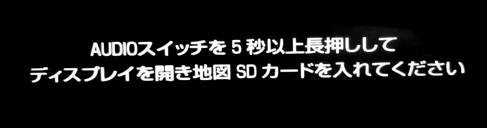

Requesting nszn-w64t head unit SD map files - Insert SD map
