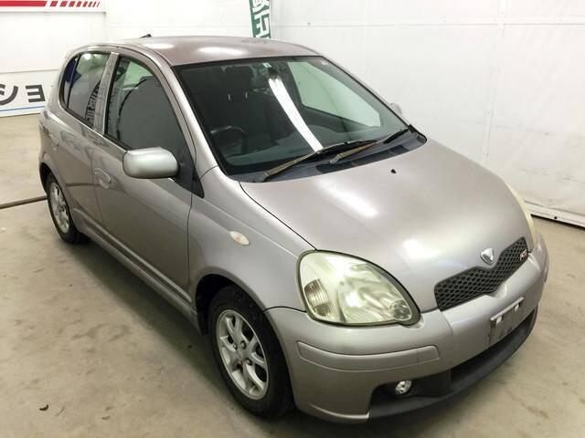

Got a weird one here over the ditch, I have a 2004 Vitz/Echo/Yaris with the 2SZ-FE engine, Ran great for years for commuting to work but now has developed an annoying issue, When driving along the car will give a sudden *****, The High temp light comes on and the engine check light comes on when it does it and it only happens for a split second then goes out and the car runs fine until it does it again, It will sit and idle fine for ages with no issues, I changed the plugs, plug holders and coils, Changed the crank angle sensor, Cam sensor, Water temp sensor, VVT sensor, Have taken every plug i can see off and cleaned them with contact cleaner and yet the fault is still there, At present i have disconnected the battery to try and clear the ECU, Kind of running out of ideas here, Anyone else got any cunning plans out there???
