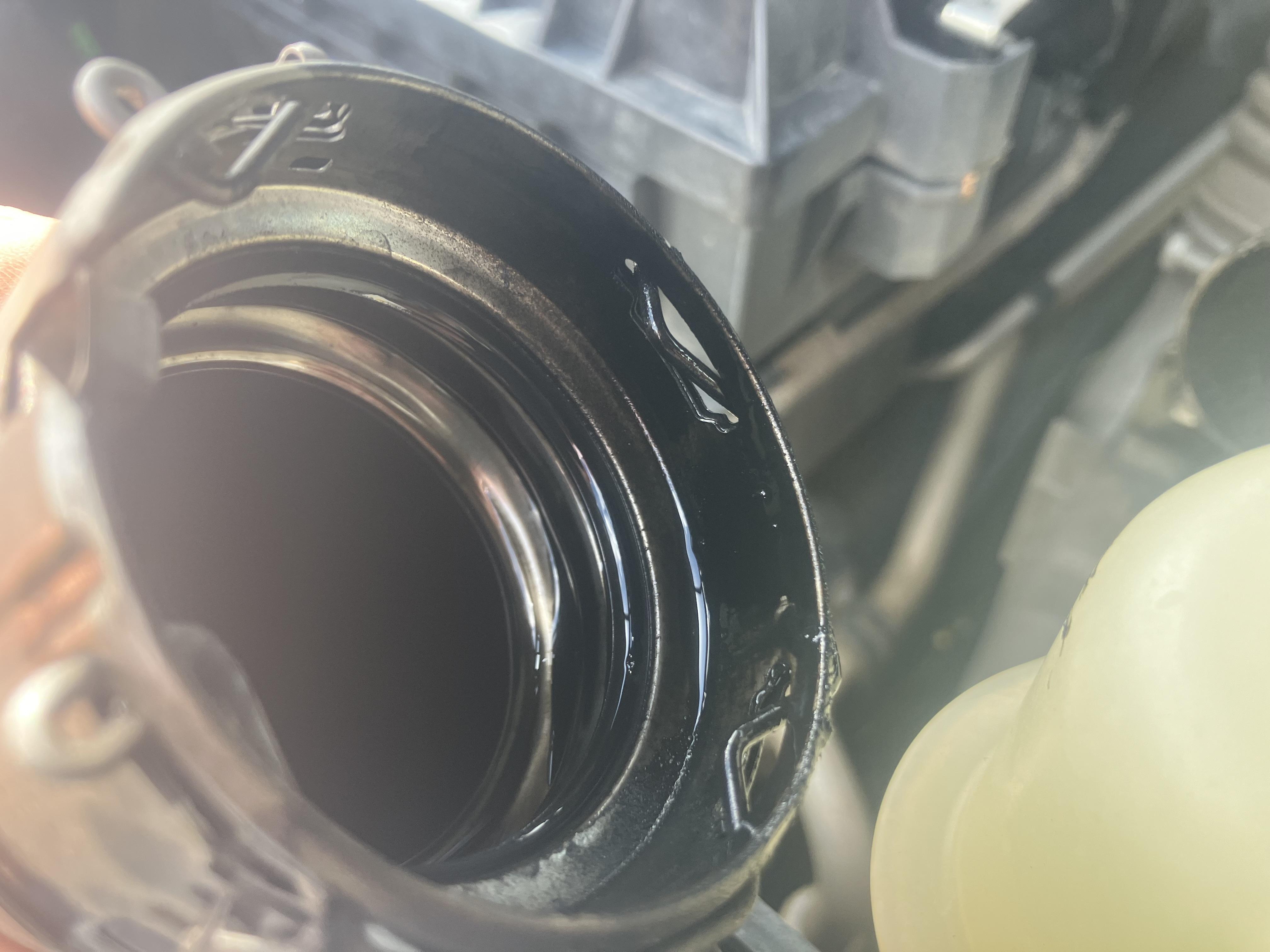

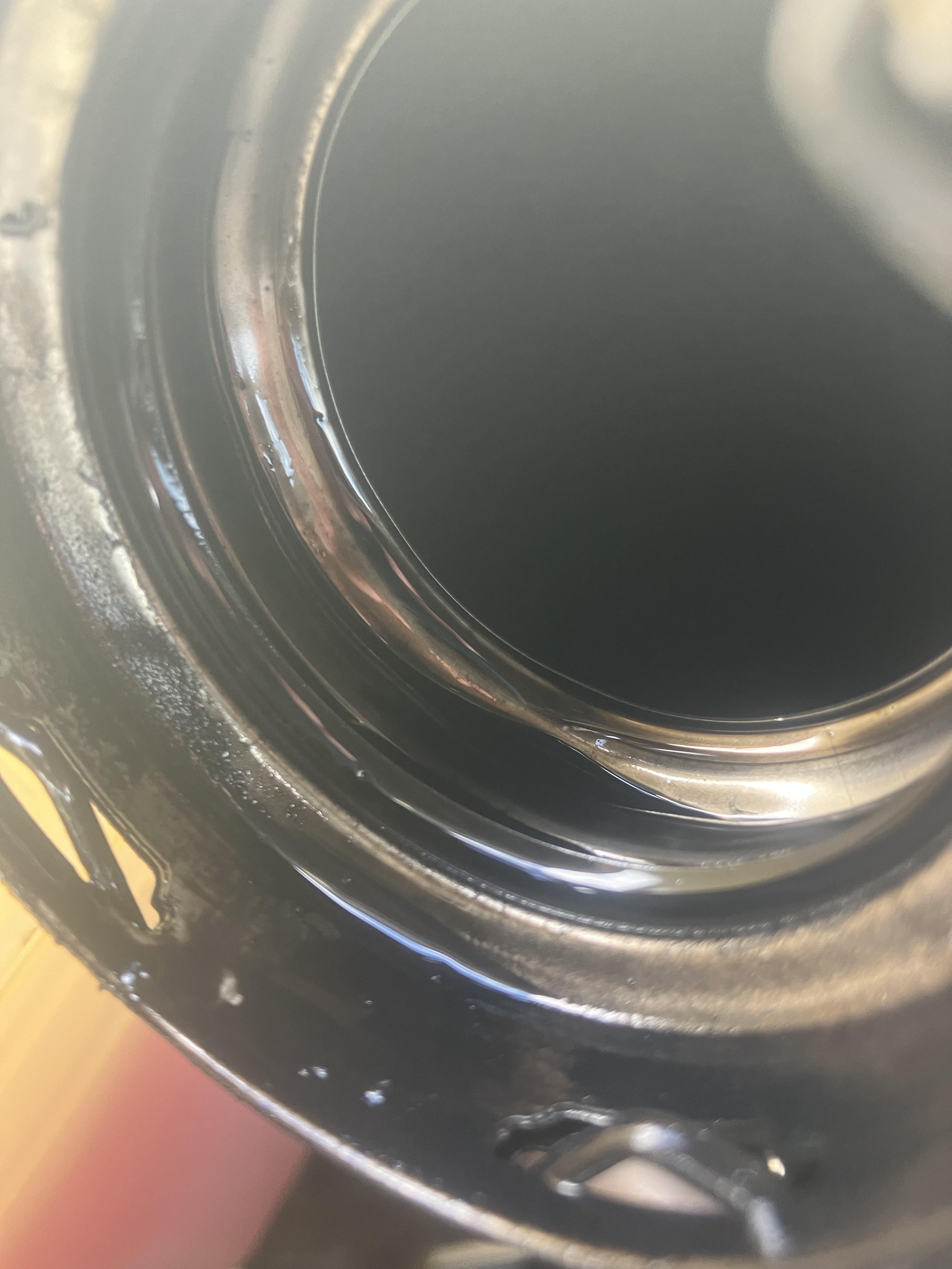

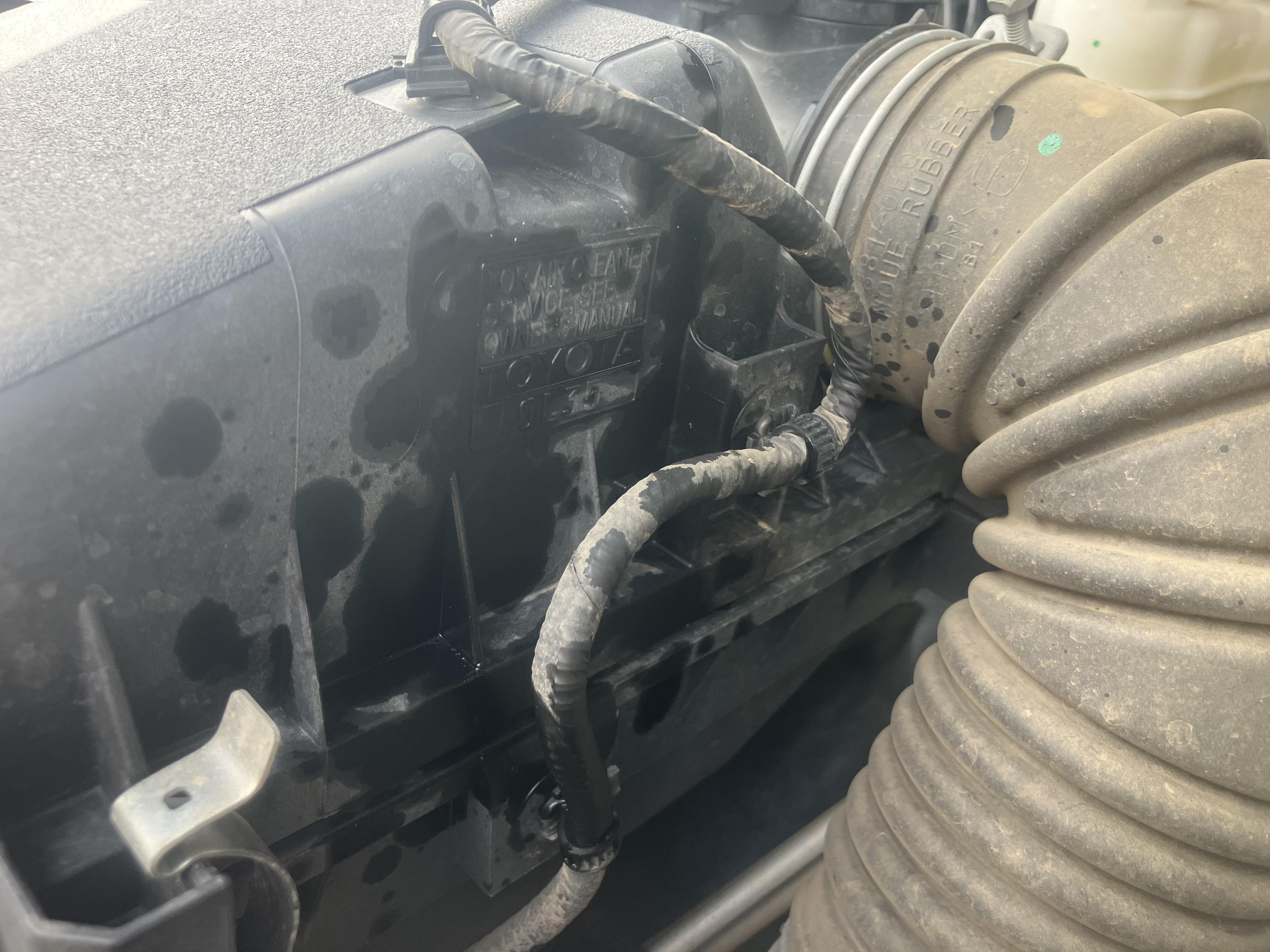

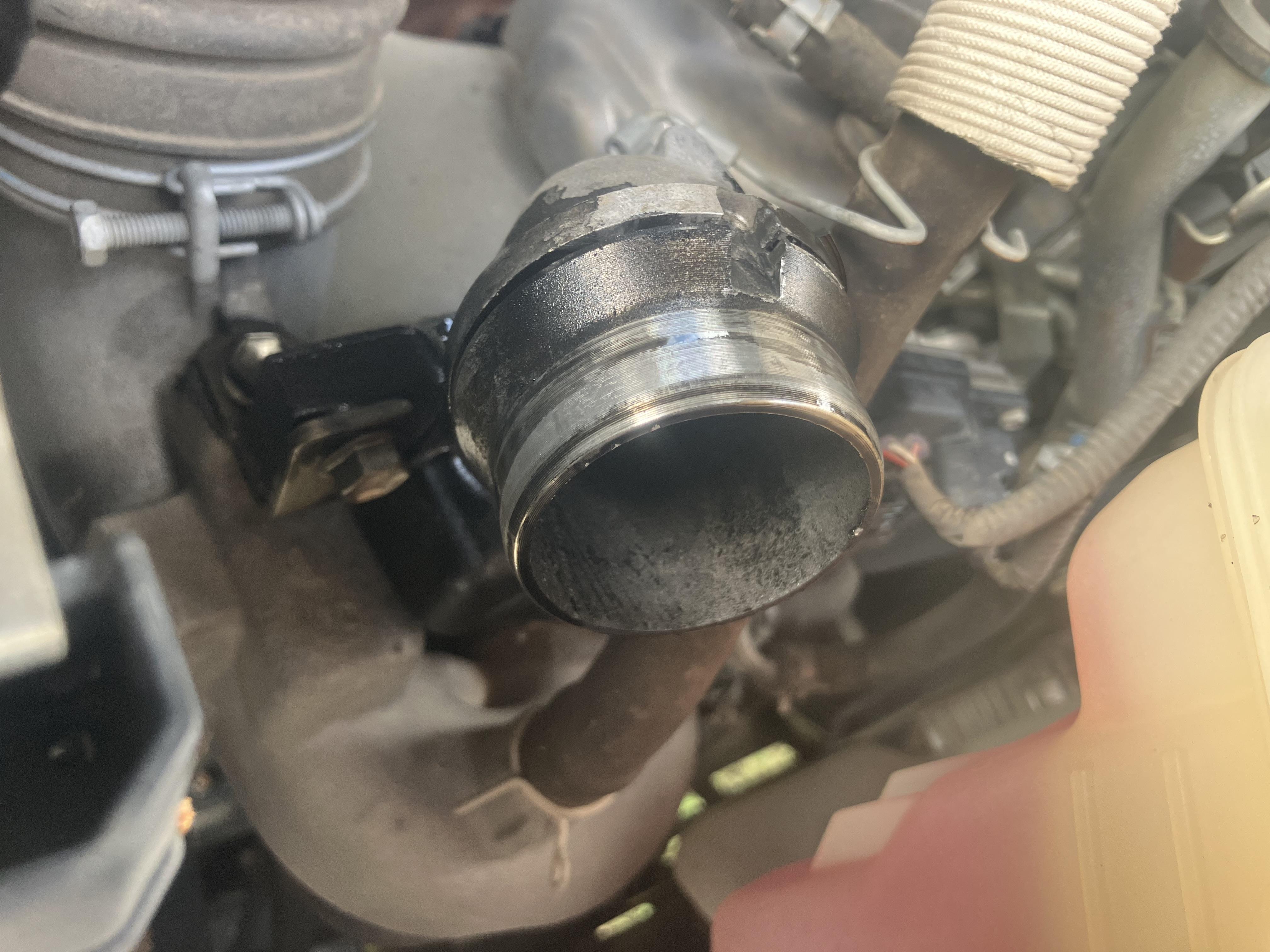

G'day all Newby here! Just looking for information in regards to 200 series turbos, I have bit of a oil leak on the usual left turbo. Considering vehicle is pushing 400 000klms, contemplating getting More done than just seals as it is such a job to get them out. I do not know squat about turbos and doesn't seem to be any reputable turbo specialist up in Darwin to rebuild/ balance them. My main question is can you just buy the cores already balanced and get them fitted by your local mech shop to your original turbos without needing to be balanced again? Any knowledge would be greatly appreciated. Cheers 08 vdj200r. -
