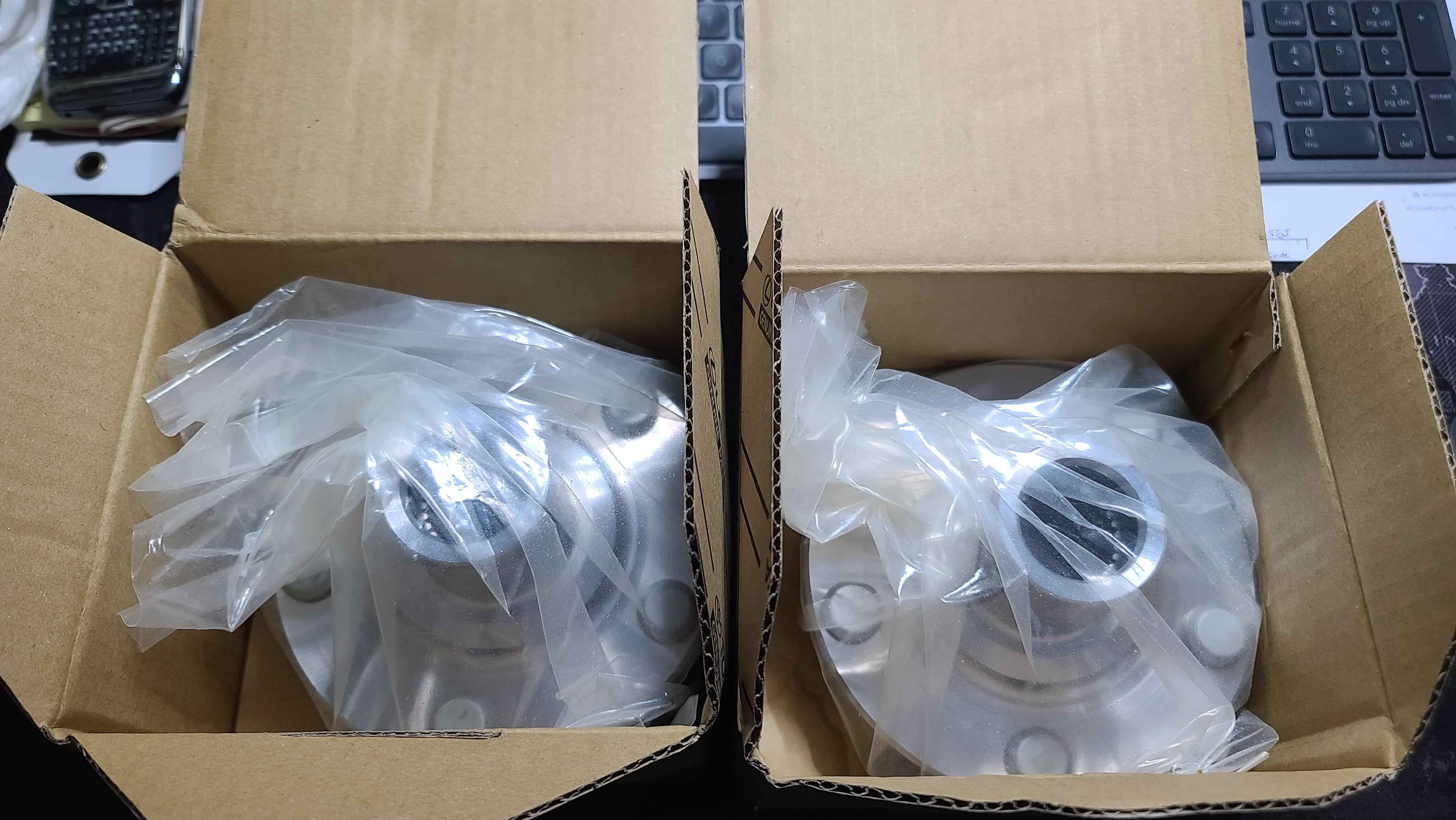

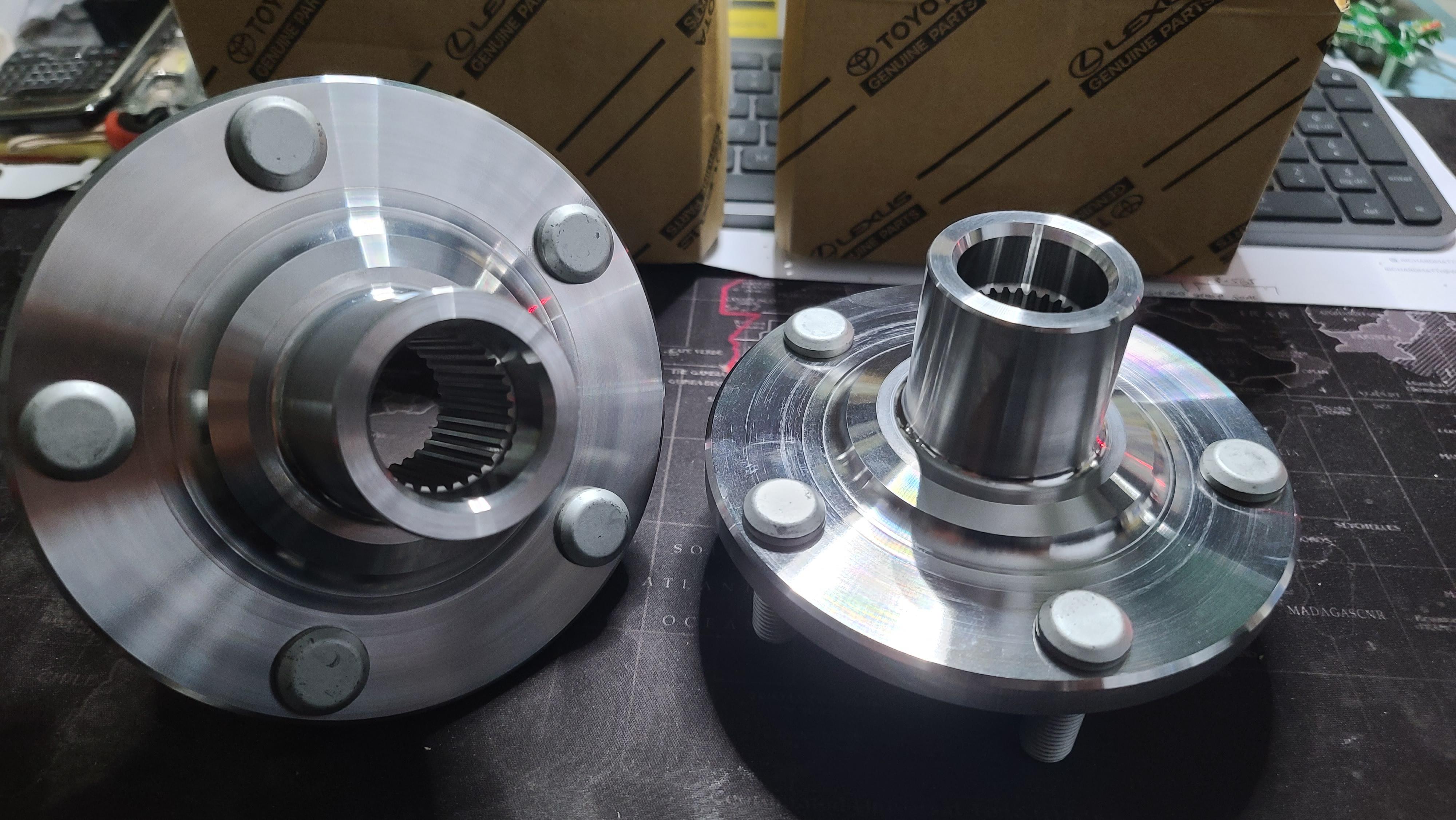

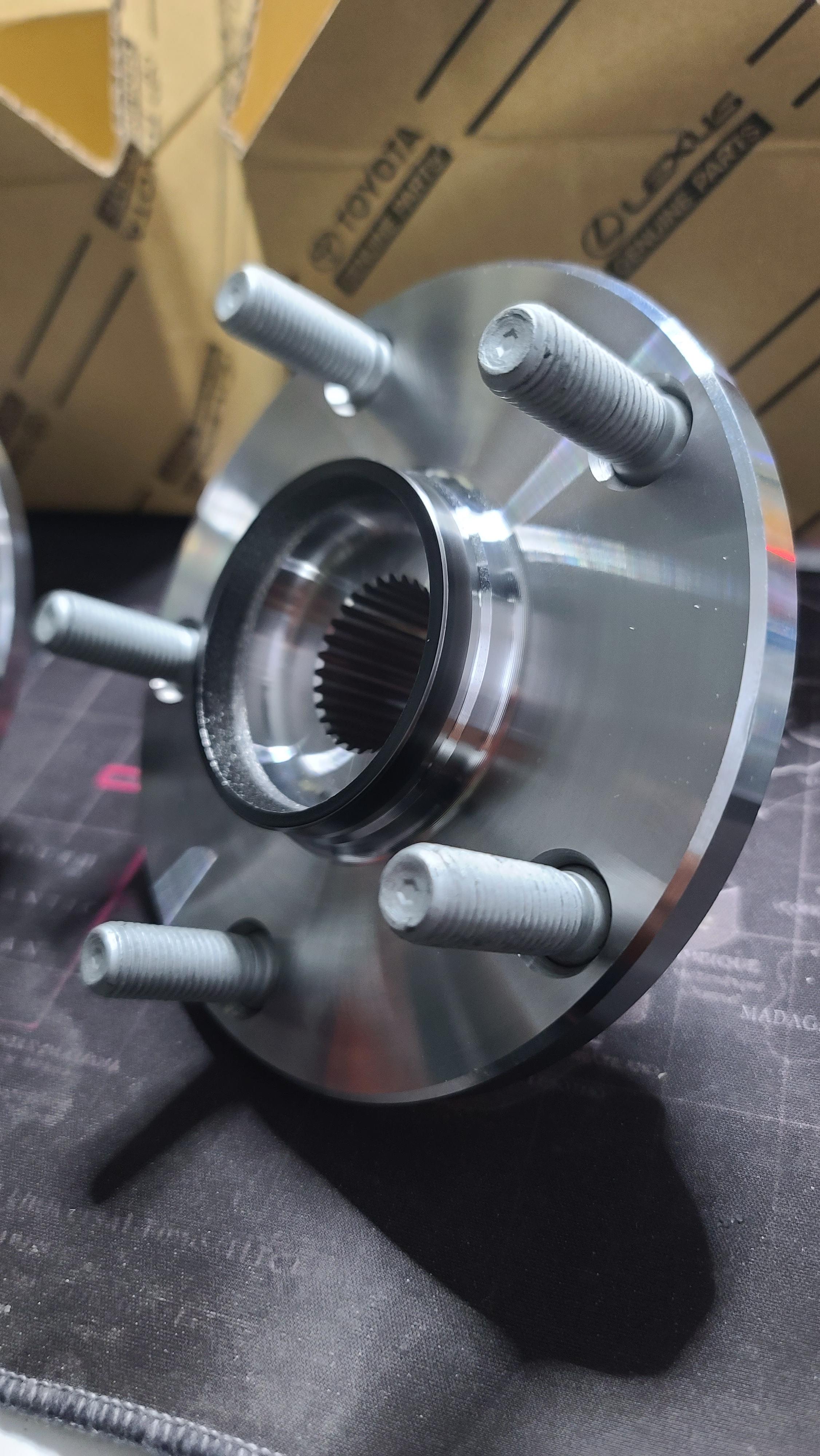

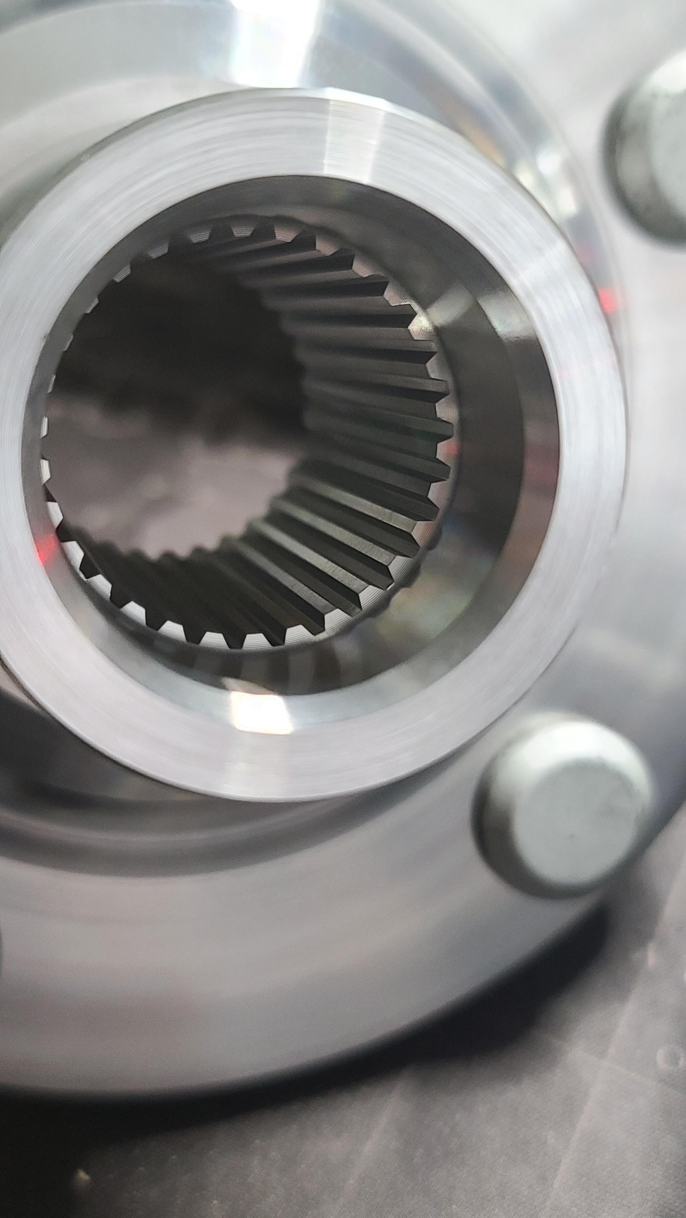

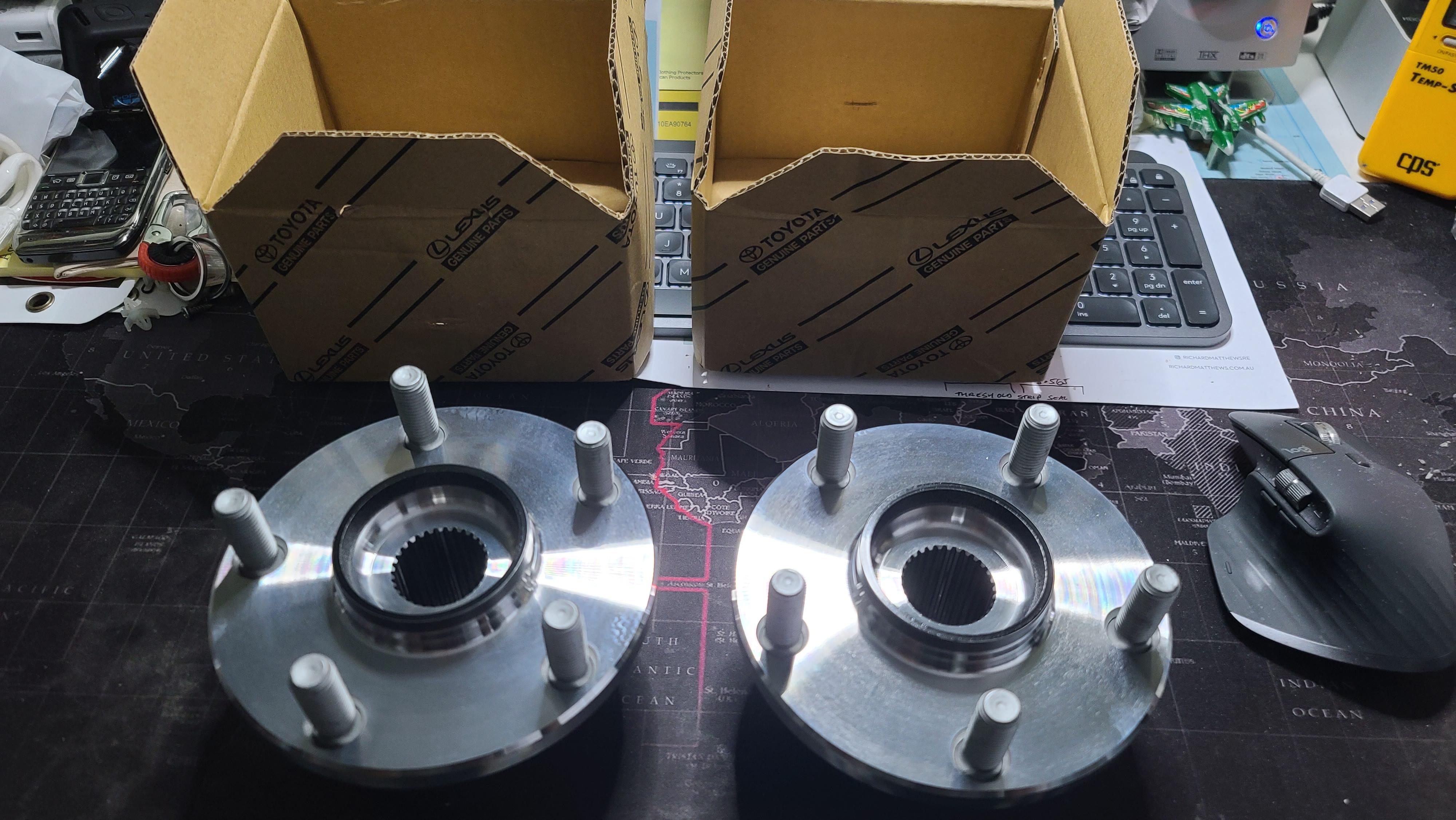

My New Hubs arrived today. Still waiting on my Amayama order to ship. Hopefully not too much longer..
