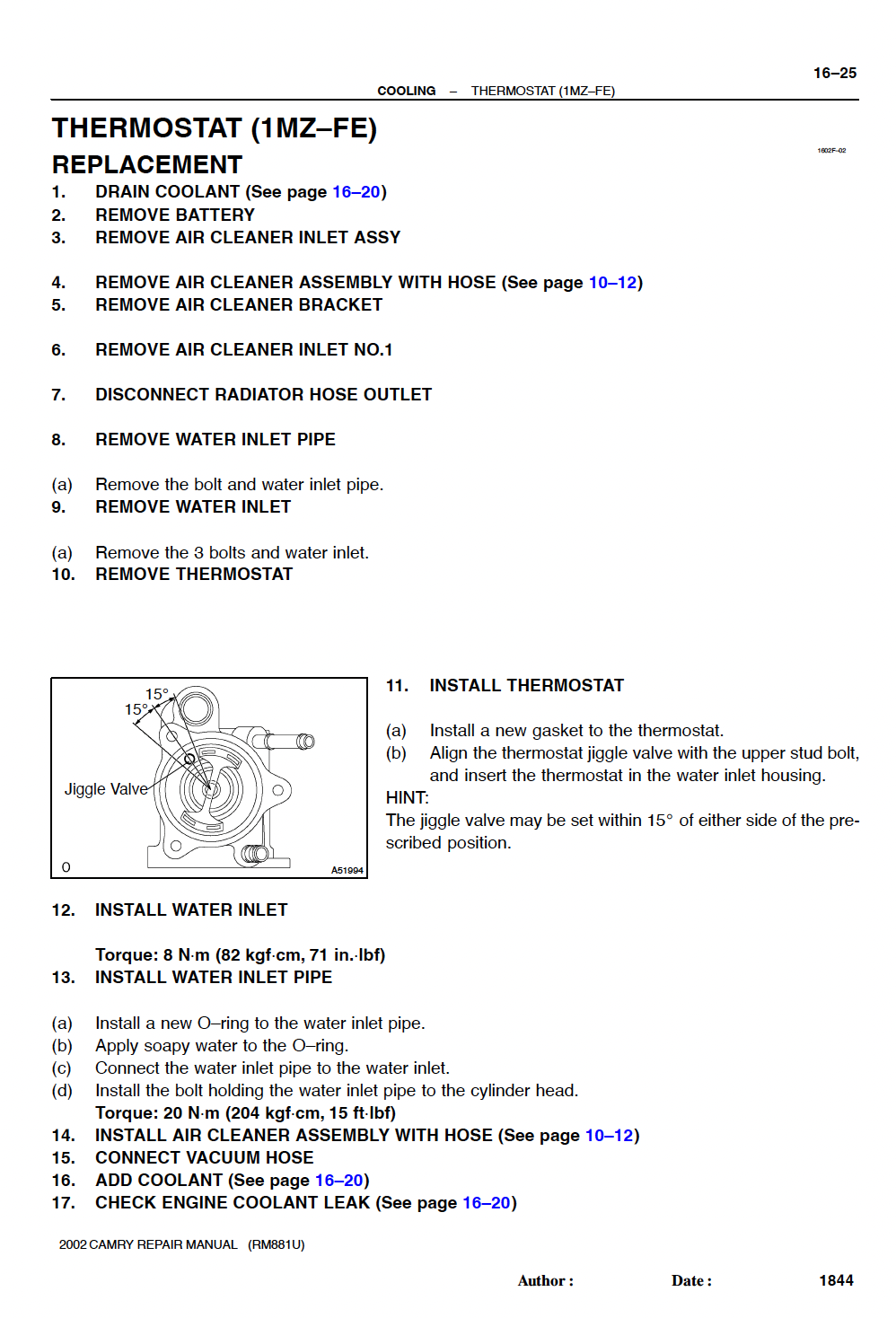

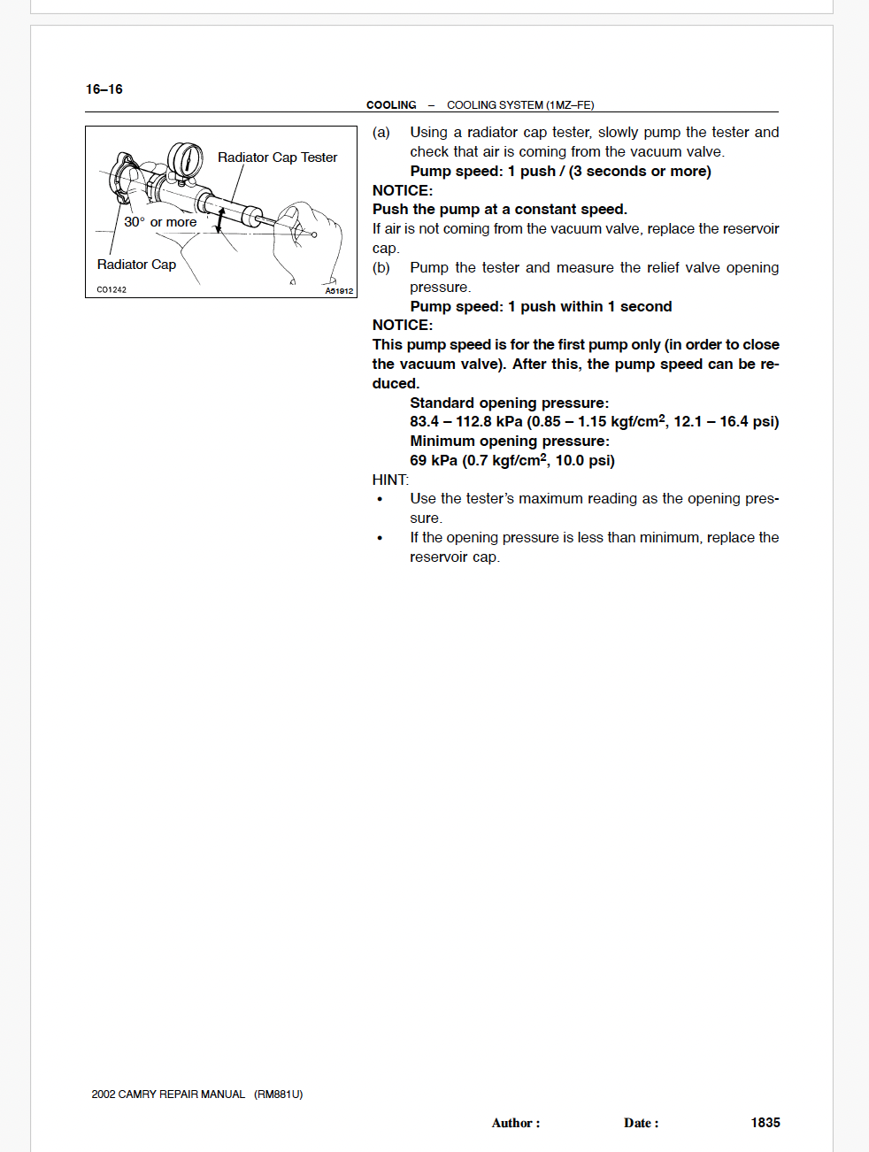

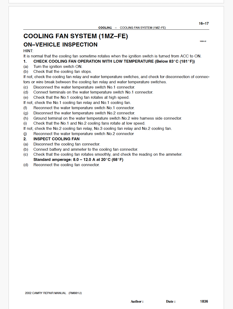

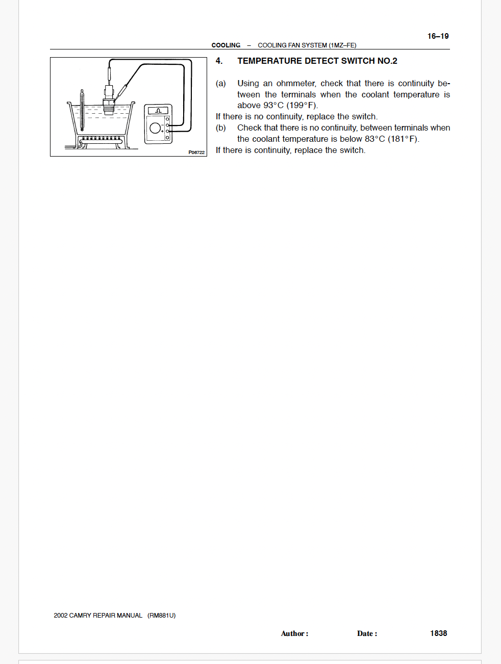

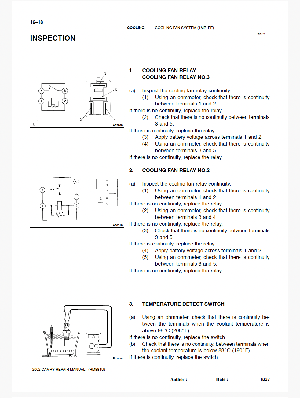

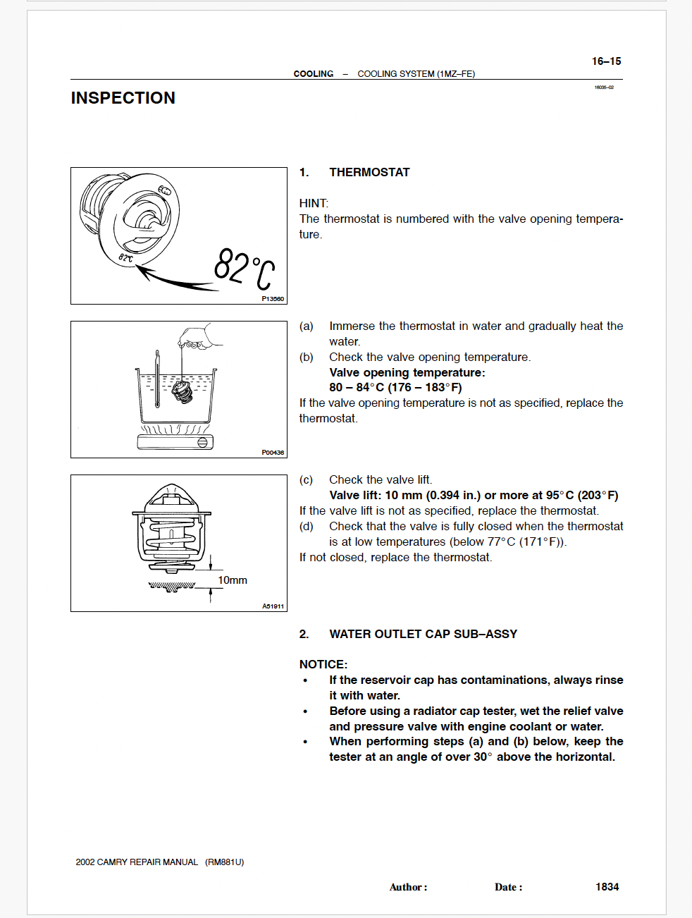

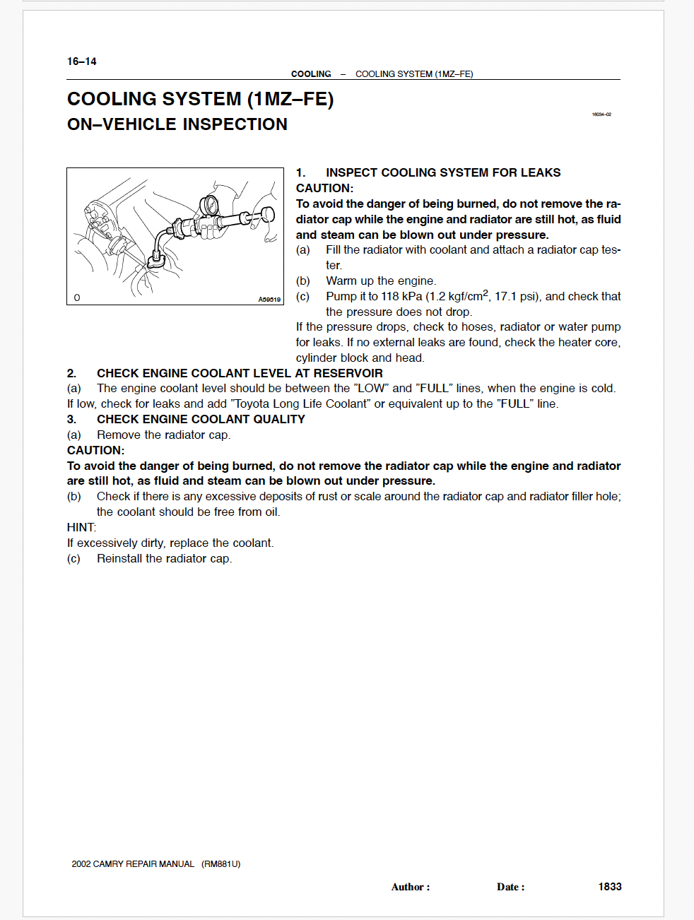

Hi there mate,
it could also be the thermostat or the temp sensor.
I've attatched a few pages from the repair manual I have I hope they help
Cheers Mike

Hi, thank you both for the advice!
@ESCO_AU thanks for that! I will check a couple of things on there that I hadn't thought of.

The radiator hoses also seem to actually open and have water flowing through so I am hoping it's not the thermostat.
I have pulled all 3 fan relays out and tested them all working, workmate of mine is an electronics engineer but was also pretty easy to hear when 12v applied that the relay clicked on. I have also tried just jumping the pins in the fuse box to turn the fan on and that worked.
I'm suspicious of the temperature detect switches, just to confirm is that the one that's at the bottom left (when facing the car head on) of the radiator? I've been trying to figure out where bits are from videos and things, but things seem to be slightly differently laid out on the previous gen camry that usually comes up when i look up "1mz-fe camry tempearture switch sensor" for example.
Did some more checking after work, another thing I noticed is when the AC switches the fans on, they only switch on in like a slow mode? When I first got the car/when everything was normal the fans would come on quite fast when the car was warmed up. I'm pretty certain at this point it's the temperature detect switch, I just can't reach the one at the bottom of the radiator. I CAN get to the second one on the thermostat housing, haven't pulled it out yet (that sounds like a weekend job).
