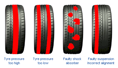

I think Toyota were drunk when they got that number. Try 34 PSI and see how it feels, then adjust accordingly. If you see your tyres are wearing in the middle, drop the pressure. And if they are wearing on the shoulders raise the pressure.

You have to be carefull when altering tyre pressures because if to low the tyre will wear unevenly on the outsides and when inflated to much they will wear only on the middle section of the tread, a base reccomendation is 32psi
