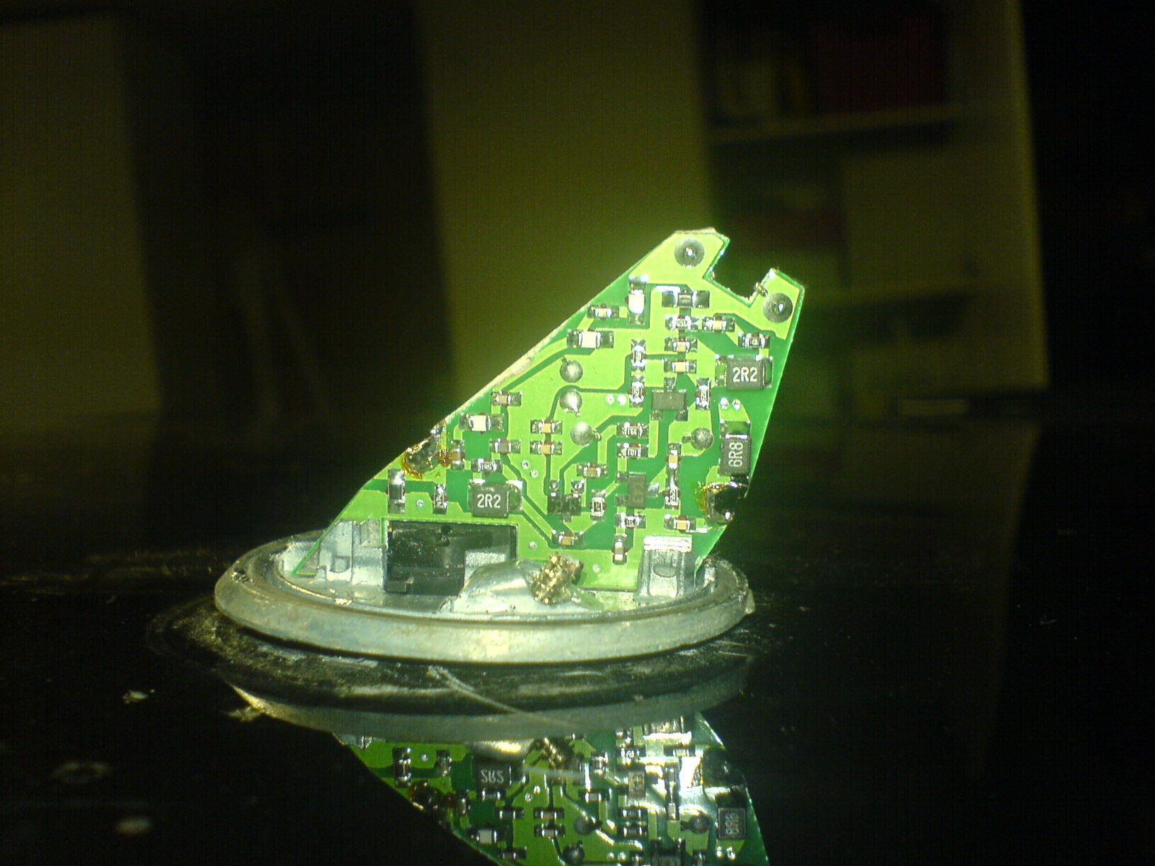

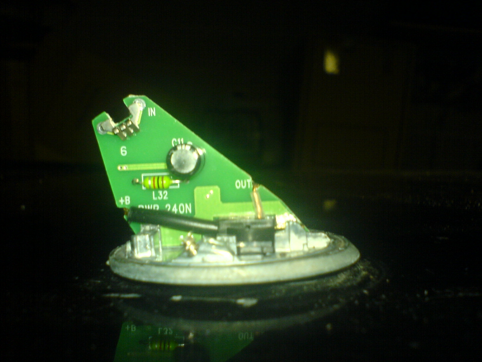

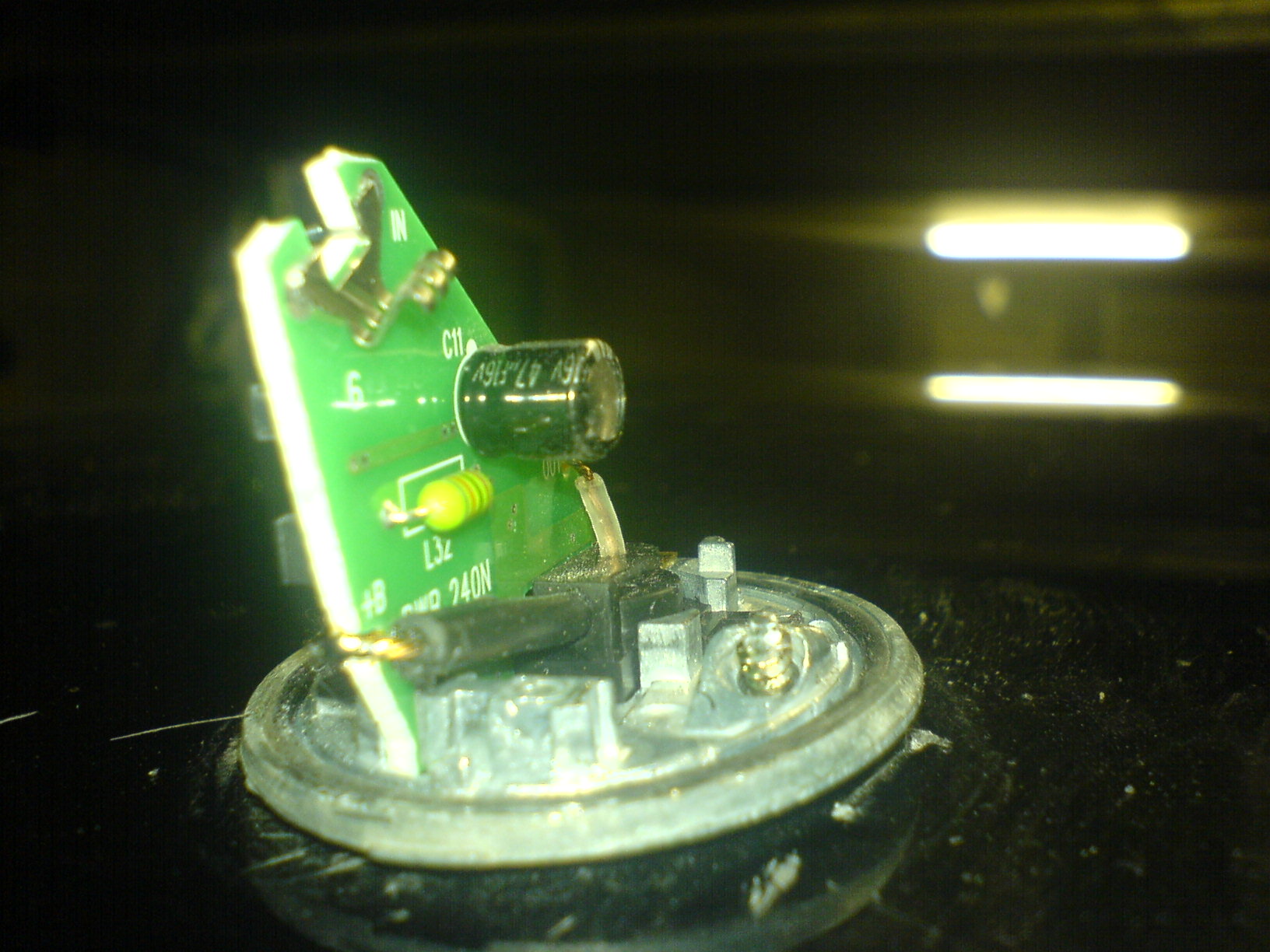

Eitherway, try to protect the circuit board asap. It's there as an amplifier/filter for the radio and it's clearly the reason the part's so expensive. While you're fixing it I'd love some hi-res scan/photos of it. I've got my amateur radio licence and what exactly they've put inside makes me curious every now and then.

well when it comes to getting that aerial fixed i know that when i pulled mine apart the chip was elevated on a metal base that was about 2cm off the car roof with a small metal pole in the middle going into the car which most likely has the wiring that goes into the car stereo
Now i have pics of it all pulled apart and the look of the shark fin after wards that a few guys want pics of but i dont know how to add to the net if one of u guys give me the means to get it on the net to post up i will attatch
hang on ill try and attach the pic at the add this attachment hehe :blink:post-1323-1152602578_thumb.jpg
yea i can attatch the pics ok im going to add all of the pics i took
ok next post more pics
i cant add any other attachments <_< <_< thats my limit so if anyone knows where i can post the rest i can show u all of the others there is about 6 or so more ones before the shark fin and after its on :)
