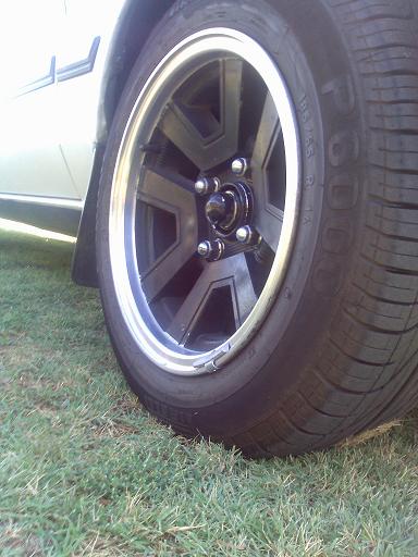

here a pic of mine....sprayed them the day i bought them as ma61s look best in black with polished lip. they are a bit worn now but im going to do a respray in the next few weeks. will use this guide for sure..... mad props my homie :P
edit.. look at that rim sitting out the tyre lmfao
