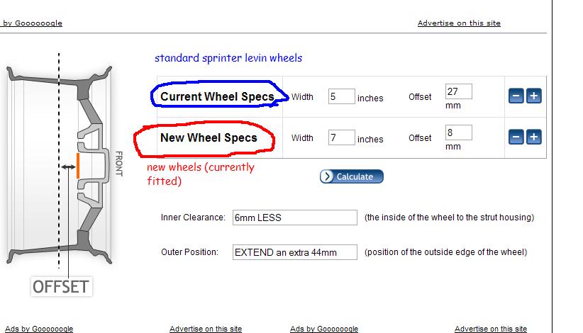

best way to make it faster... well best value upgrade on any car is a wider and lighter set of rims and some good tyres, will make your car A LOT faster. my ae86 handle terribal untill i did rims, tyres and springs. i got some second hand rims, 14x7 pos 8 and they fill the guards a lot better than the standard 13x5 pos 27s. better offset and wider rim improves track, lighter weight improves unspring weight. then tyres i put pirelli p6000s as my steer tyres and pirelli dragons as my rears (sometimes run falkens depending on what im doing tho) handeling improved so much, just by wheels and tyres, i could start accelerating earlier and harder as its better grip and it also helps confidence too knowing you have good tyres. when i did harder springs (was a cheap ghetto mod) it improved more. also added some neg camber at the front.... im not sure how it works with FF cars but you guys would get a bit of neg camber at the rear ?? i have no idea tho.
so yes best way to be faster is wheels tyres and some slightly better springs.

when looking at wheel and tyre choice goto THIS COOL LINK and it shows about how your offest will affeft your track.
