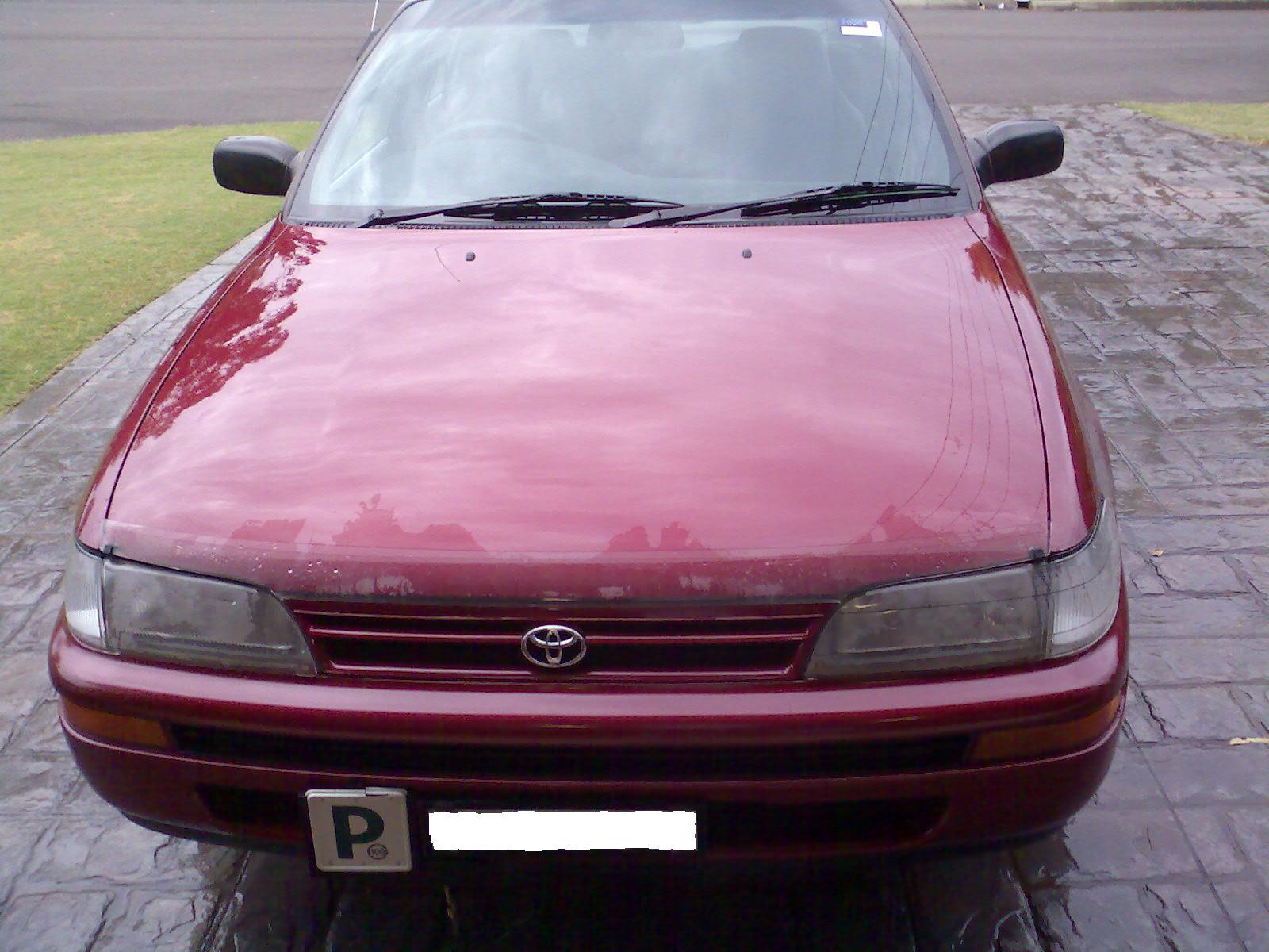

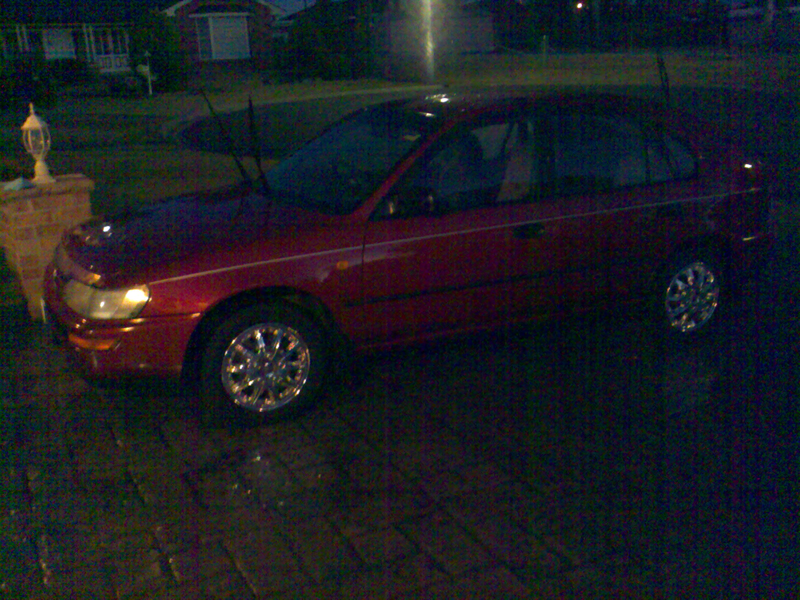

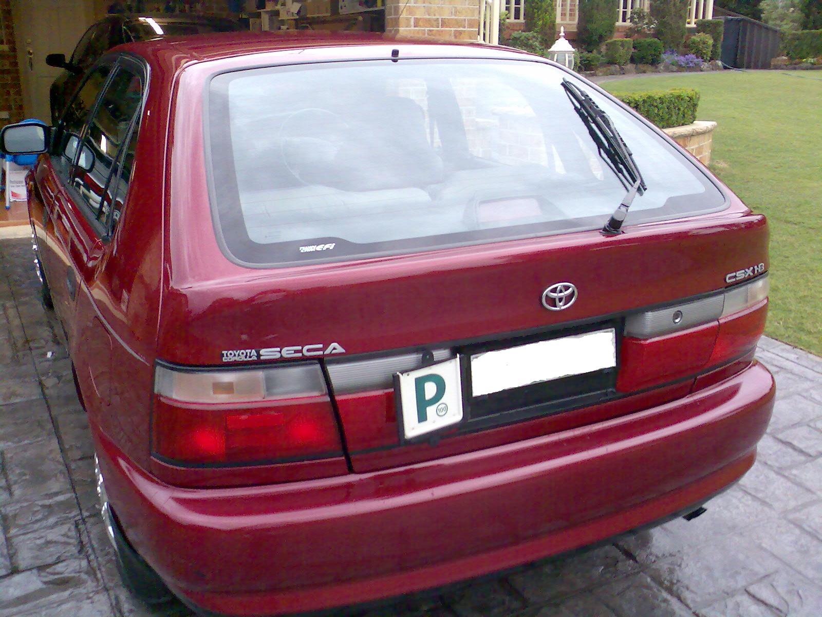

hey everyone....
im new to all this forum so yeah.... feel free to comment on my rolla fellaz:D
if u have any suggestions on what to modify that would be cool 2 :yahoo:
OH YEAH AND IF YOU'VE SEEN ME AROUND SYDNEY & WESTERN SYDNEY DON'T BE SHY TO SAY HI!!!

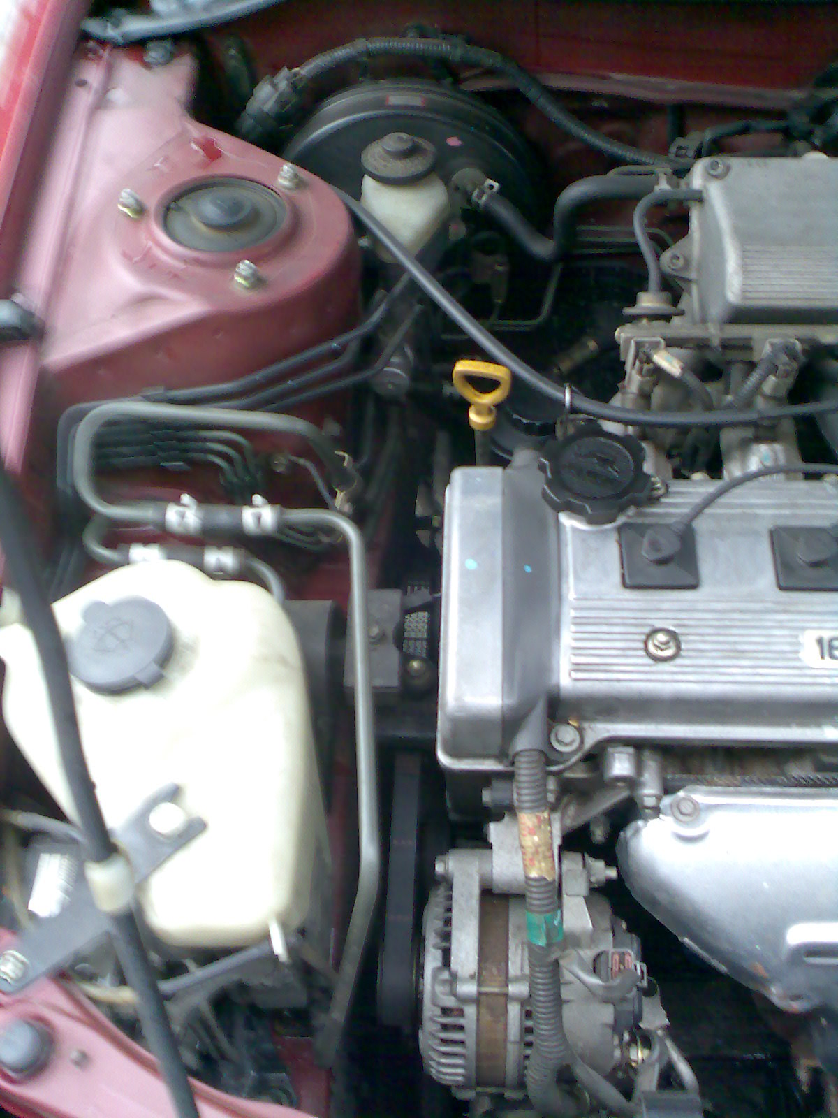

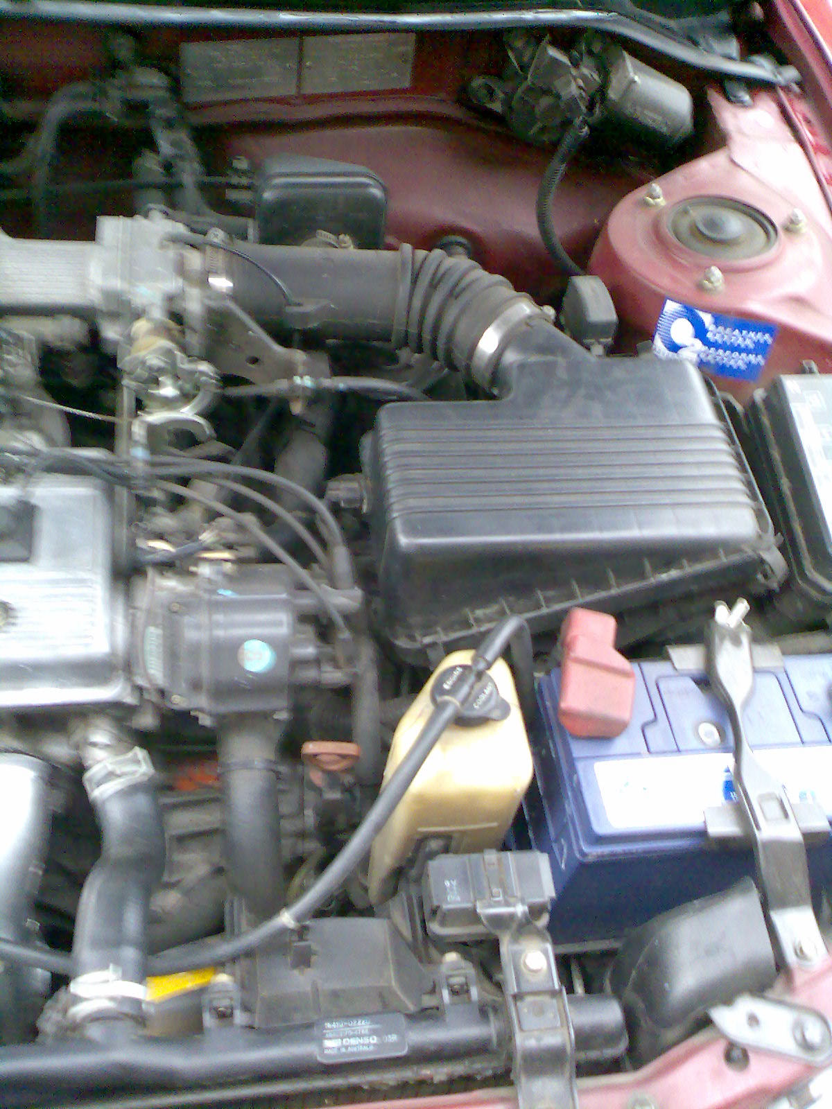

my car is a 1996 AE102X Corolla SECA CSX with a 1.8L 7AFE
everything on this car is completely stock!!! just well maintained and looked after :D
the only things i have changes to this car is the following:
*stock casette radio >>>>to a>>>>> sony cd player
*genuine manifold as the old one split on me (tried to get extractors but mechanics couldn't find one to suit my car)

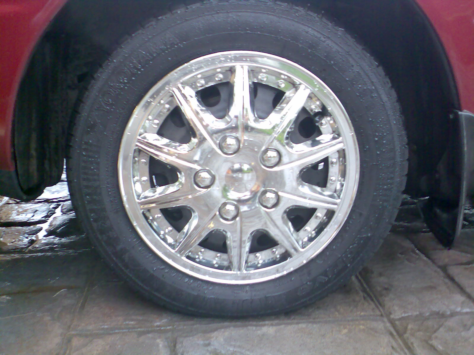

*hub caps ..lol gotta love them

but yeah im getting some rims shortly as the Yokohama 14" A drive wheels are getting a bit thin.
Like last week i was sliding all over the road in the wet. IT WAS FUNNNN, but not safe lol
