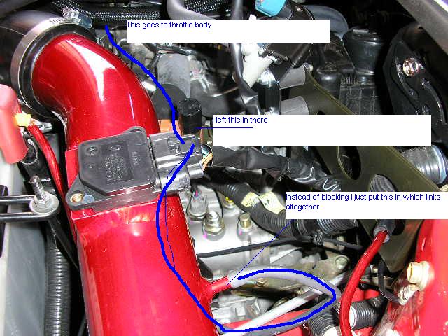

I just installed my TRD cold air intake w/ TRD filter (which i'll change to K&N soon)
Just want to ask a few simple questions.
When you start the car does your POD start making hissing noises even though its only idling?
Does the CAI affect your idling increasing and decreasing ?
When you first installed your CAI did it affect your throttle response in 1st gear (slower)?
I didn't use all the hoses and in terms of blocking the holes i used the old vacuum hose on the intake and also on the throttle body. Pic attached
Any help would be appreciated. I think everything is ok but just want to make sure as i've never installed one before.
Thanks.

CAI in my previous car yea to all fo the above
you need to block off that tube that you have plumbed back into the intake, all those symptoms appart from the slower throttle response are normal.
why block it off?
So block the one at throttle body and on the intake, that should be easy.
yep
