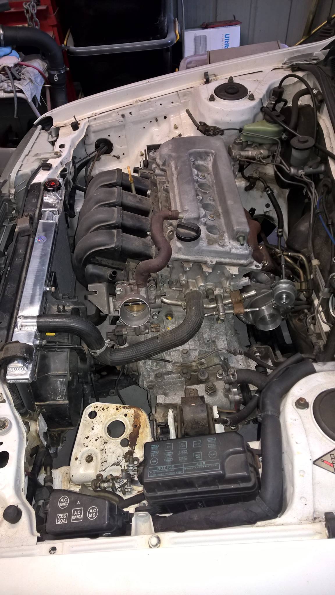

  13. The AE92 has an Ebay china ae92 alloy radiator which I moved the inlet and outlet on to suit the 1zz: http://www.ebay.com.au/itm/111698739459?_trksid=p2057872.m2749.l2649&ssPageName=STRK%3AMEBIDX%3AIT The ZZE is still using the factory Toyota radiator
  14. It's finished, currently a garage ornament
  15. The turbo ZZE is getting a couple of new stablemates... Have had a couple of AE92 Corolla's sitting in the backyard for the last few years, they're both now also getting turbo 1zz setups :)

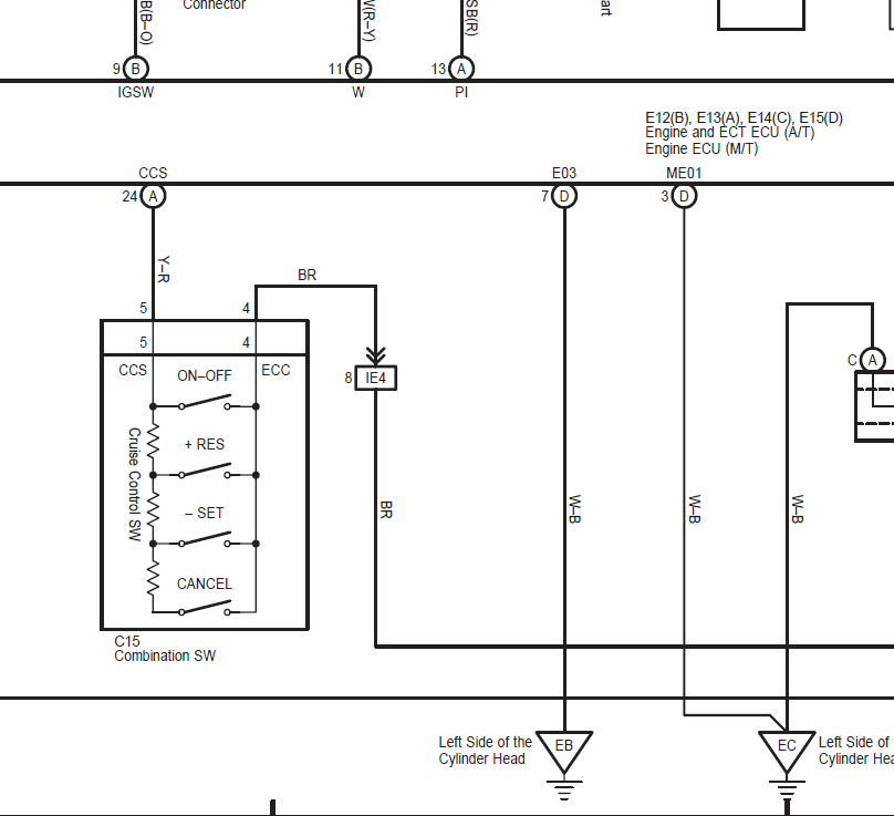

  17. That's the non-drive-by-wire diagram. Not applicable to your car. It uses the external cruise control actuator motor like a cable throttle ZZT231 celica

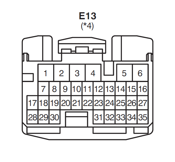

  18. you will need to run 2 new wires from the body-side of the clockspring. One to the ECU and another to the engine ground loom (Brown wires that ground in the lug that bolts to the end of the head near the radiator hose connection). I don't have a DBW 1zzfe diagram handy, but the 3zzfe is very similar and has a CCS pin in position 24 of the 35 pin ECU plug. If you're lucky the ECU will be cruise control enabled and it might work. You may also have to check if the cluster actually has a cruise light and that is wired to the ECU also.
  19. you need a different clockspring with the pins all populated. You can't share the horn trigger
