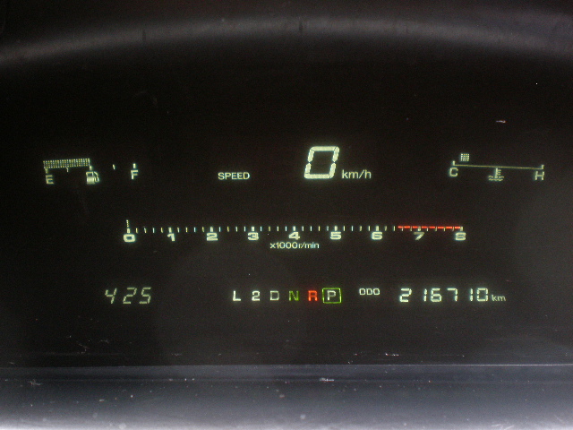

  14. Well Gents do you want to know what I think..... Of course the Aurion would be improved with a digital speedometer. I had a Toyota Soarer for the past 3 years and they are all digital (SEE PICTURE). I just bought the Aurion and thought it to be a little disappointing when pretty much all the other cars (bommadore and Bord) have the digital and to Aurion does not :( But im not really kicking up a stink cause it doesnt bother me that much. I was just used to the digital readout. Although its does come in handy if you want to keep the speed on a precise level for those police and cameras. Dont worry about DJKOR, I tihnk he is having his period :) KoolMoeDee (KMD)
