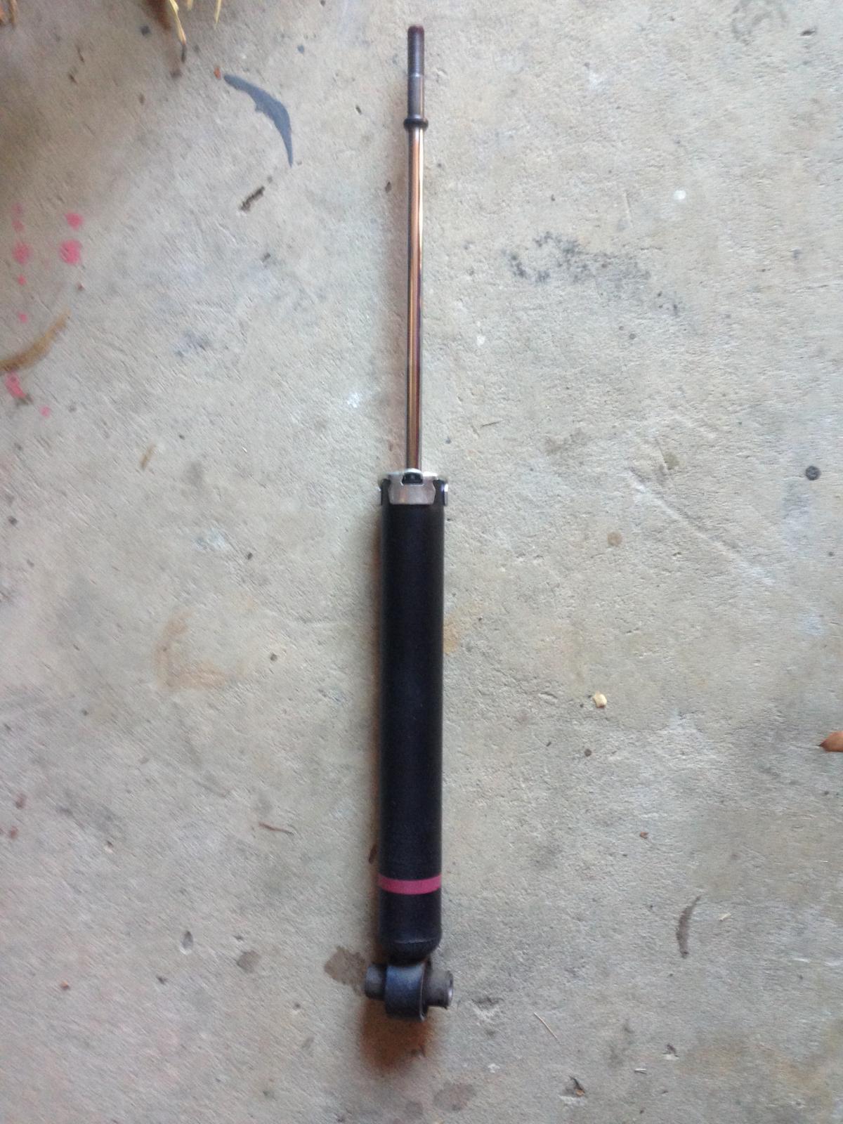

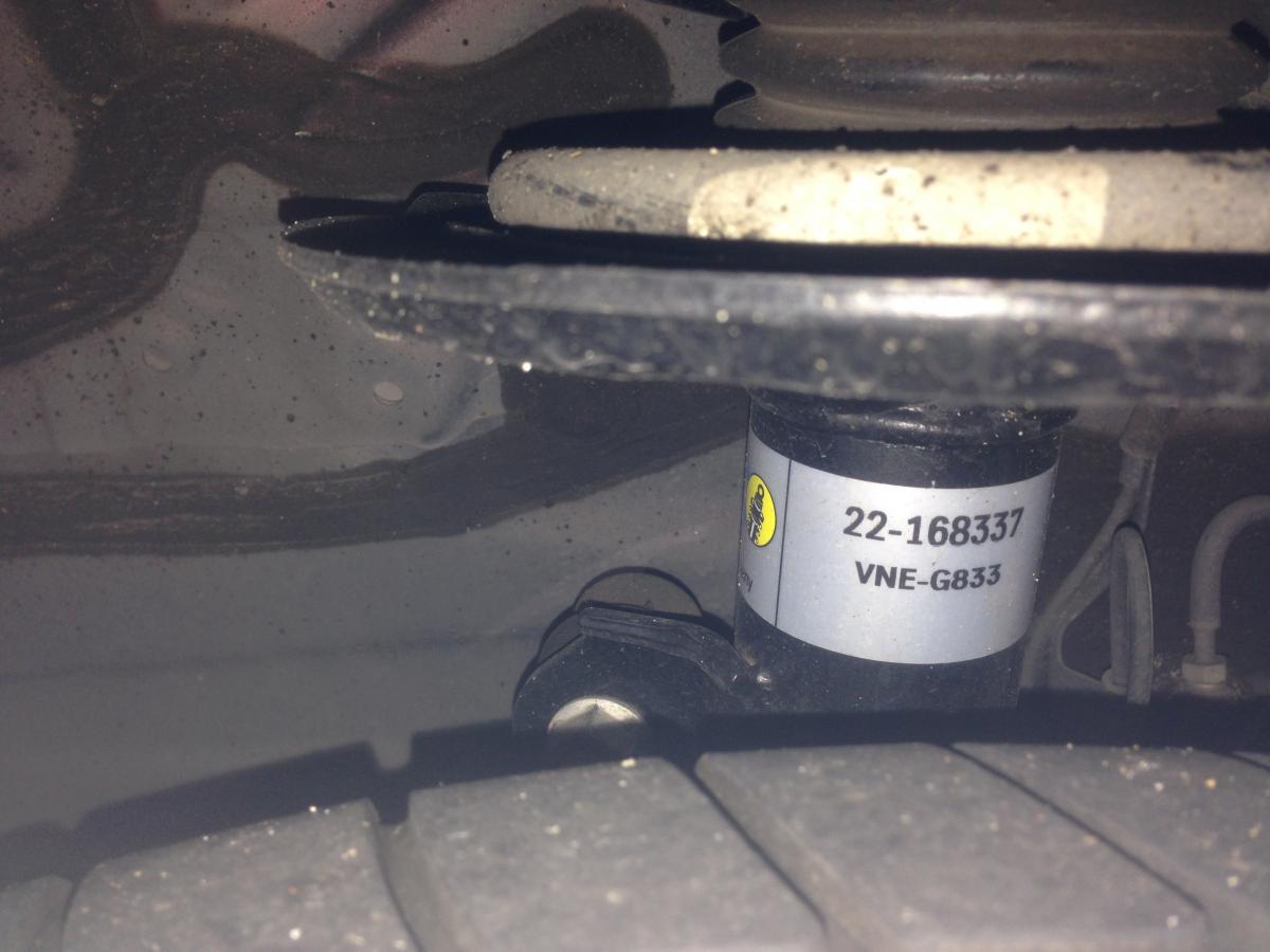

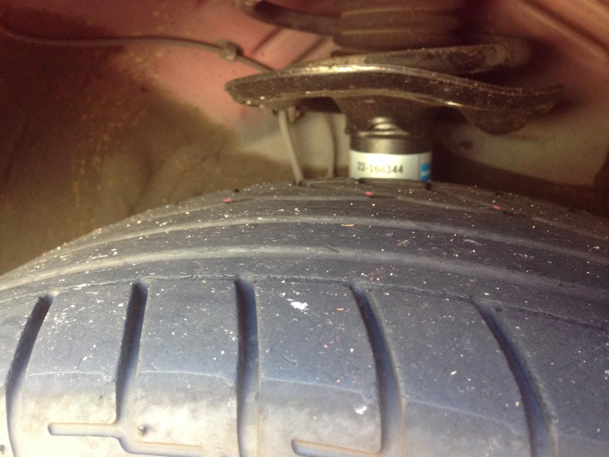

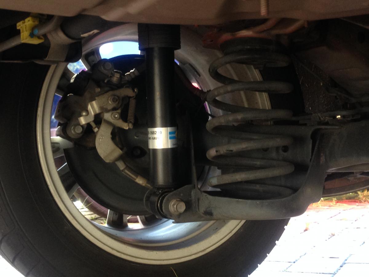

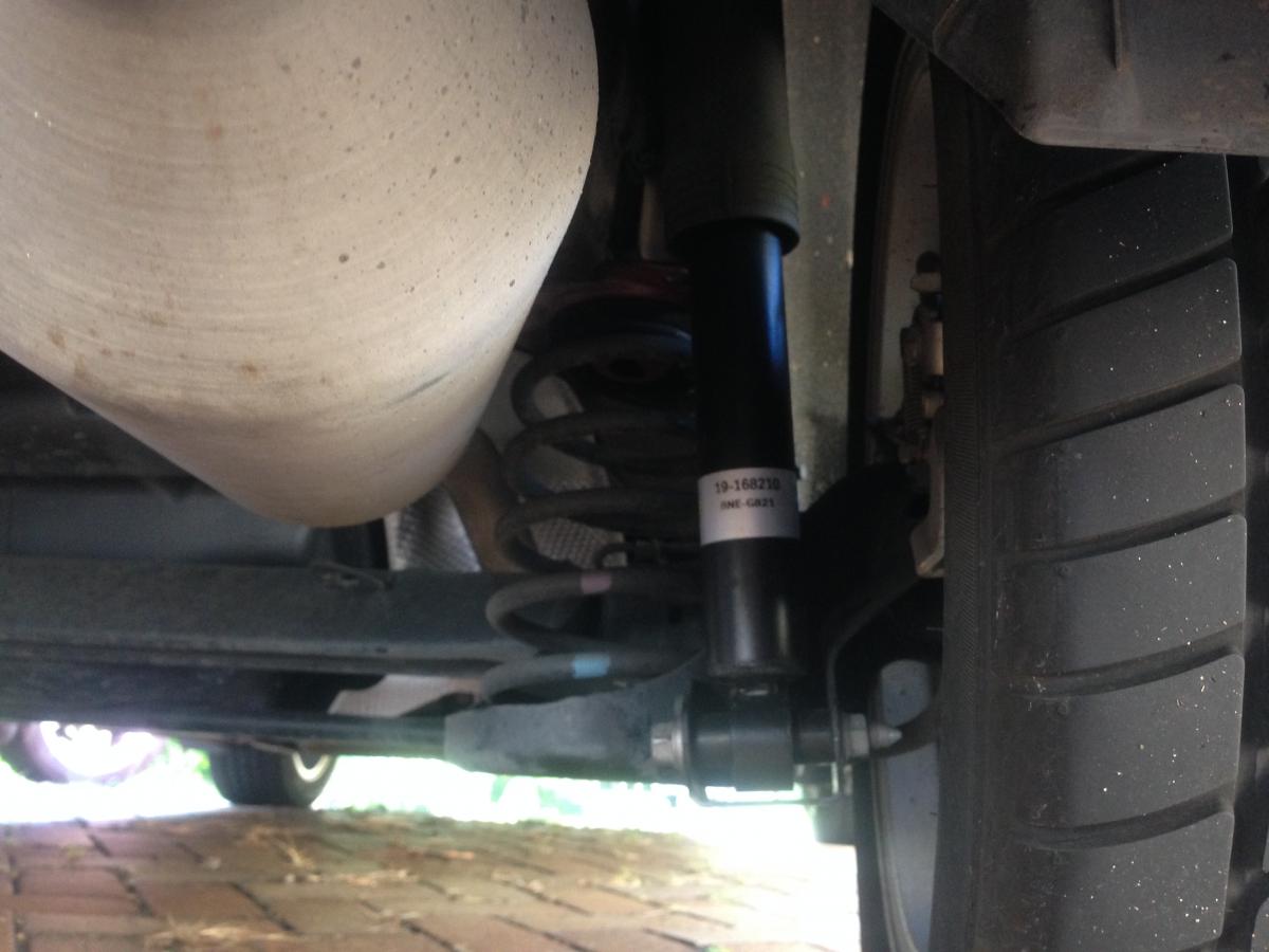

Hey all, Just wanted to share some info re Bilstein shocks and the ZRE152 Corolla Hatch Ive just replaced my standard front struts and rear shocks with Bilstein B4 struts and shocks. I found the standard shocks, especially the front too soft both in compression and rebound damping. The Bilsteins are way better. Hard to quantify but a vast improvement. Having used KYB & Koni before i thought I would like to go for Koni but found the Bilsteins at a very good price from an online shop in Germany. www.rexbo.eu I checked the Bilstein website http://www.bilstein.de/en-uk/products/search-service/online-catalogue/ (listed as Toyota Auris) and the part numbers are : Front Left 22-168337 Quantity: 1 (79.80 Euro) Front Right 22-168344 Quantity: 1 (79.80 Euro) Rear 19-168210 Quantity: 2 (55 x 2 = 110 Euro) Shipping to Australia 65 Euro Converted to Aussie dollars and shipping came to a total of $514.11. Shipping took about 2 weeks. I was quoted $622 for fronts only from an Australian retailer. I would recommend these over any other brand and they fit perfectly. The hardest part with fitting the fronts is removing the front wiper motor and support panel. The rears require you to unbolt the plastic tray around the spare wheel. The fronts took about 4 hours total doing it by myself, the rears about 3 hours. There is a step by step guide to the fronts on Toyota Nation here : http://www.toyotanation.com/forum/324-10th-gen-corolla-2nd-gen-matrix-suspension-brakes-wheel-forum/371094-how-replace-front-strut-coil-spring.html Thanks
