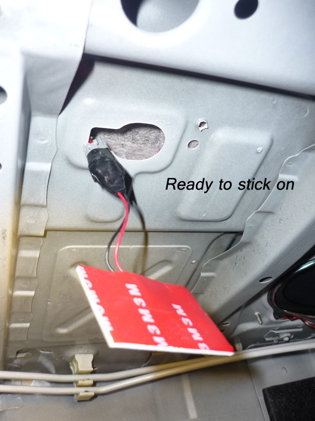

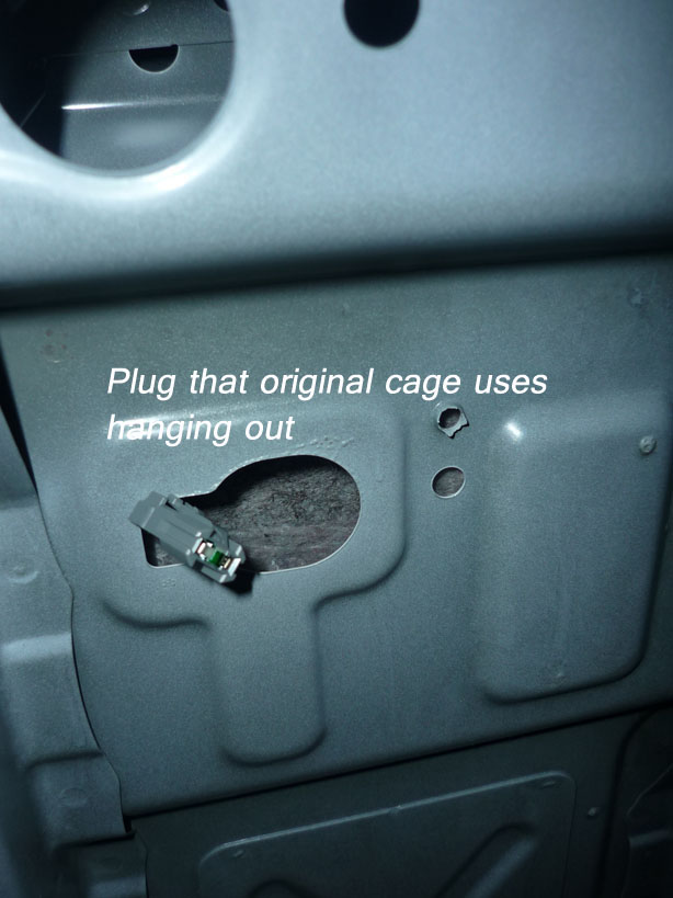

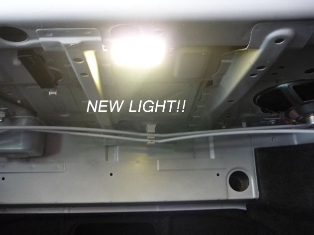

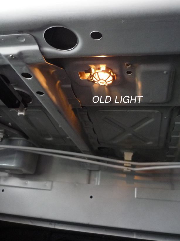

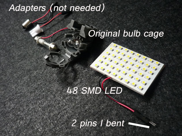

Installed a $3.00 boot light upgrade and it only took 5 minutes to install. It's a 48 SMD LED, I got the warm white (it's not that warm) just coz I didn't want super white. Got it here: http://www.ebay.com.au/itm/150675727866?ssPageName=STRK:MEWNX:IT&_trksid=p3984.m1439.l2649 Can also search eBay for 'T10 dome light'. The light I got seems to be about 3 to 4 times brighter than original and the install is completely reversible. Step 1: Removed the original T10 bulb cage, open the cage to access the bulb then there are two clips to press together either side of the bulb. The whole cage will then come out. Step 2: Unclip the plug at the back of the cage. I found the wire very short but just enough to deal with. Step 3: Clean the area well around the hole where the cage came out of, I used an alcohol wipe. This is where double sided tape will hold the new light on. Step 4: LEDs are polarity sensitive, if you plug it in and it does not work then reverse the direction you plugged it in. The 48 SMD came with 3 adapters but to make a clean install I just bent the adapter joining plug into a V shape and then gently used pliers to bend to tips of the V strait again. Bending the wire in this way made it easy to insert the wires directly into the plug that the original cage plugged into. Use electrical tape to secure the plug and wires together. Step 5: Tuck the clip and wire back in and stick the new 48 SMD light into position over the cage hole. Your done! I found the double sided tape to be very strong, if I ever remove the SMD light I expect to be scraping off remains.
