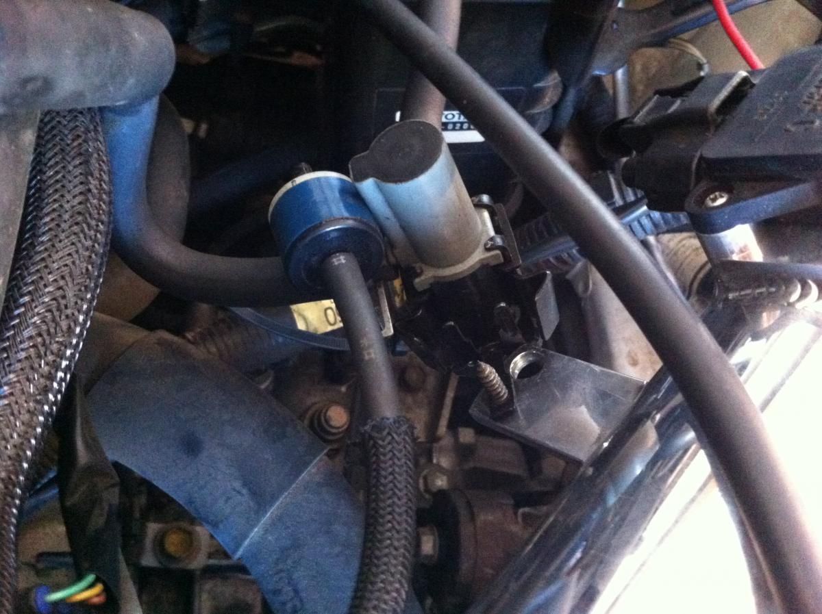

Quick update, finally got it plugged with a rubber cap. Turns out the hose was the issue all along. Big thanks to prozak and superdave for the input. No longer switching off when in neutral. Will do a ECU reset on the weekend as it seems to be driving okay for the moment.
I checked that blue cylindrical bit, and its already been blocked off. As for the actual CAI where the hose connects to it, im going to block it off with a 15mm grommet, is that the right plugging tool to use? Long as its blocked off bud ! Let us know how you go No worries. One more thing, once its blocked, should i reset ECU? or is there no need?
Will do. Ill head to super cheap on Thursday to sort it out. Just a quick question, what is the blue cyclindrical thing and where is the plenum? And to Prozak, apologies, i thought everything was blocked off until i got feed back from everyone.
what did you use to block it off?
How did you block it off?

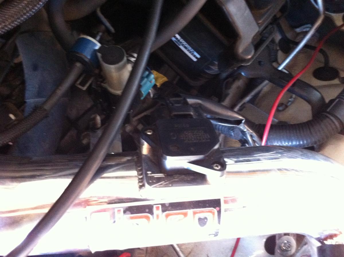

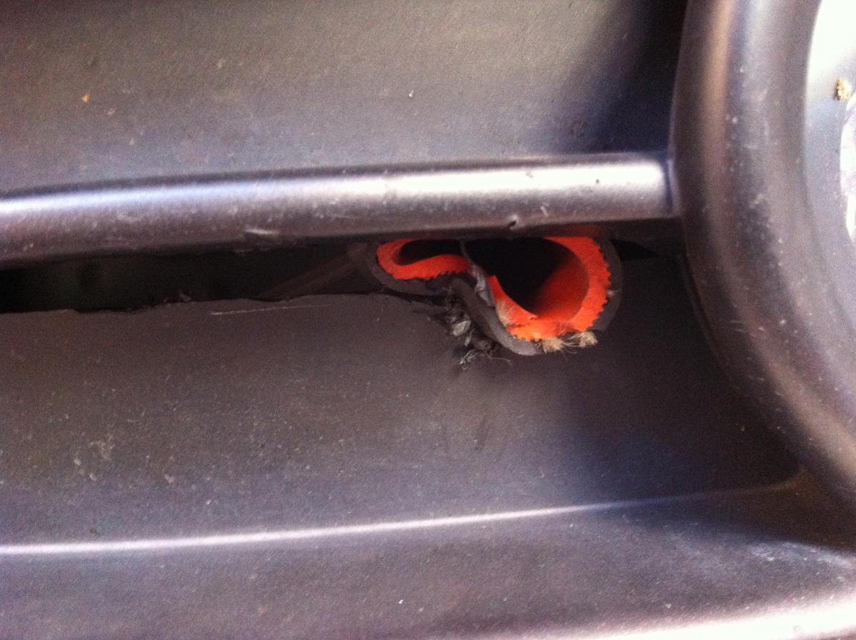

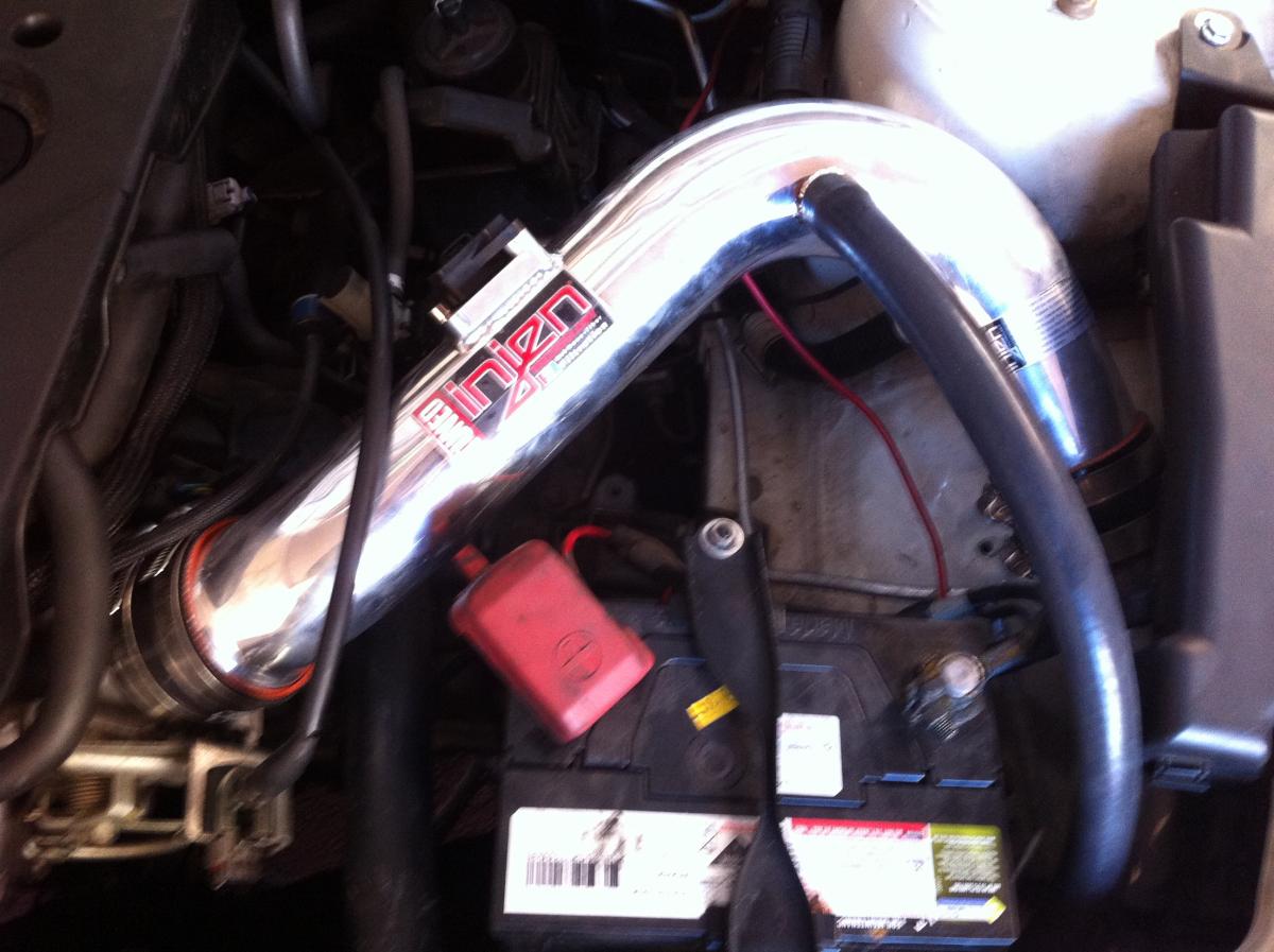

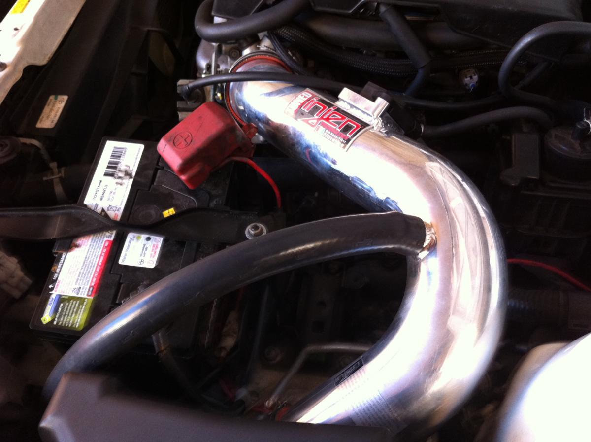

Dead o2 sensor? Does the exhaust smell really fuelly, or does your oil? Need to be careful of overfueling as too much fuel can wash the thin film of oil off of the bores. Which CAI did you install? If the airflow to the MAFS isn't good it can read wrong and give all sorts of issues such as overfueling. i installed the Injen CAI. I got a mechaninc that has previously installed one on a sportivo before hand. Ill take some photos and post them to see if anythings missing. The exhaust does smell slightly richer on some start ups. Mechanic also ran a hose attached from the CAI down to the fins of the front bar which its sitting between, apparently he says it was so that hot air can escape whilst the pod sucks in cold air. Ill post a pic up of it tomorrow. So here are the pictures, hopefully they come up:
