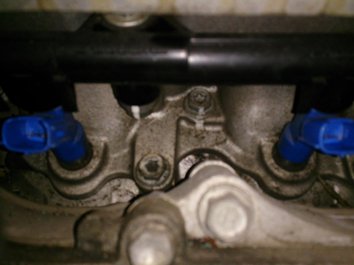

  5. i dont seem to see ANY sort of sensors after the supercharger.... still doing my head in trying to remove the superchager

  9. Has anyone removed the Supercharger off the TRD Aurion before? ive been stumped for the last few days and looks to be a NIGHTMARE of a job or just need some really customised tools so ive been trying to remove the Fuel Rail.. looks to be a bolt on top and a nut on the bottom... cant seem to get a wrench or anything on the bottom nut as for unbolting the plenum there is one bolt that i can only fit a socket onto its right in there and i cant seem to get anything to turn it (pic attached - supercharger bulges out over the fuel rail) any ideas? Why you ask? im planning to install a MAP sensor, Air Temp Sensor and possibly a Water to Air intercooler

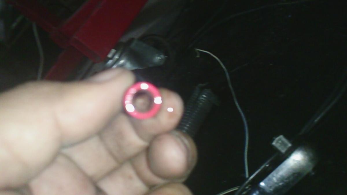

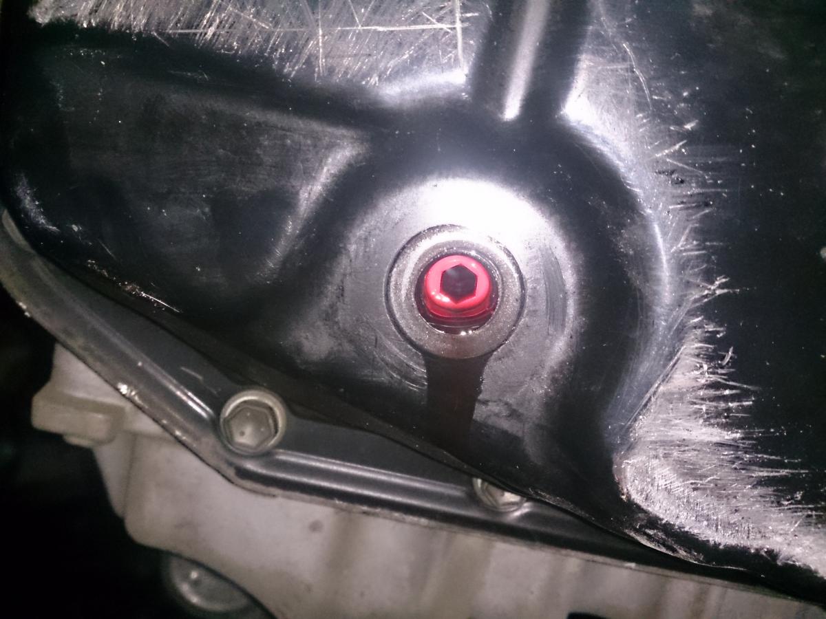

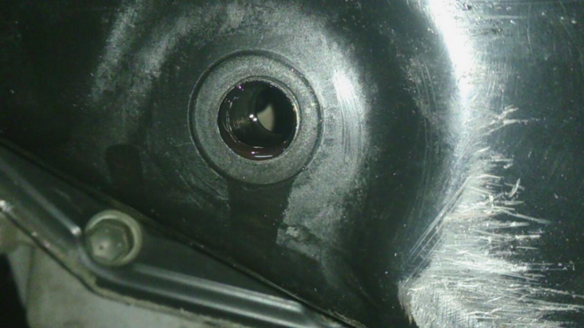

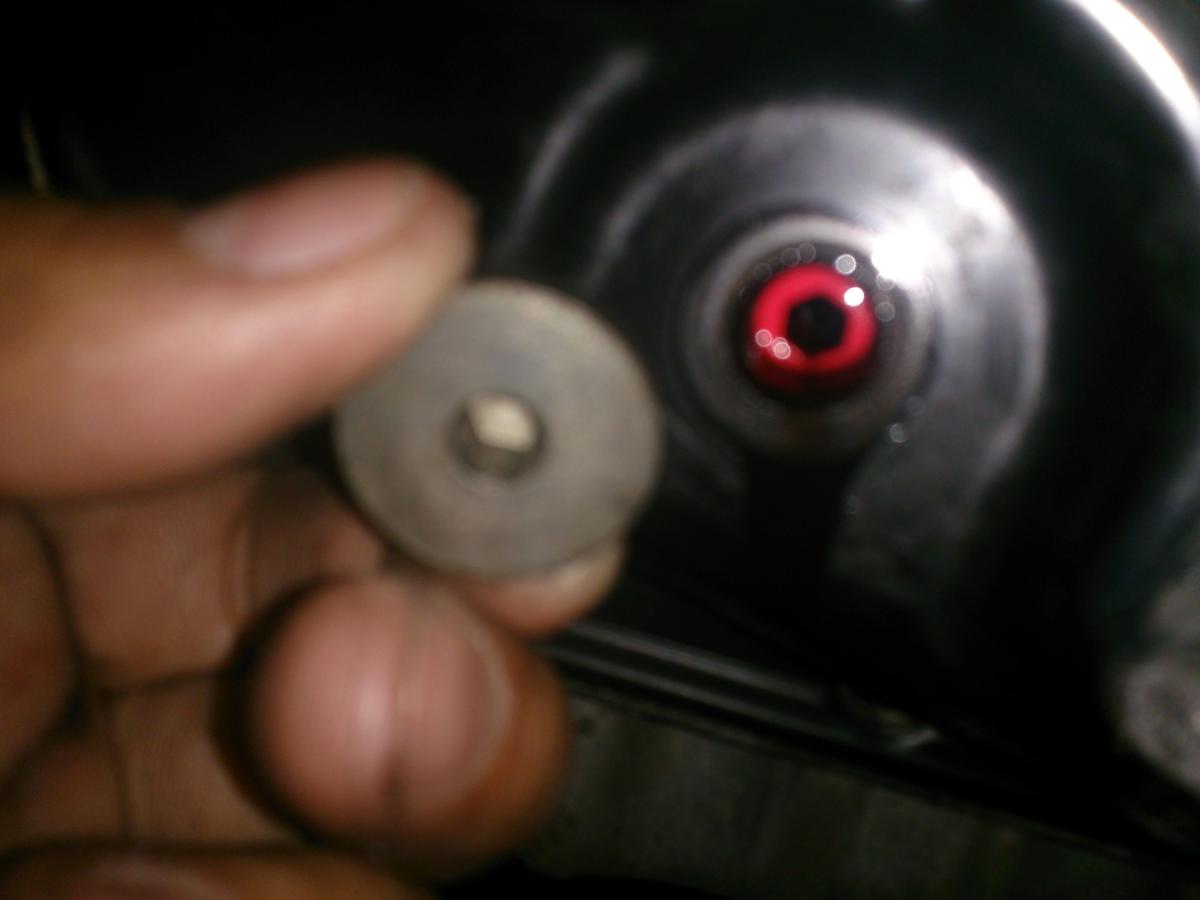

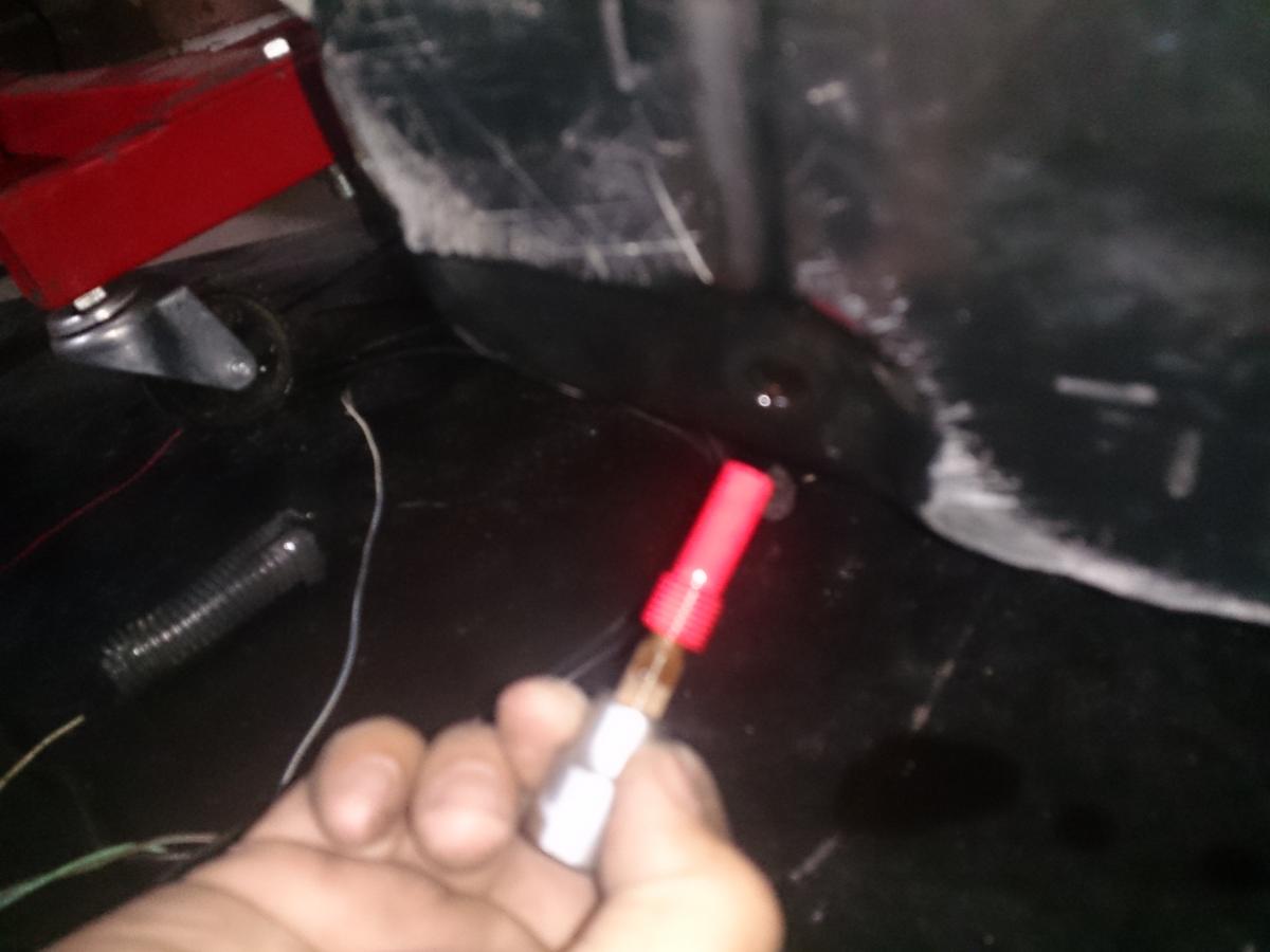

  10. i have a Aurion gearbox sitting in my garage... i was told by my mechanic but dont hold me to this: To Drain: remove drain plug (some fluid will come out) inside drain plug should be a plastic filler tube, remove filler tube and ALL fluid will drain out reinstall filler tube To Fill: keep drain plug off undo filler bolt fill until fluid overflows out of Filler tube reinstall drain plug run until operating temperature is reached fill again until overfills out filler tube again
