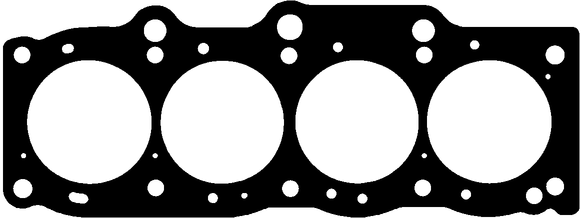

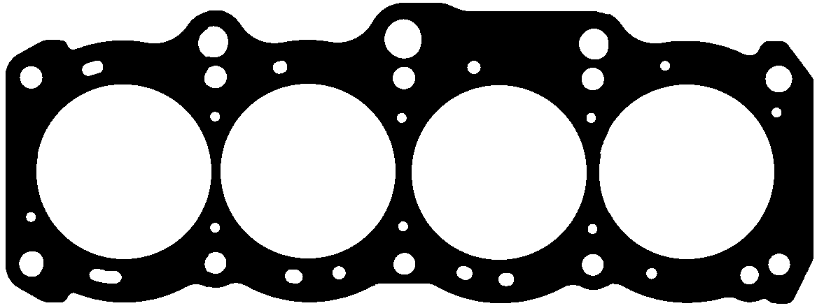

  1. Well the story so far , took the head and gasket to engine machinist , head was warped and gasket had failed between 2nd and 3rd cylinder and across to 2 coolant channels beside return oil channel which had excess presure thr coolant that has cracked radiator .After picking up resurfaced head the mechanic said i have 2 gaskets to choose from ? Original BR250 or BS970 the 970 has 4 extra coolant holes , now im totally confused. Would the 970 allow a higher flow of coolant that would keep the engine cooler ? Or should i just put the new original back ? One more question has anyone cleaned the mud out of the block while still in engine bay, and if so how did it go. Cheers

  5. Hi, Hope one of you guys can help explain this one ? Bought a 94 Rav about a month ago , noticed that i was losing coolant then noticed leaking from radiator , mechanic said it was history so got a new one fitted also rocker cover gasket as that was also leaking. All was sweet then noticed lose of coolant again , back to mechanic who thought faulty radiator BUT looks like radiator blew cause to much pressure saying that head gasket failed and cylinder is sending excess pressure through the coolant channel and thats the problem, well rather than spending massive bucks with mechanic we stripped the engine down ourselfs to find perfect head gasket NOT blown , compressing rings not cracked. Is there another way that the coolant is getting undue pressure on it to cause the radiator to " as my mechanic said balloon out " ? Also there is 2 styles of head gasket for this model they are slightly different 1 has a few more coolant holes than the original why ? Thanks for any advice Cheers
