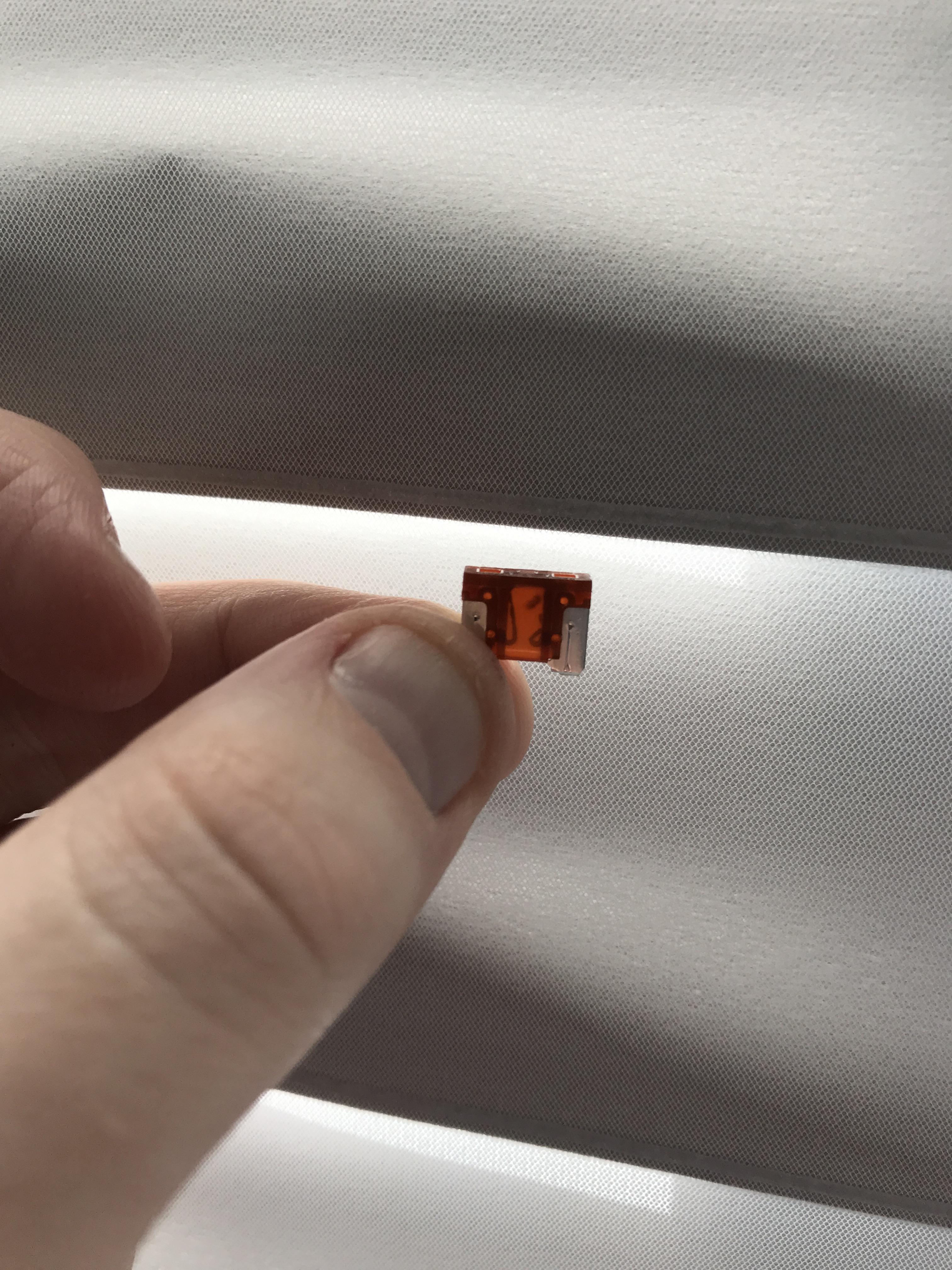

    Advanced Member

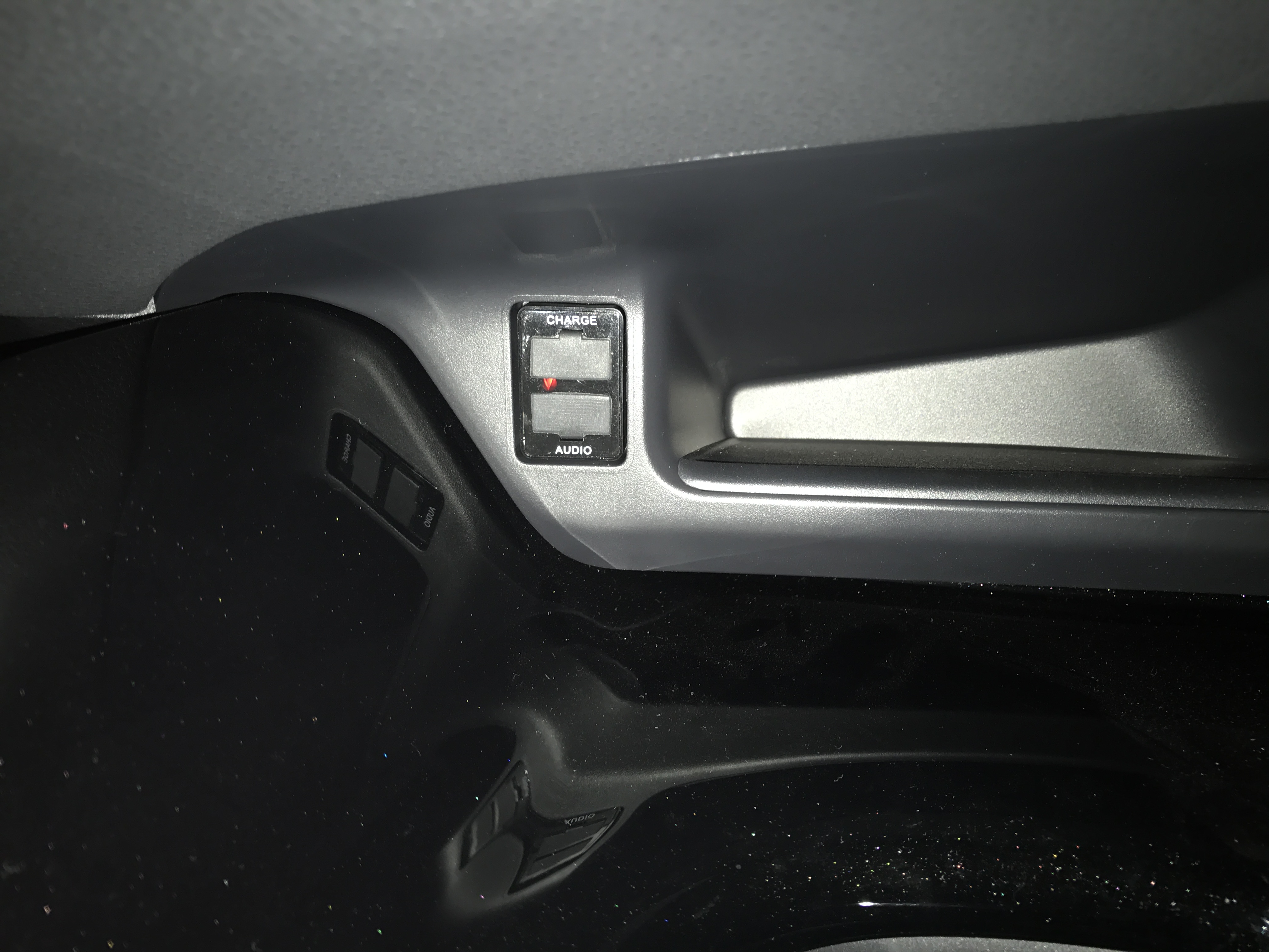

  1. Thought I'd circle back to the forum since I ended up doing a little revision the other day. The USB was a cheapo from eBay. My memory is that I typed "Toyota USB port" into search and picked the one that was the correct shape. I use a fuse tap to piggyback off some low importance fuse. It lasted about 6 months before the power slot died. I discovered it was burning out the fuse in the tap. It wasn't a big problem as I still had the port connecting to the stereo. A few months later that started to struggle and Apple Car Play was having all sorts of issues. I pulled out the USB port last week and ran the Kenwood head unit USB extension cords down to the passenger footwell. Getting power and syncing to Apple Car play without issue.

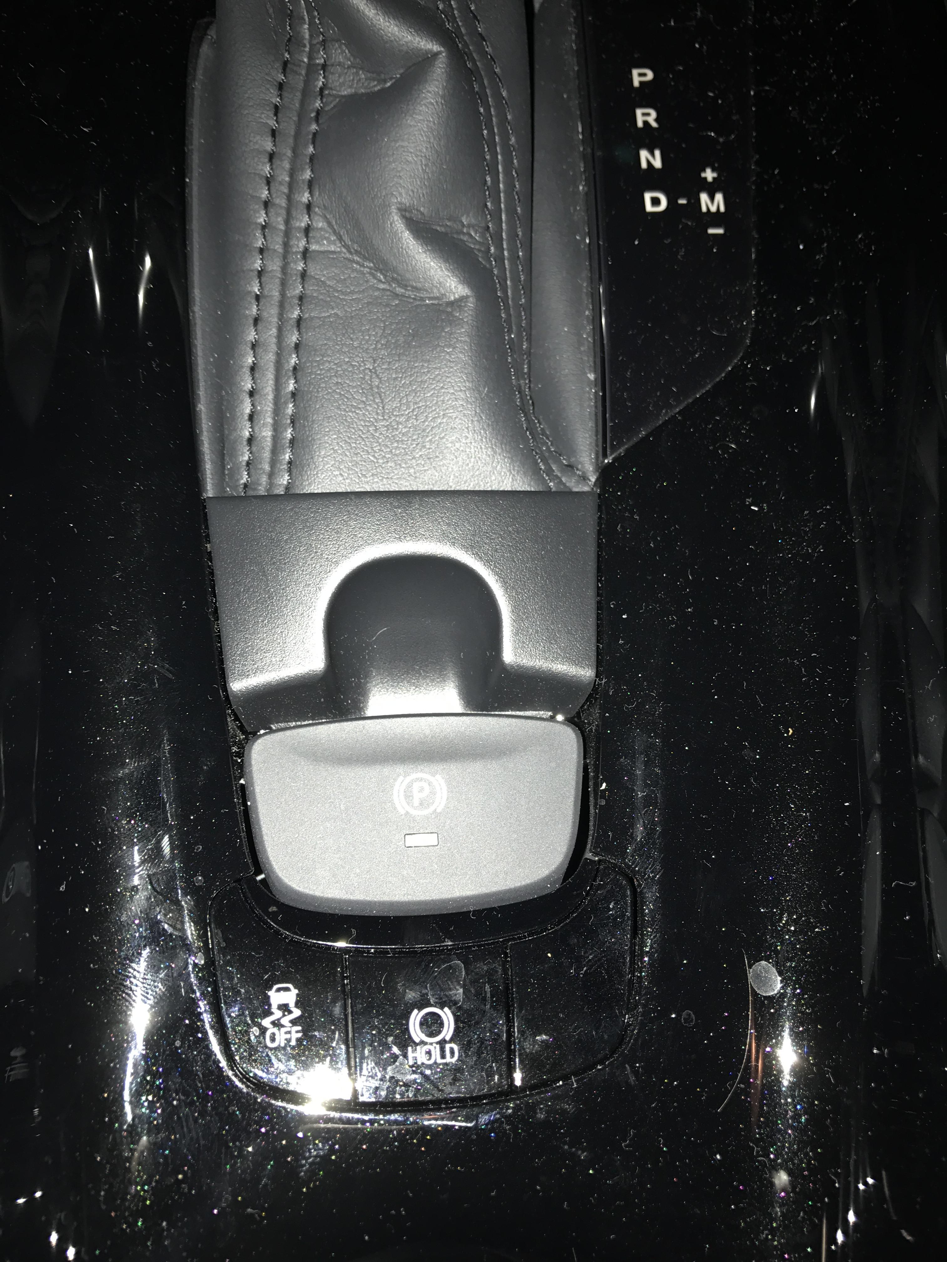

  5. http://www.toyota.com.au/news/toyota-australia-recalls-chr-for-electronic-parking-brake-operation I haven't been contacted yet. I would think most of us are affected.

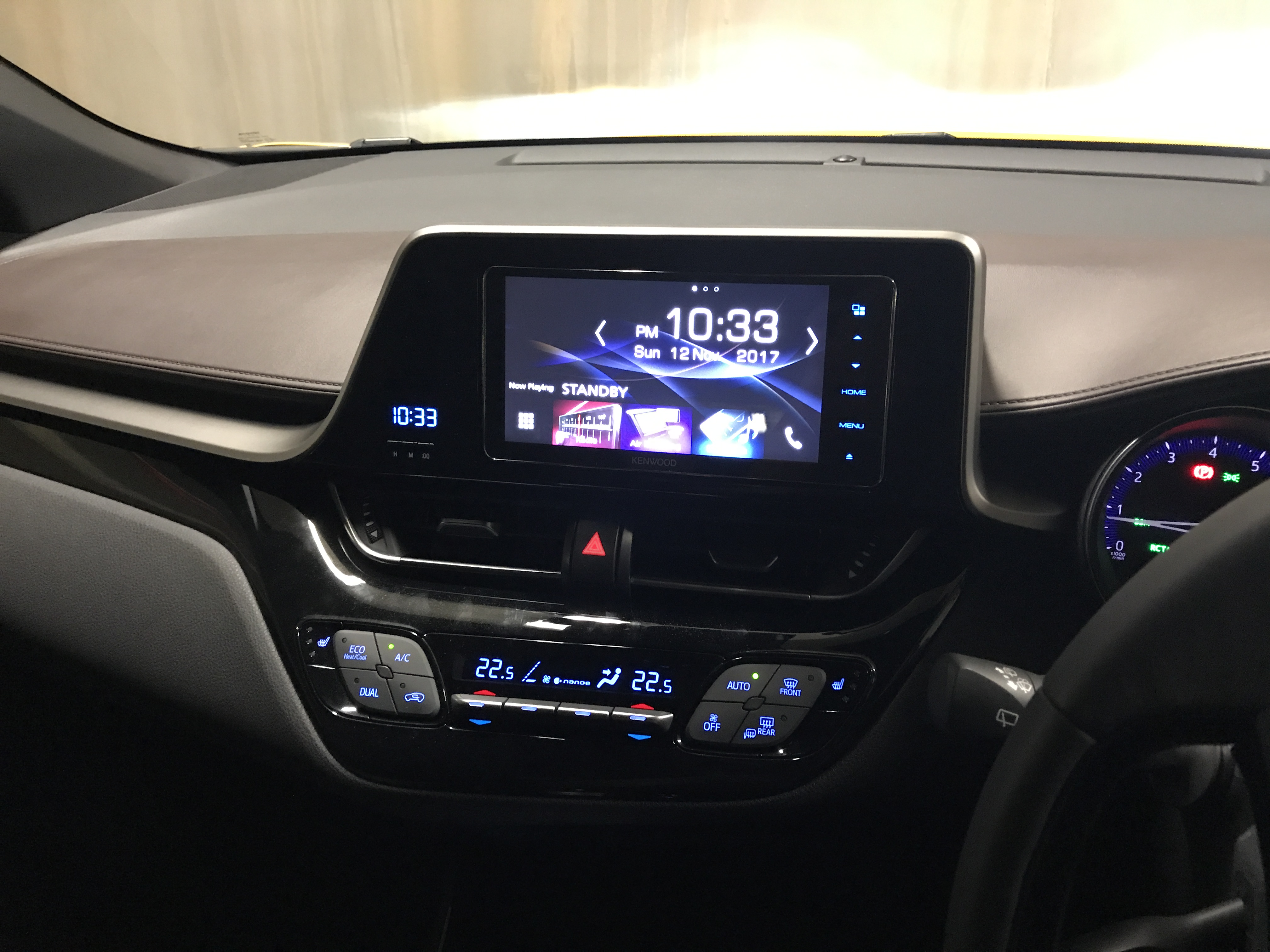

  7. I have no issue with the speakers. I'm a happy chappy now the head unit is swapped out. Apple car play is a nifty little feature.

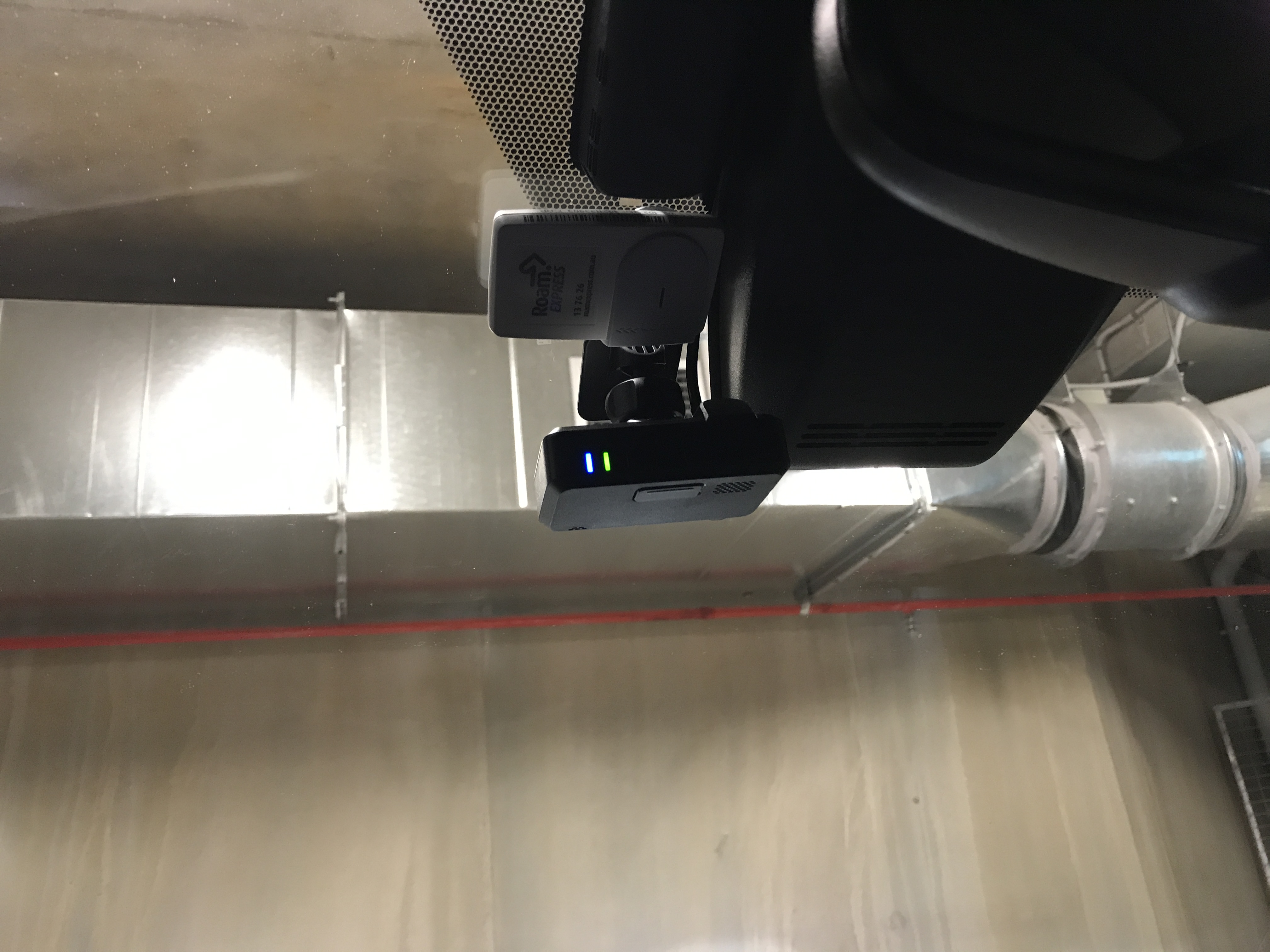

  9. Cheers! Running the Dashcam and Mic are probably the most fiddly of the jobs. Lots of video shot, will put it all together in a week or so.

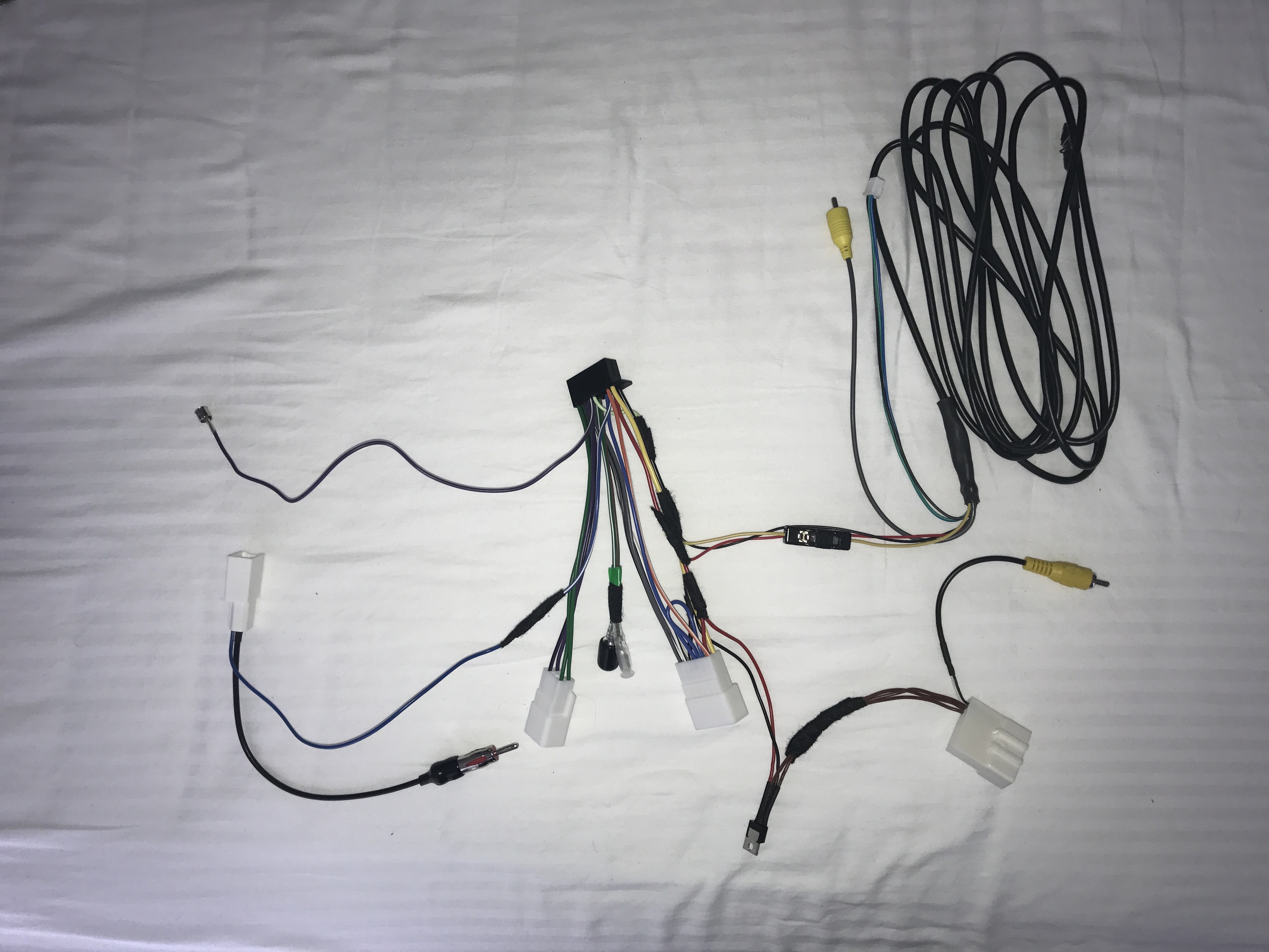

  11. The OEM prices are ridiculous! Definitely worth the wait to build something that is plug and play.
