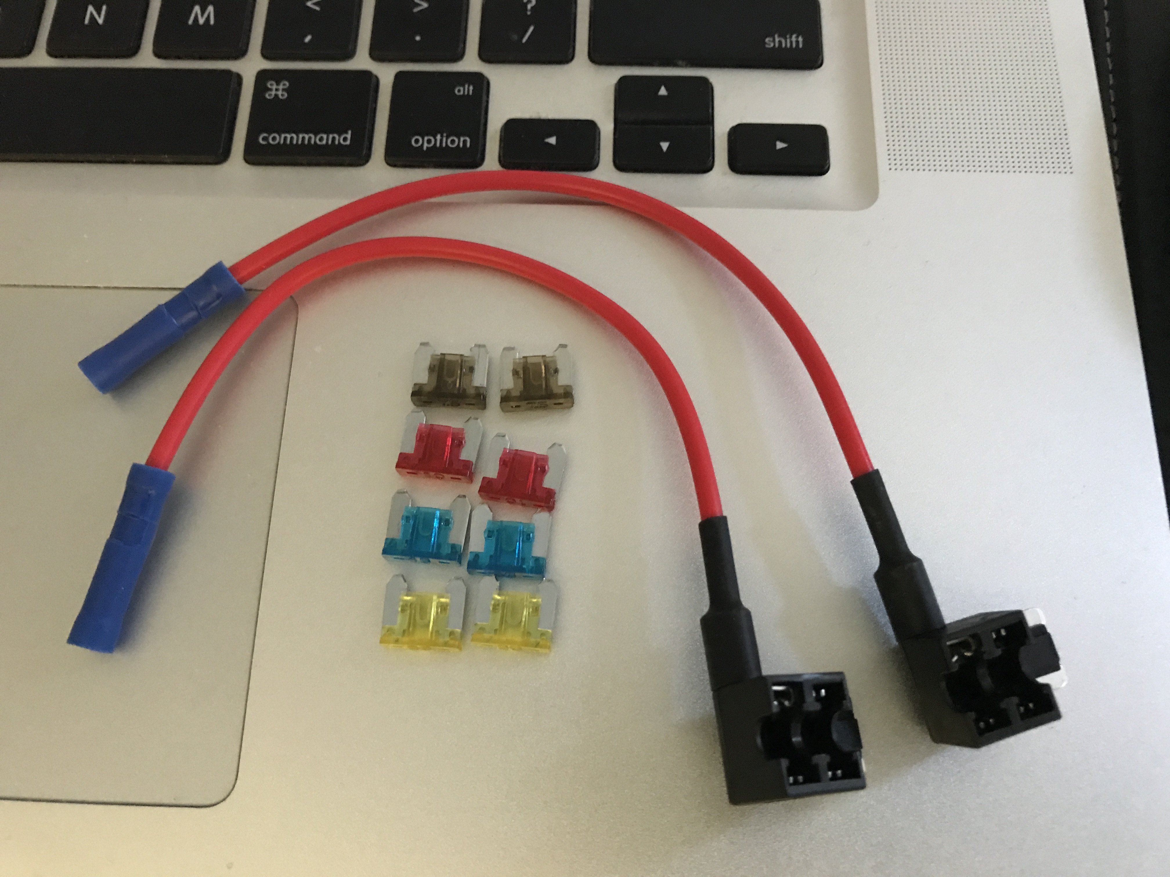

This evening's tinkering was on fuse box underneath the glove box. The three empty fuse slots are constantly powered, they would be a perfect place to fuse tap in for a Dash Cam with a parking mode. The Kenwood cam I'll be using will solder into the Kenwood Head Unit's harness. Interior cabin lights (DOME 7.5A fuse) are constantly powered. After twenty minutes if the ignition has not been turned on the lights will switch off, however, the fuse circuit still has power and could also be tapped as a constant power source. I'd just stick with utilising the empty fuse slot personally. Playing with orientations of the fuse tap revealed that the supplied fuses that arrived today are really quite garbage. The coloured plastic separated from the metal when I pulled them out from the fuse tap. Hardly a shocker given it was cheap eBay crap. I'm satisfied with the quality of the fuse tap itself, but I'll be popping back to Jaycar for some decent Low Profile Mini Blade fuses for peace of mind.

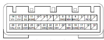

Nice to see it coming together. This picture might help with your 28 Pin, keeping in mind it is a generic toyota map and may not be applicable to the C-HR, but I think this correct.

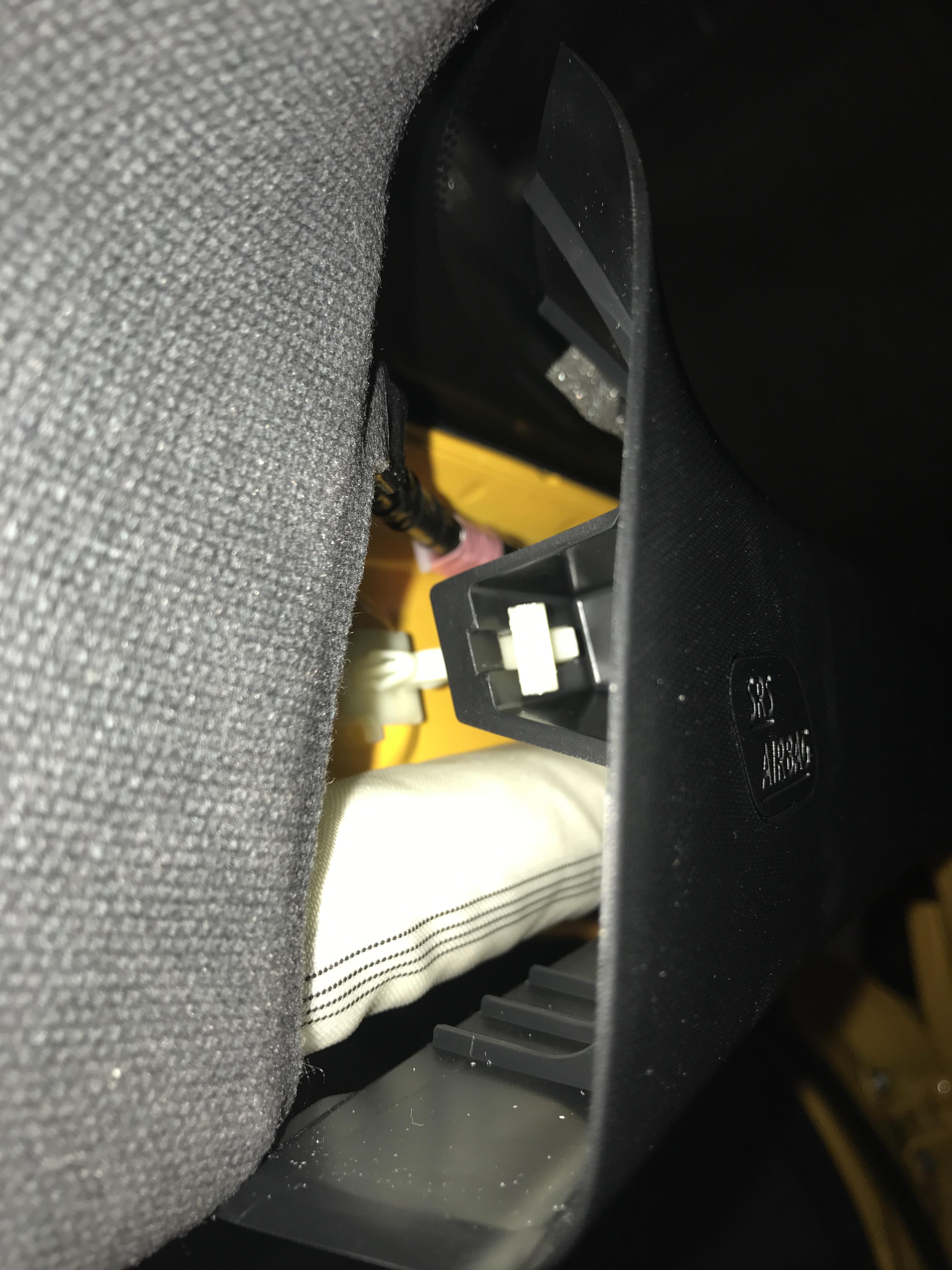

Another post. I know I'm obsessed. 😁 A Pillar trim a little tricky to get off. Pull down on the pinch weld so it's out of the way. Grab behind the A Pillar and pull towards the driver side. The clips will allow some forward movement but latch to retain the trim. There is probably some twisting you could do to completely free but it wasn't obvious to me. It's a tight space to work in but this will let you get behind he airbag for mic and dash cam wiring.

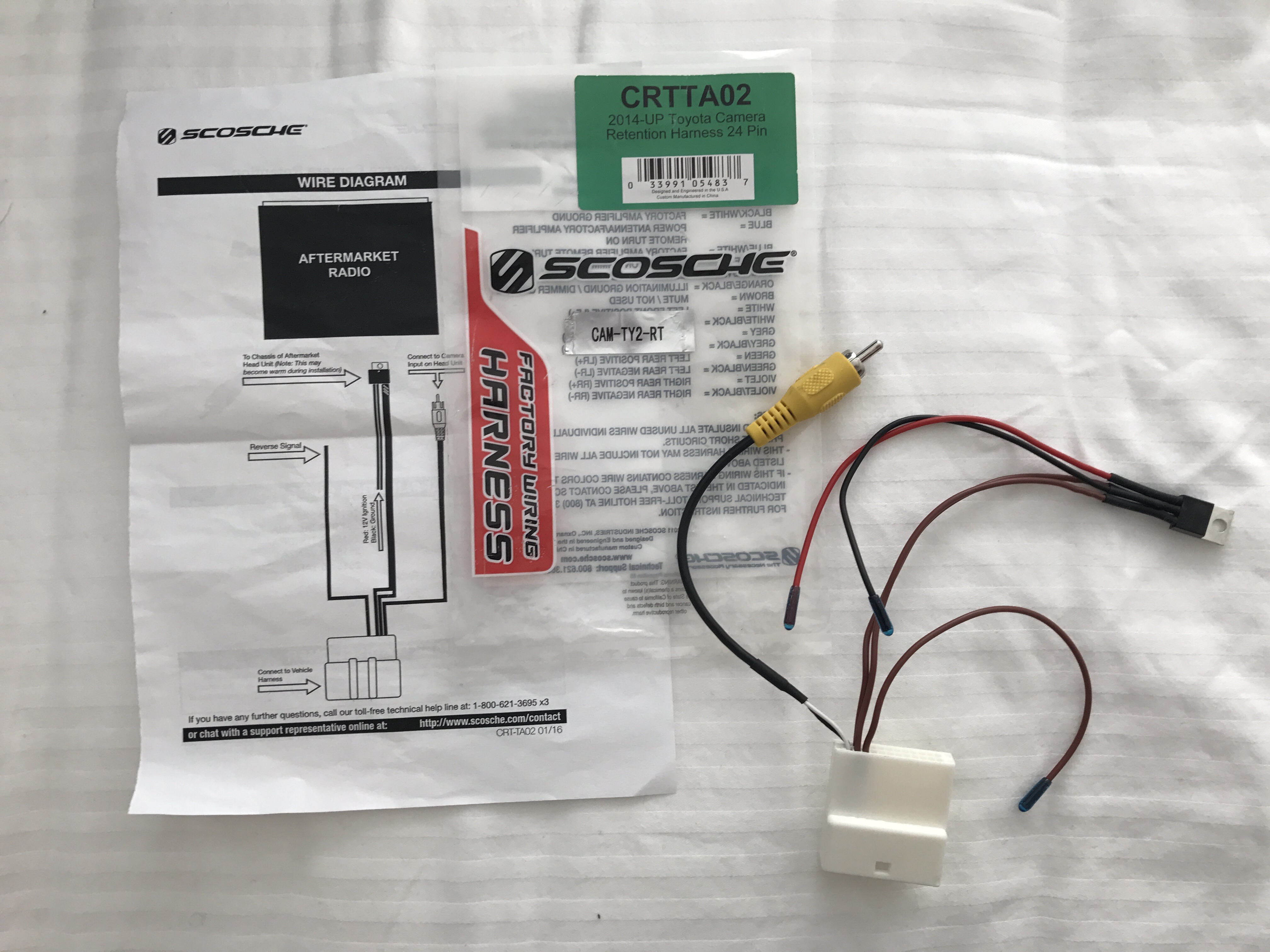

The final pieces have started to arrive. Tested today and I can confirm this will fit the Australian 24 pin reverse pin plug. Disregard the right most brown wire as it will not be utilised for reverse trigger.
