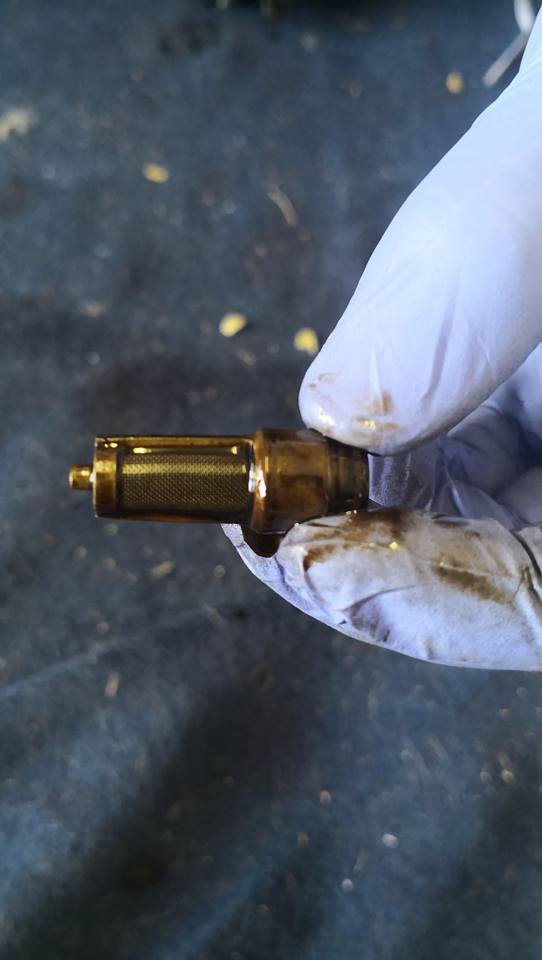

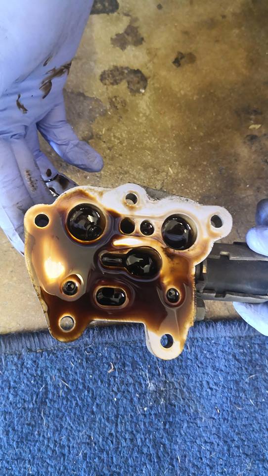

Hi Squalled,
It is currently sitting on 272, xxx kms. I will try to check the OCV and lift filters once I have a bit of time tomorrow and from my knowledge, the service history is up to date.
the exhaust is a 2 1/4 inch and remains the same width as before, just with a longer resonator and different muffler.
I was previously running a CAI and went from stock as well but that didn't seem to affect performance in any way in terms of the transition to lift.
I will try and record and upload some videos of acceleration to see if that might be helpful in diagnosing.
