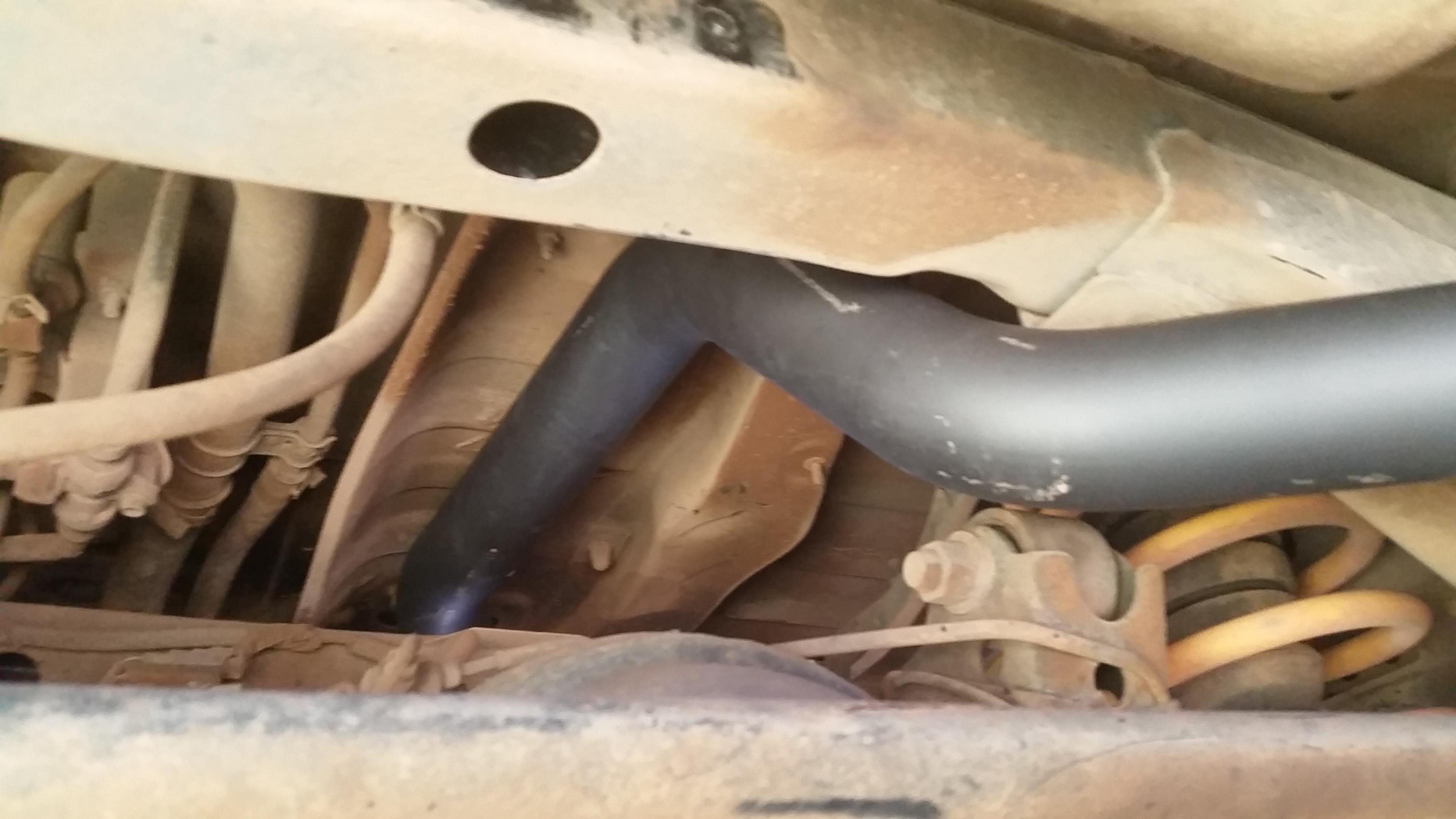

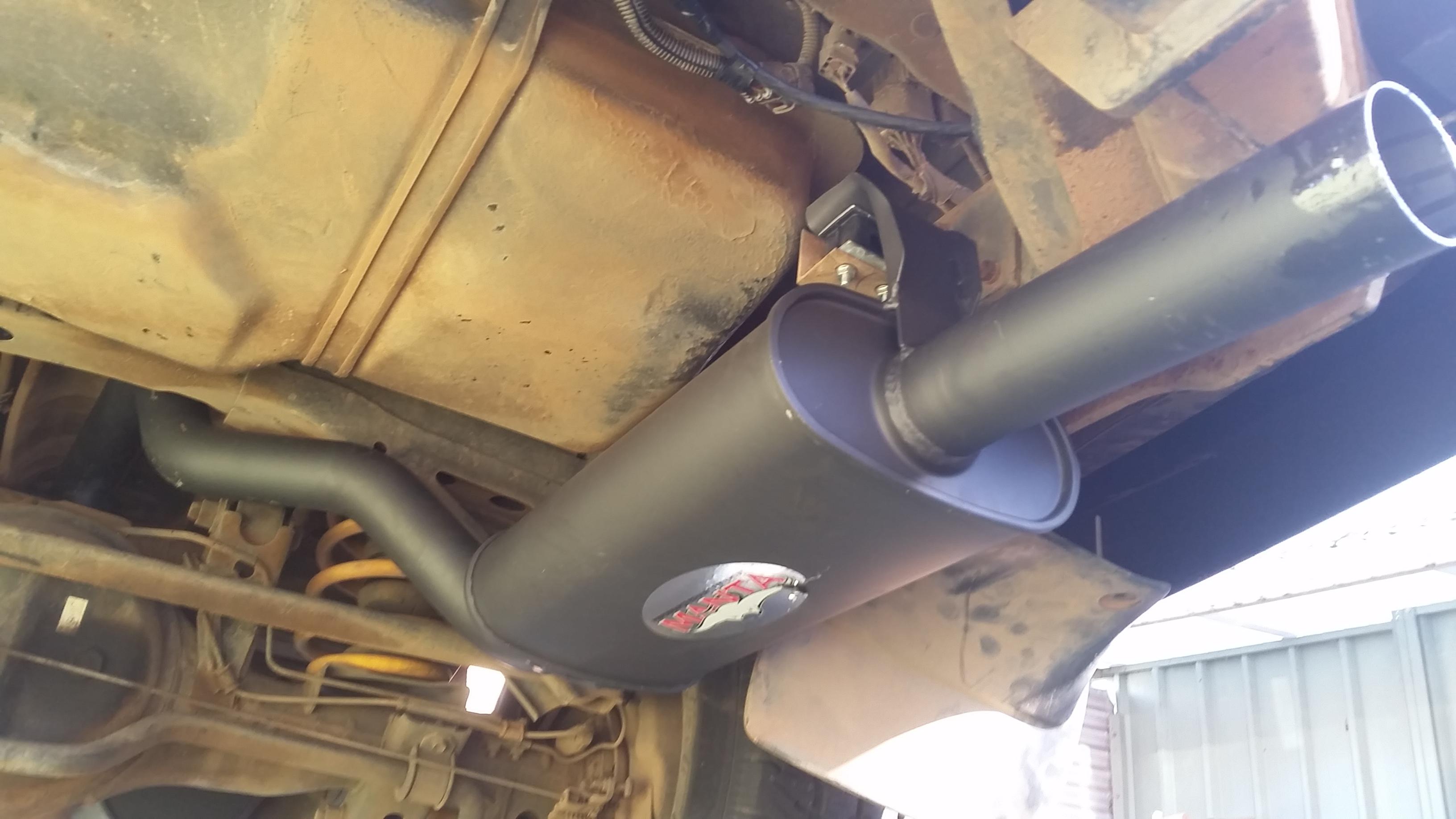

I have just fitted a Manta exhaust, from the engine pipe back. Took about 2.5 hours including cleaning up my tools. I was advised just cut to remove.
It's an easy DIY job if you're keen.

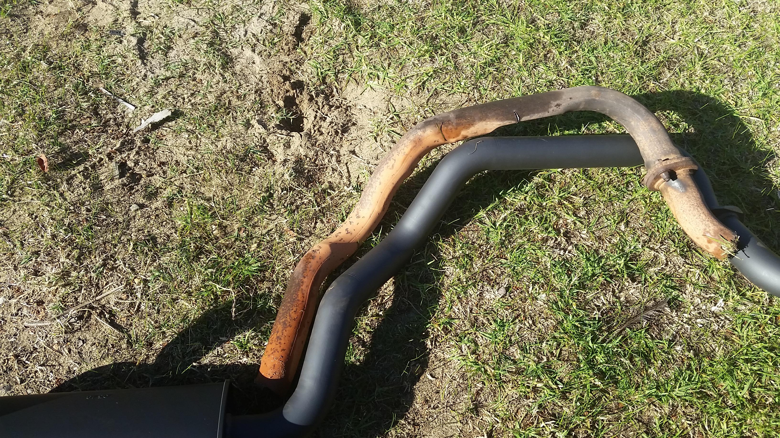

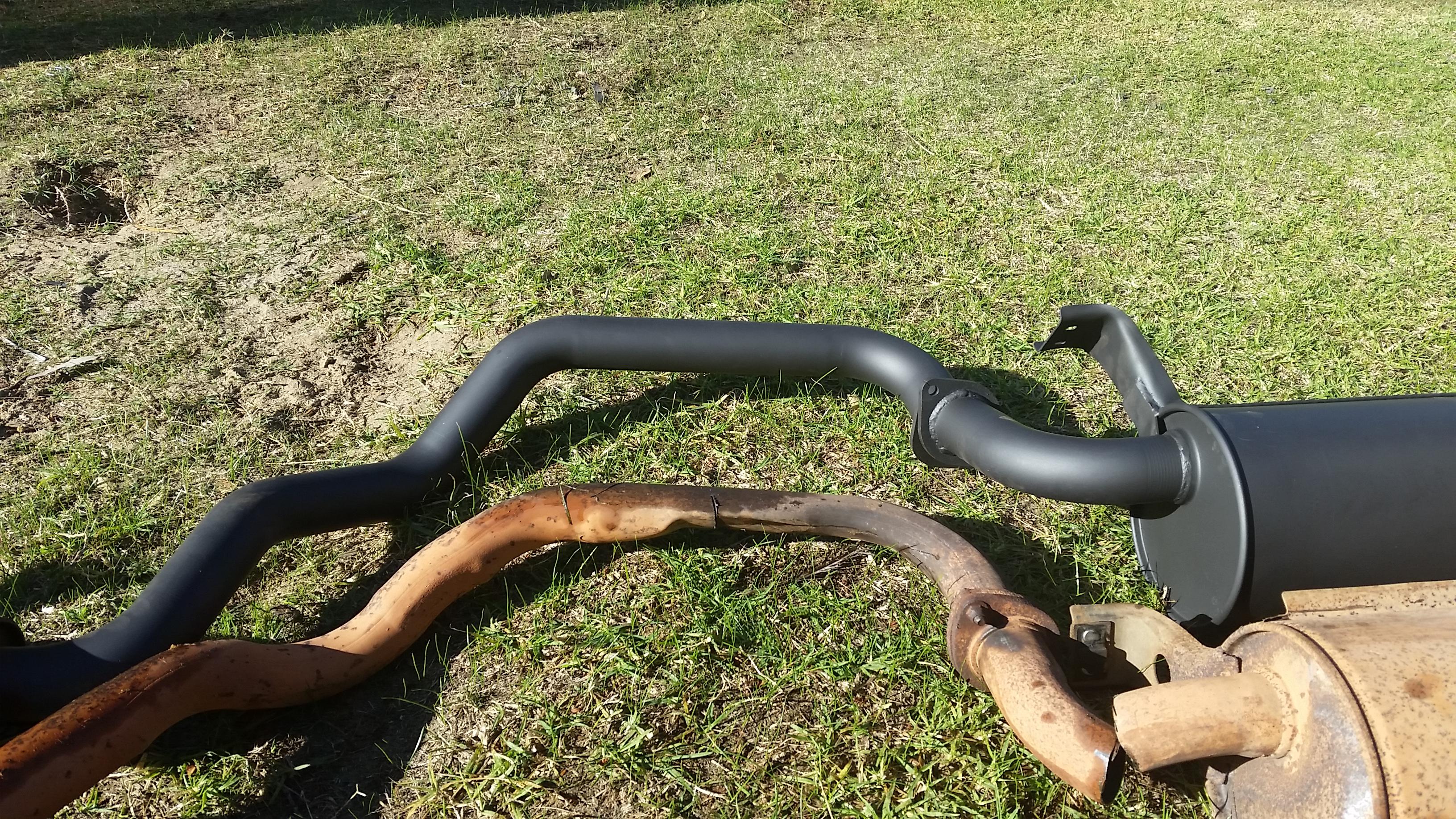

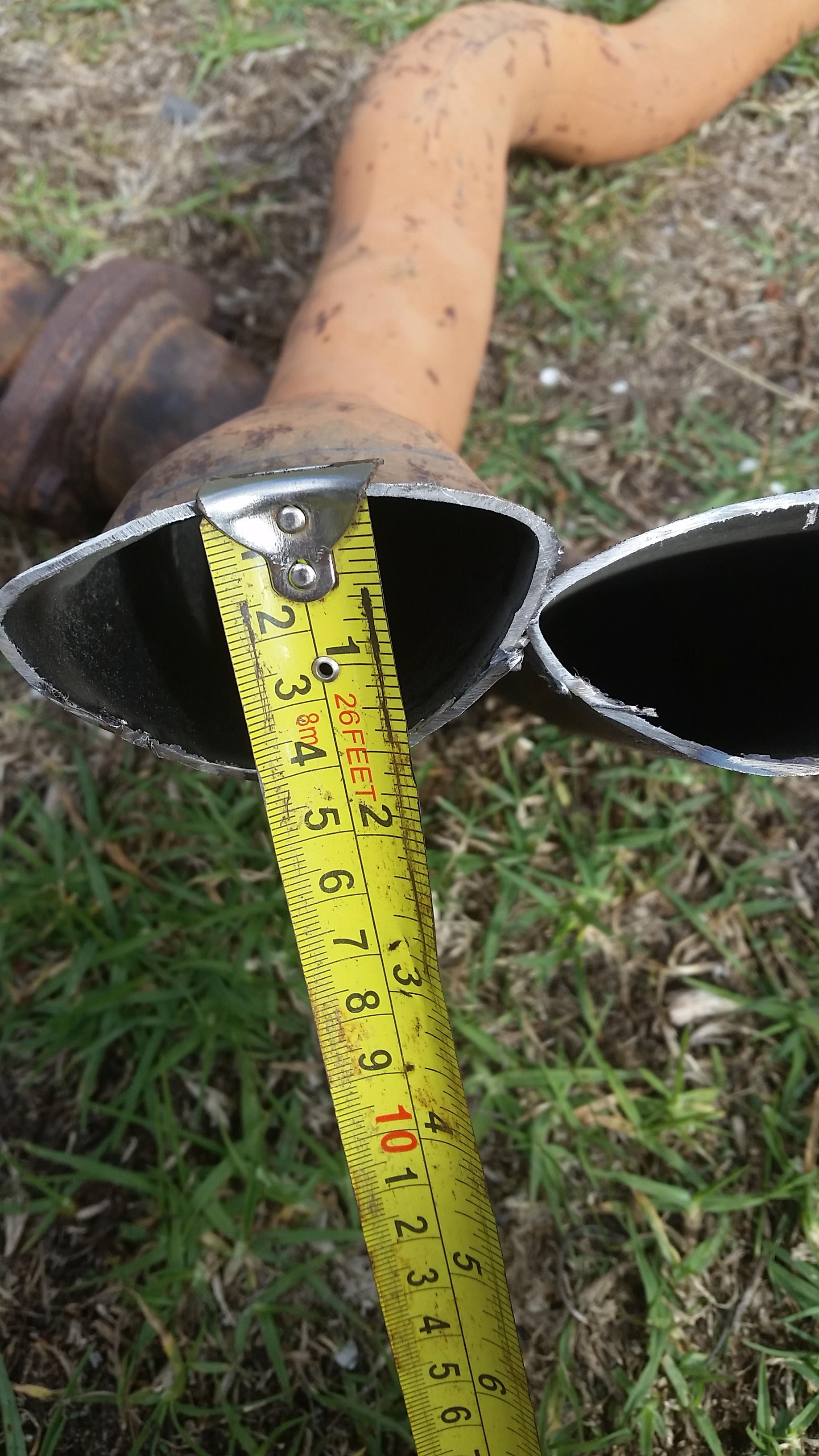

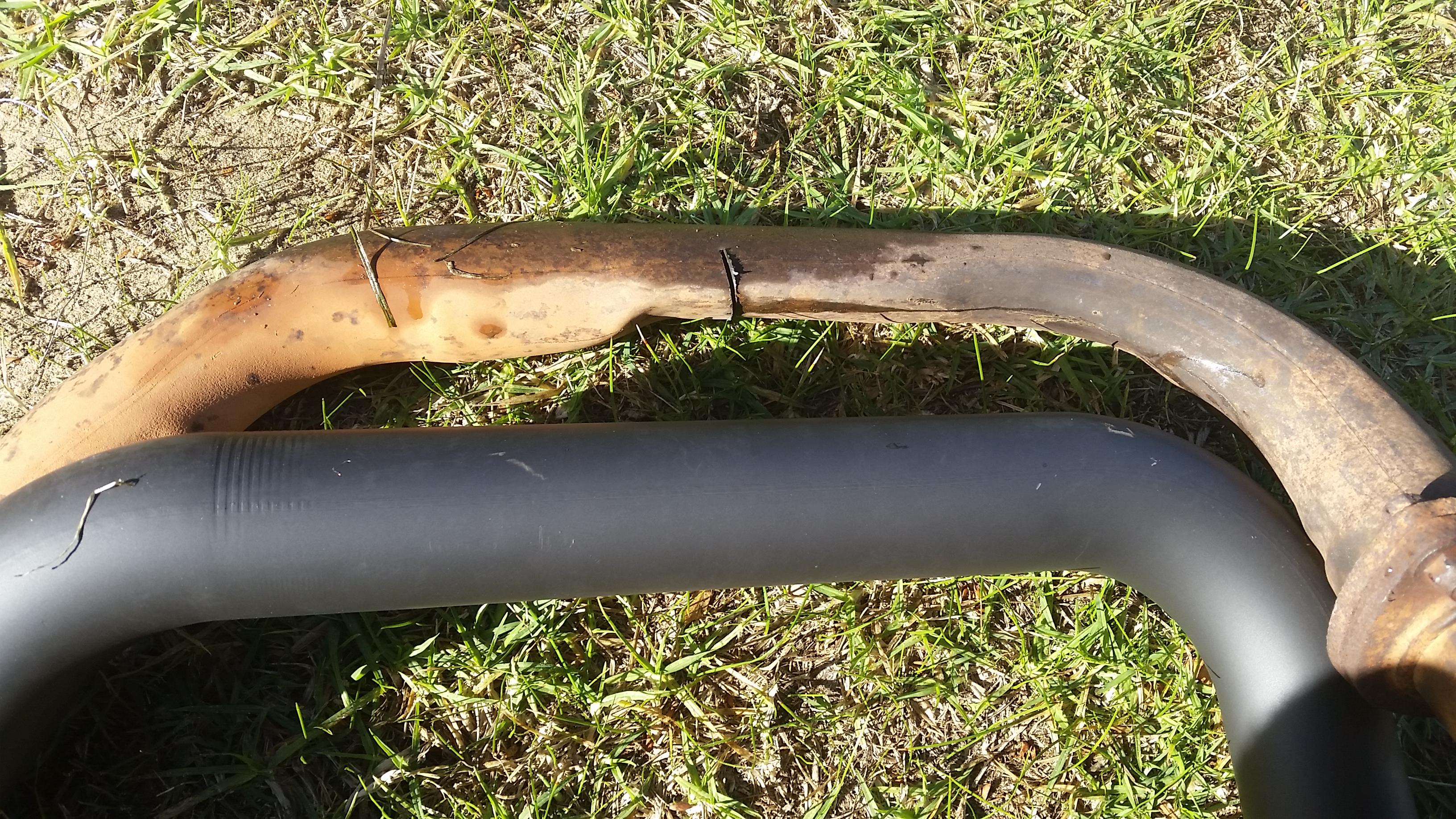

I've searched the internet high and low but not found many comparison photos of stock vs Manta bolt-on. So for your viewing pleasure I have tried to show the stock exhaust issues. Above the rear diff is an awesome squashed bit of exhaust.

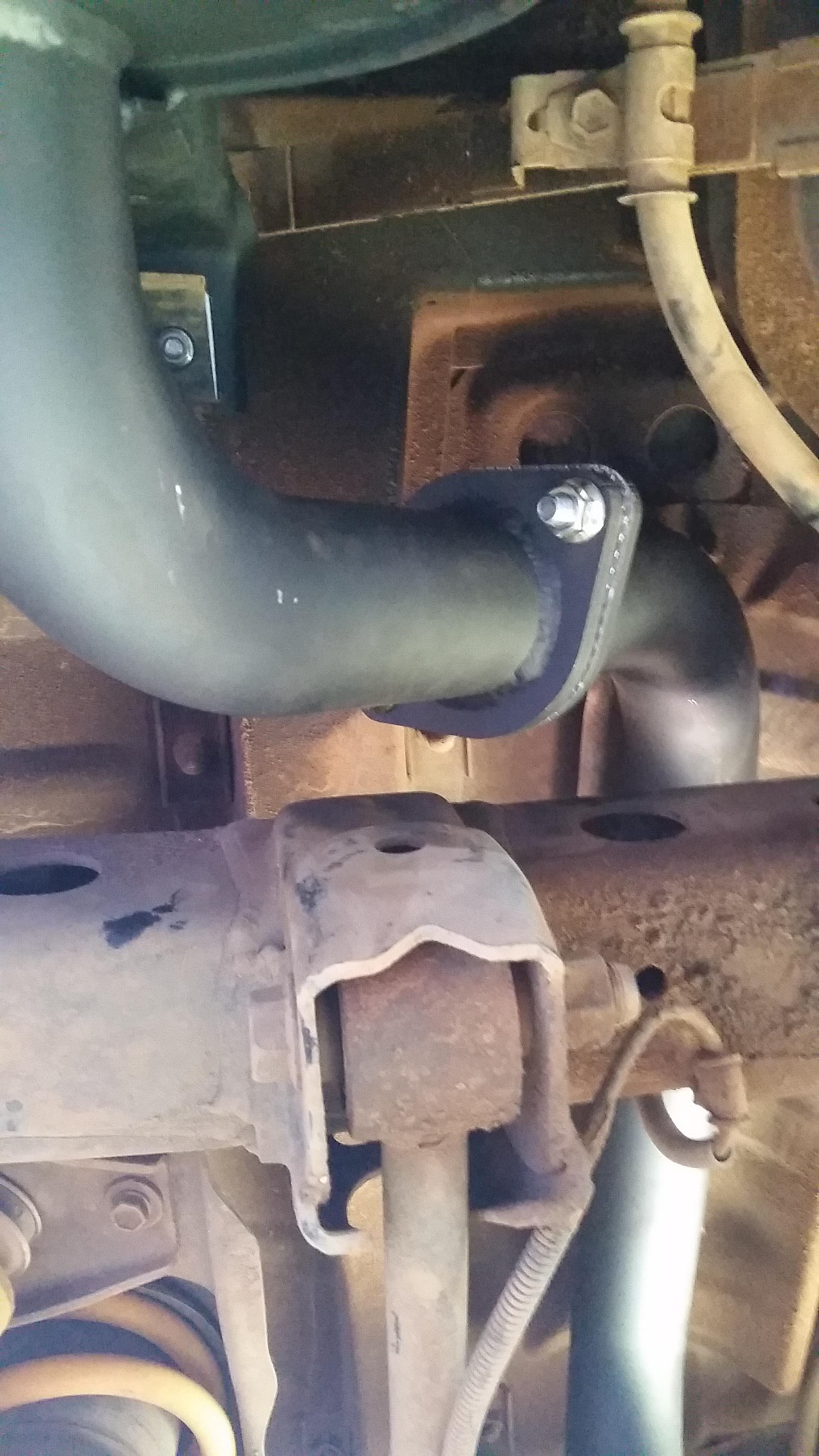

I opted for the quiet, aluminised steel. It was delivered in a day with all new bolts, gaskets and mounts.
