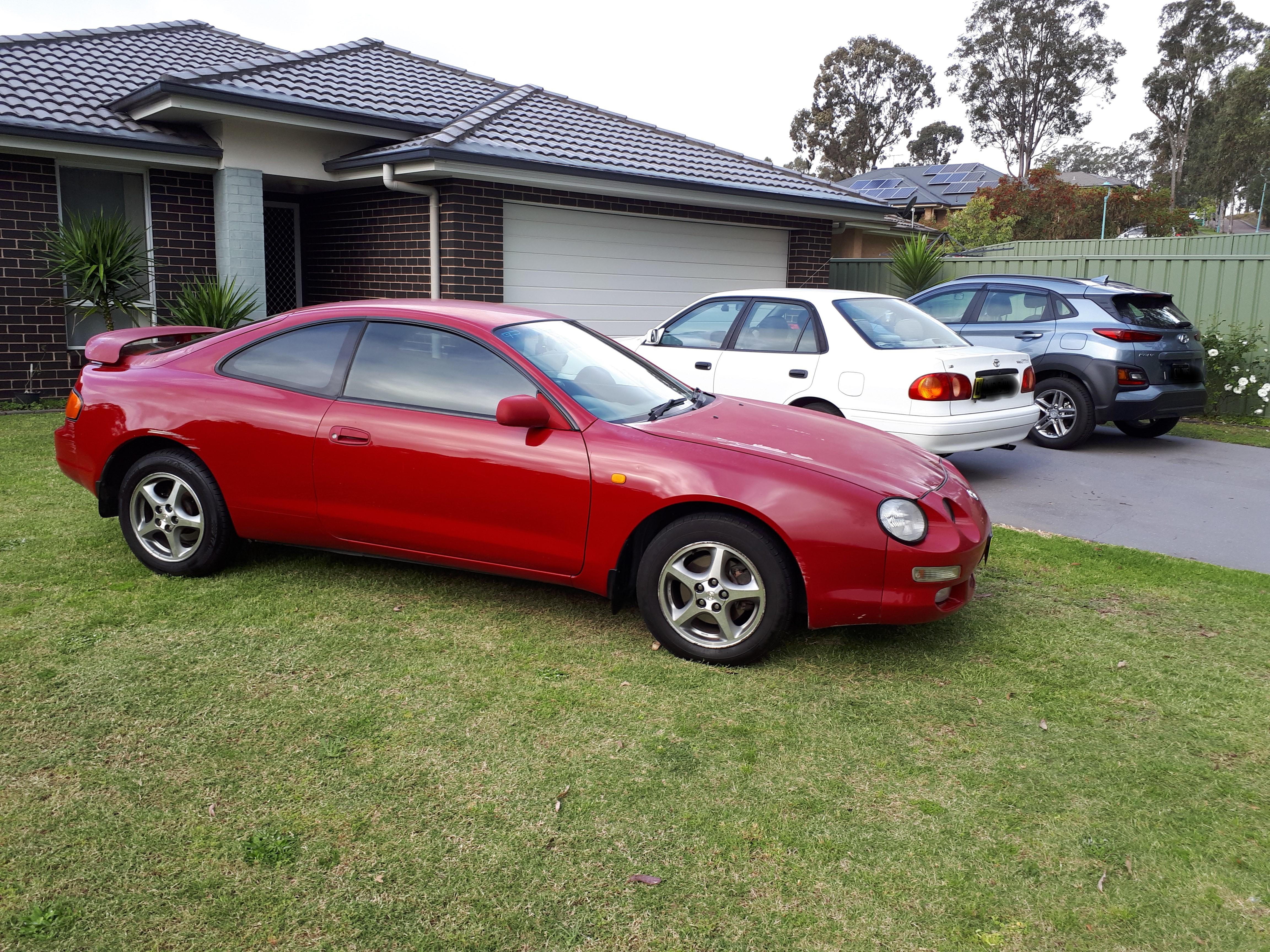

Hi all, just joined up have had several Toyota's over the years - mostly Corolla's - and just picked up a scruffy red ST204 as my work hack. Do 90 klm's per day to and from at varying hours as I'm a shift worker. This old girl is mechanically sound just old & a little beat up [ like me 🙂 ] It's an SX-R 1998 with a VSS but no remotes. No plans to do anything to it as it drives great and for my purpose scruffy is good
