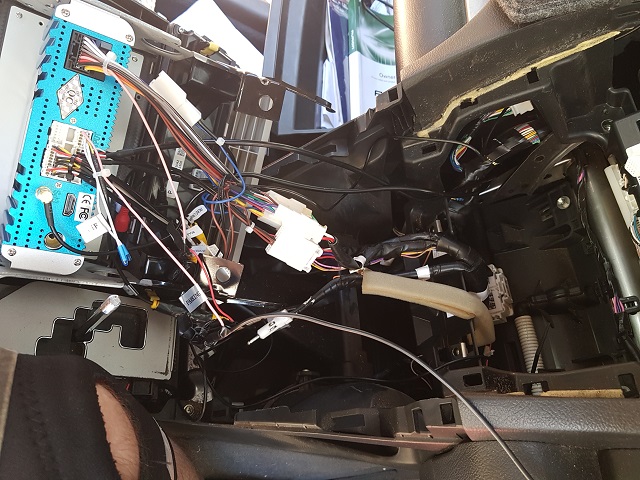

Looks fantastic, are the wires coming out the top vents the gps and dab antenna?? Did you get an dedicated microphone for phone calls? Something I have to do for mine now as call quality for the other person is shocking. Also did you take out the stock camera and replace with a 12 volt one if it came with the new stereo? I heard the old reverse camera was incompatible with aftermarket stereo's as uses 6 volt to trigger the signal. I am sure there is a fix - maybe. Well done mate.
YES
google play and maps will have to updated to work, for the gps that is also, mobile hotspot the better method if possible, it needs to connect to the internet. Radio I am unsure, did the unit come with a manual with instructions for using the units operating system? Can you scroll down from the top - swipe down, there is a warning from the unit a explanation marked triangle, it should tell you what the error is

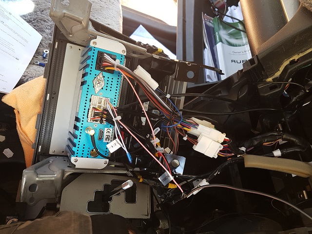

Hi Rick, looks like a antenna for wifi or blue tooth, do not earth it to chassis as I presumed it may have to be, I was forgetful in my analysis, the parking brake or brake labelled wire should be grounded to chassis for more functionality, normally a pink wire. I would leave it alone, should be o.k.
I just noticed that the antenna for the radio is hooked up from the wiring, I did not do this and the plug went from the car to the unit directly, as you know your gps antenna needs to connect and be firm on the fitting. Good job Rick.
Well done Rick, your almost there, I was the same with a lot of sub out connectors also unattached, the blue bulb? I am not sure of, it is not obvious in the picture, I do remember that one was reverse ( yours may be back) which I put in another earth to chassis, attached to an crimp able fitting with a hole in it for a bolt to go though, this earth was then bolted back in with the stereo (10mm bolts) with this you then can watch movies as you are driving otherwise properly its connected to the foot brake and won't let you watch a lot of stuff because you are not stationary with the vehicle. I think that's what you mean by the blue bulb, but if its a bulb not a reverse wire to be put to negative or chassis then it may be a wireless or blue tooth module antenna.? Can you circle the blue bulb please Rick.
Hey Rick, the light blue effect is the surround of the unit cooling (heat sink), see the larger grooves in the upper edges, the unit is alot smaller than the screen, only protruding into the cars recess nearly half or less of what came out ( the old head unit ). This part of the new unit is the brain behind the screen and the connector for the wiring harness to go to the car, including on mine, usb connectors that go through to the glove box, gps antenna, which I hid under my dash mat, cable coming out above the air vent. And all the connectors for power steering wheel control etc going to the vehicles wiring. From what I see of your new unit it includes the facia around the screen, after unbolting the old unit from the frame it sits in the new unit slots in sideways firmly to align with the a/c controls . In this picture this has already been done, note the antenna from the vehicle has not been connected yet as it was shorter, and do not forget to plug back in the a/c control plug before stitching it all up again.
Honestly Rick, I reckon you could have a good go yourself, although with my unit the stock reversing camera was not compatible with my head unit, the supplier included a replacement one, if you want the stock one take it in to be professionally installed as the stock camera works at a lower voltage, around 6 volts not 12 volts required to trigger the reverse cam on the new unit. I seem to be contradicting myself again, its totally up to you what happens, just saying its not rocket science or brain surgery.
Hi Rick that unit looks nearly identical to mine, as in my post the unit arrived with three wiring harnesses, that is from the unit to my cars wiring, I chose the one that had most of the correct connections, steering wheel controls work from this wiring, just need programming from when the unit has powered up and inside a setting menu. You can do this yourself following online guides, beware of scratching the plastics and use a softer plastic knife or utensil to prise out certain fittings, 10mm socket and your there. Rick what spec is your unit Gb of ram and rom? I also used the stock car antenna straight to the new unit as all three wiring harnesses had an antenna going into the new unit, this I did not use. Also about two plugs never got hooked up from the car wiring to the stereo, one must have been the stock reverse camera the other is any ones guess. I did it all that with the positive unhooked from the battery. Personally I was not satisfied with the glitchy software on my chinese Rockchip device, along with after research the os was fake android 10 and actually android 9, so I paid a bloke on a forum for his full version for my unit (research required on the forum he is on) which for mods of software payment is not normal for myself as I have a modded software Samsung galaxy mobile phone done for my time only. Website if this is allowed for the mod on my unit is : https://forum.xda-developers.com/t/rom-px6-stm32-9-0-malaysk-rom-for-px6-mcu-stm32-rk3399-with-android-9.4111653/ These 'roms' are unit specific so I would not do this unless you know your units specs exactly, you can brick the unit, though in saying this its well worth the money and time for a workable software option. With a lot more features. I have no affiliation with the author of this software. There is a free lite version that is good but not as good as the full.

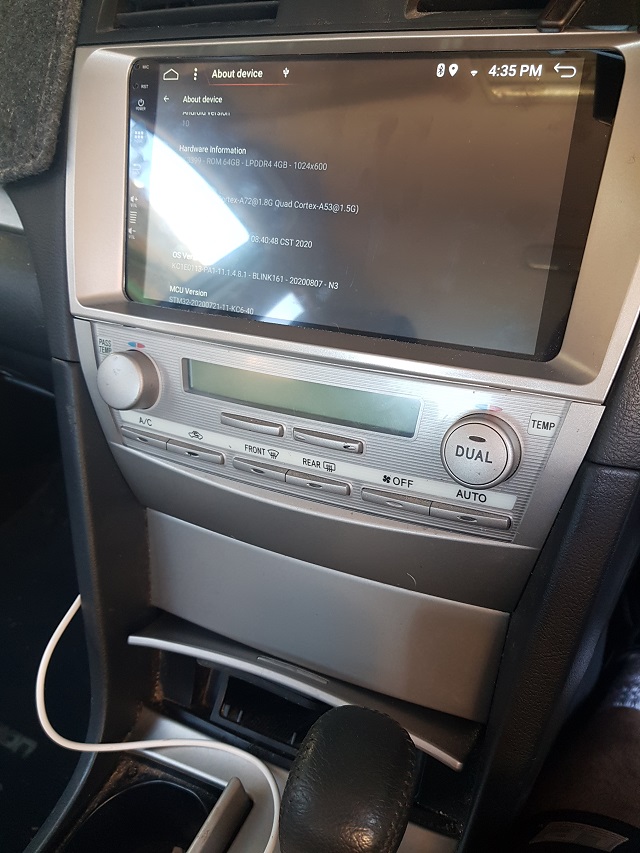

Thank you Luke for that info, I attempted this and then emailed the seller, he may provide a firmware upgrade as he has indicated. The wifi was connected for 40 minutes to my home wifi with the car in the driveway and it still did not update apps on google play. I had to disable the home wifi connection and tether my mobile internet to the head unit to get progress on the updating. Yes my unit is a octo core although it still takes it time booting up, and if you reverse the car before it boots the head unit resets. Very frustrating. Thanks for all the great comments / responses to my 'upgrade' Dan.

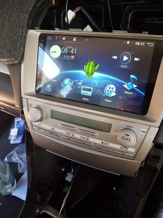

The new unit was then physically mated to the climate control and then wired up, it was fairly easy apart from the reversing camera, pulling out plastic running the wire from rear to front. The new unit had three harnesses to choose from to use. One to ISO , and two others, one I used as it fitted most of the plugs to the wiring in the vehicle. the steering wheel controls work, after setting and so does the new reverse camera

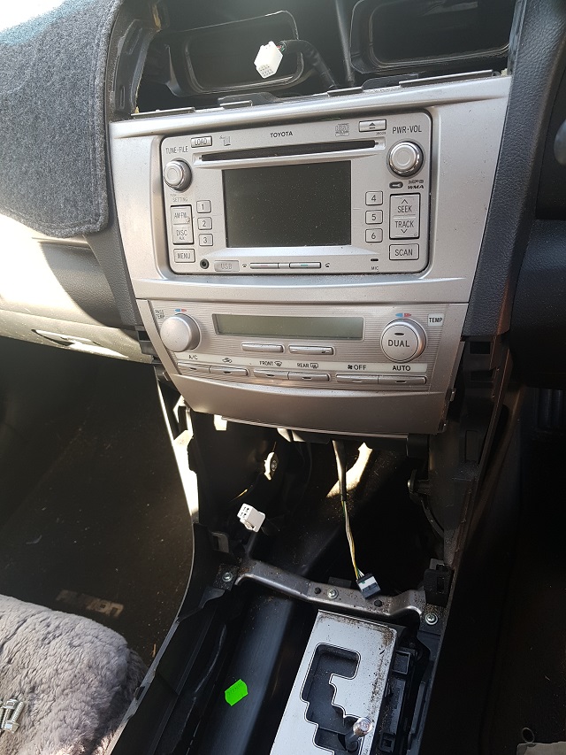

I got the news this morning that my heat unit was arriving, so I stripped down the appropriate plastic and removed the stereo, then waited for 4 hours for the delivery to actually arrive, with the car apart. I bought prior to install the 'better' 4gb ram 64 gb rom android 10 head unit gps, bluetooth wifi mirroring etc. And I got a Aeropro cable for the reversing stock reversing camera. I was a bit annoyed this morning when the package was opened and the cable was in two not one pieces. Anyway it was never required or would even plug into the harness of my vehicle. Don't waste your money on a "APVTY04" factory camera to aftermarket video adapter. This is my stock setup as it was this morning. The model of stock stereo, and rear connector of in which only three plugs from the car plus antenna were connected.
