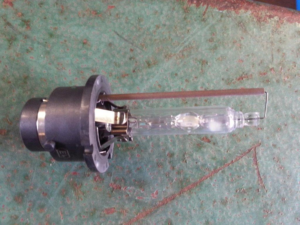

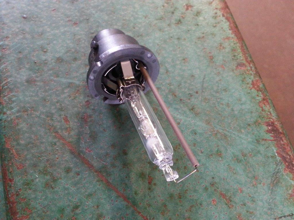

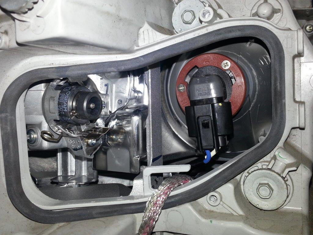

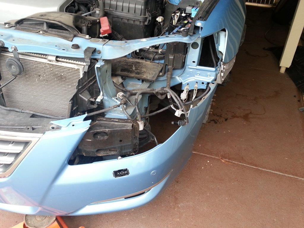

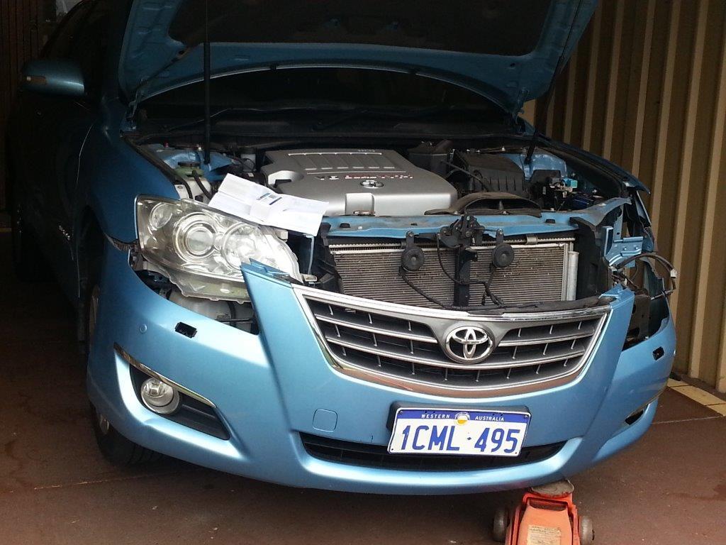

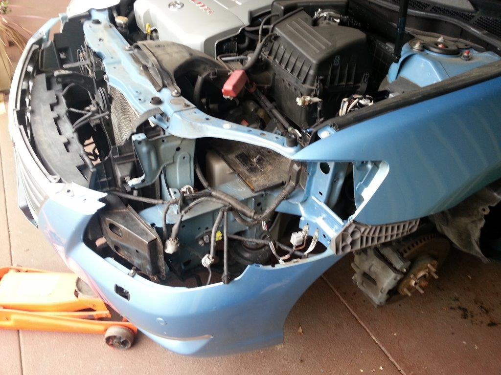

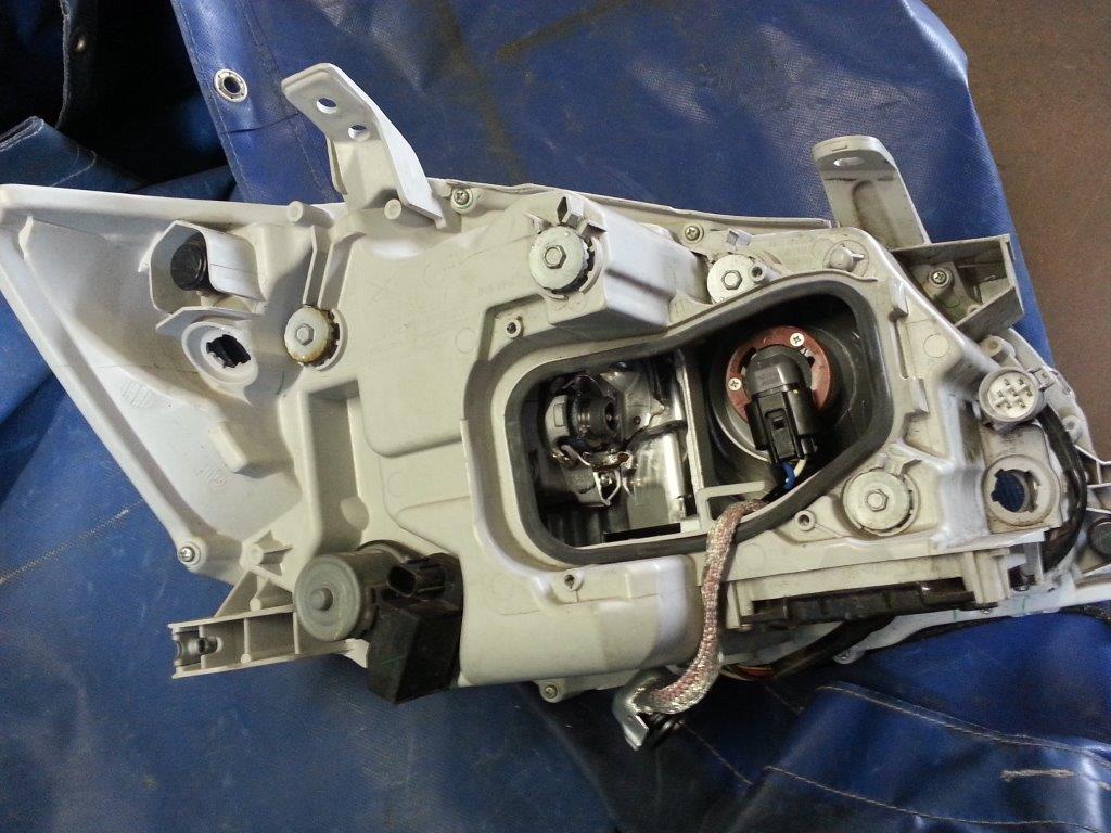

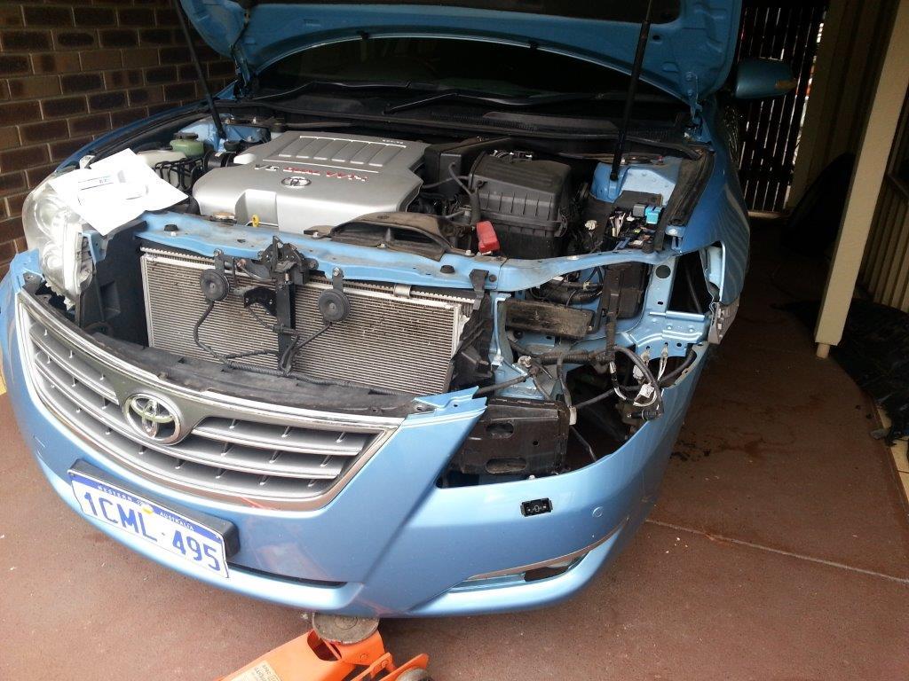

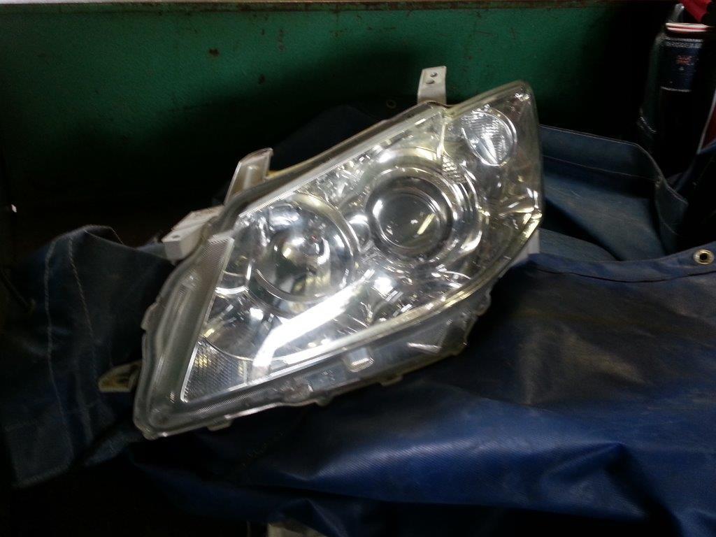

In Western Australia, we have a company named Repco. They purchased them from a Melbourne based company named NARVA. Part No. 49307 refers. They cost me $240.00 each including freight. I have been advised that this company supplies to Toyota (hearsay) and a mate of mine who works for Toyota states that a lot of mechanics use these offsite (for private work). The most important thing is to use the 12/24V D4S 35W for the Presara. The D4S is the only one. To replace it is not all that easy, see my photo attachments. I have also checked on eBay and the prices are much cheaper. Do NOT use el cheapo brands.... you always get what you pay for. abacab
