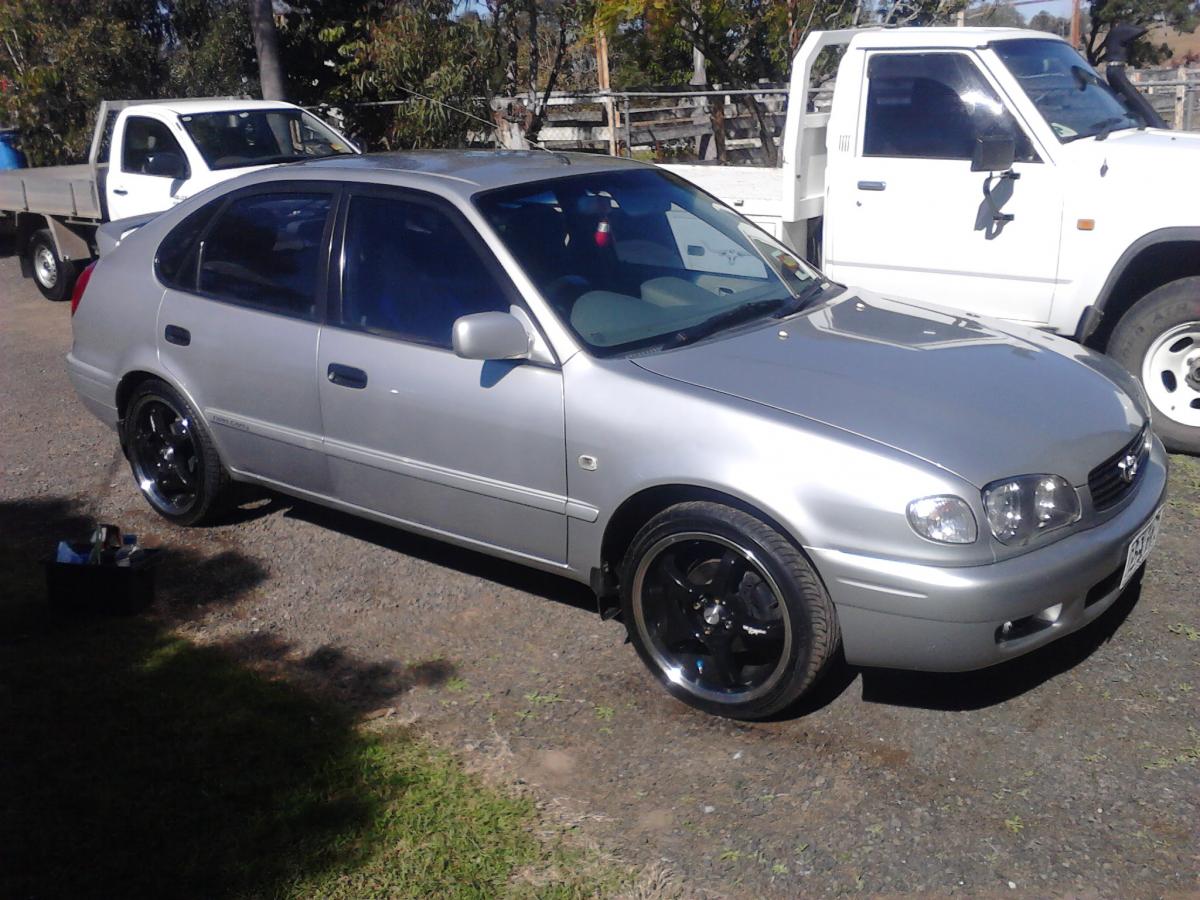

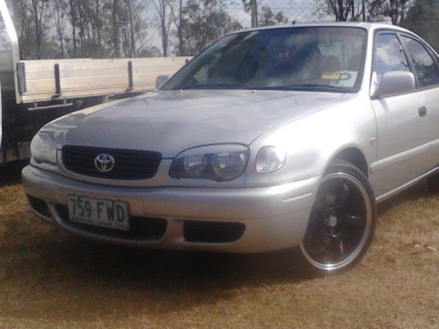

This is my project :)
What do you guys think soo far .. will post updated pics as i go.. these ones are abit old

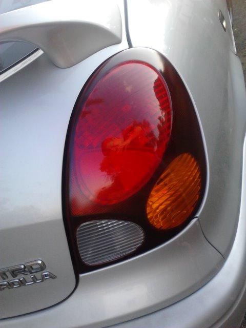

Mods done soo far.
lights
5000k HiD kit
Cluster Leds for rear lights
25% tint (looking at 20%)

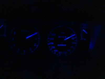

all leds in dash have been replaced with blue leds

Welcome man!
Car looks good mate.

16's are good man. I had sportivo rims on mine but that's as big as ill go.
Ive got some Enkei's 15x7 +35 and sit really nice with my gaurds.
So the lower the offset the more it will poke. It also depends on the width of the rim as well.
A perfect size would be 7" wide with +25-35 offset or if you like the look of the stretched tyres and all that 8" wide with +20-25 offset is also good as well.

Blue looks alright man, something different. Ive got white LEDS in mine. So much better than stock ones lol
