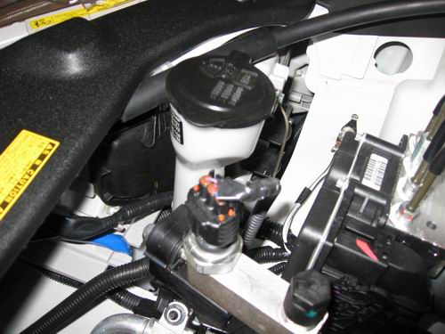

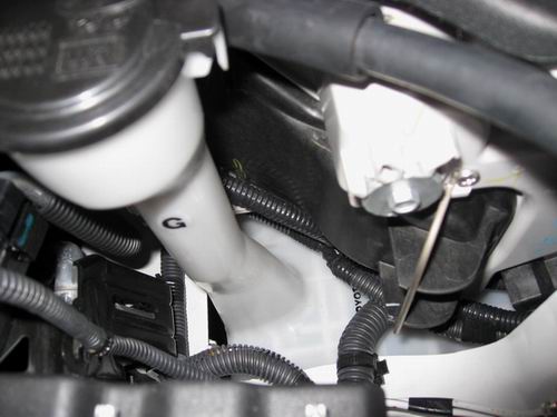

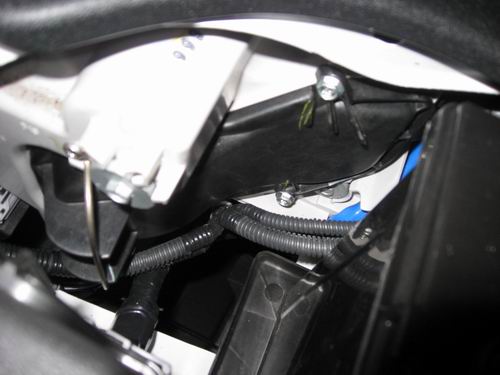

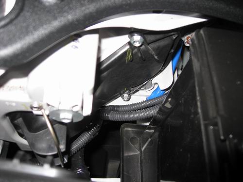

O'k, I have managed to take a couple of snaps of the rear of my headlights. Two of the right one and two of the left. You can clearly see the spring clip and the two bolt/screws, on the left hand one. Regards...........Dixie.
