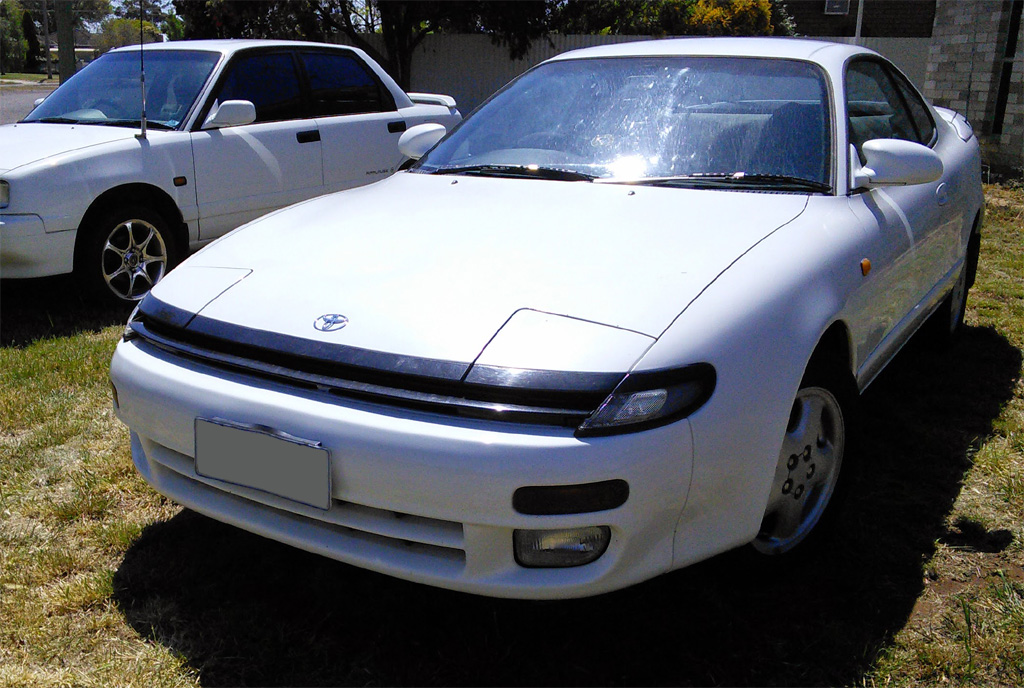

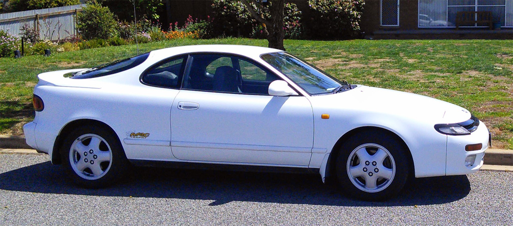

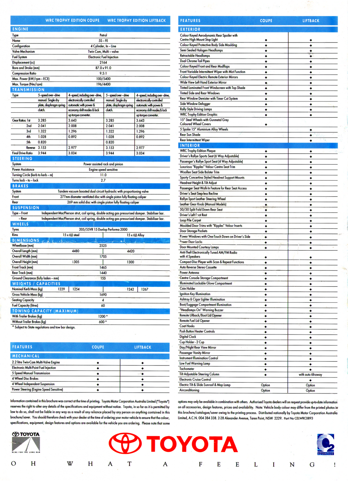

  6. I did some googling, and have been unable to come up with a number on how many of the ST184R Celica "WRC Trophy Edition" were built. I know it came with the works, See PDF: https://drive.google.com/file/d/0B3x2Uh7JTgf_TGI1cThlcEFOVHM/view?usp=sharing As the above PDF says, it is a special build to celebrate the Celica winning the WRC., but it does not say how many of this "special build" they made. any ideas?
