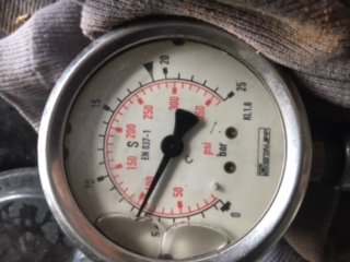

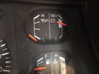

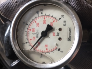

Regular Member

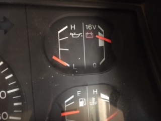

  1. I have installed a genuine $165 sender which made no chance. I haven't put a multi meter on it yet but earthing the lead at the sender sends the gauge to the high mark. I will keep working on it and post the results.
