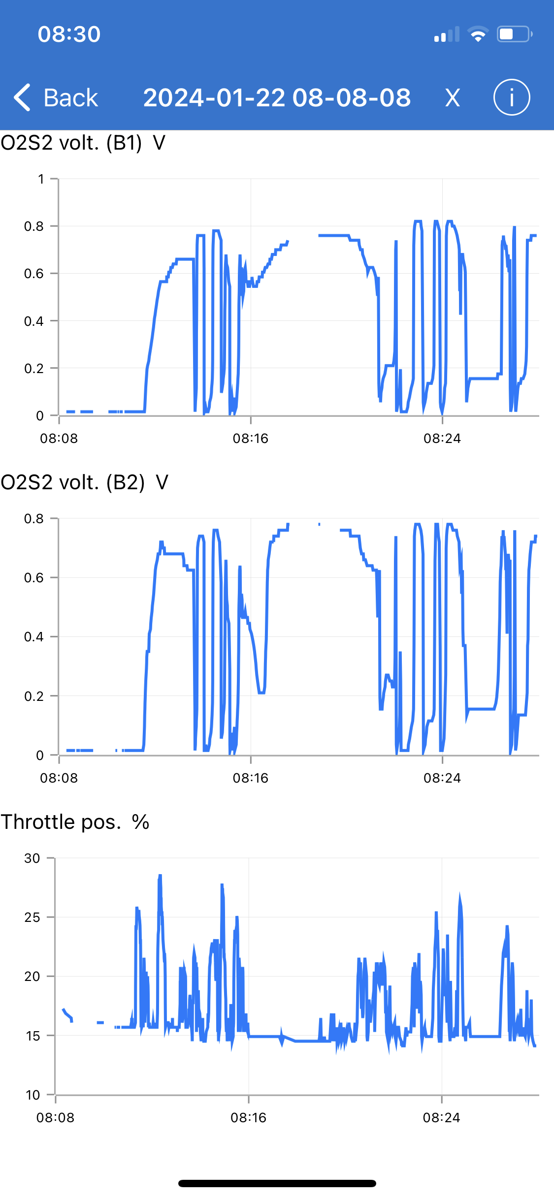

Both pre-cat sensors stay around 3.3v
Post-cat voltage fluctuate between 0 to 0.8v. I attached the graph below along with throttle position.
From this post https://mechanics.stackexchange.com/questions/50101/02-sensor-displays-constant-3-3-volts-not-a-jagged-waveform-2002-rav4
It appears my post-cat sensor reading may indicate a failed catalysts? There is no check engine light come up.
I'm wondering how likely the cat converter is going to fail?
Some symptoms I can relate to is the car always have strong fume smell when start in the morning, but back to normal after warm up.
