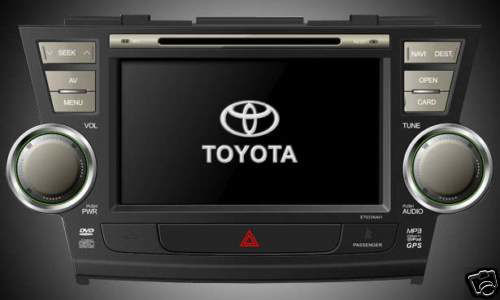

  1. Ham Did you ever get your Fly Audio unit installed in the Grande? Kind regards Hado Yes I have been using it for some time, although I would like to get the IGO8 installed. The TPMS works well but I needed to change the phone MIC for the one supplied. All the steering wheel controls work except for the voice activated phone list (I did not use it anyway, mine was very temperamental). The rear camera needs to be changed and I have not chased that up yet, a few problems with my installer. I find the IPOD selection a little difficult as it shows songs as well as playlists but the sound is good and I use it all the time. For those who asked if it suits a brown interior the answer is yes I cannot tell it was not designed for the car and colour, seems one colour suits all. Regards Ham
  2. Hi Whofan, The Fly Audio unit is not the same as the OEM. I have changed my OEM for the Fly Audio system the only thing that dosen't work is the voice activation but that was pretty silly anyway. The extra functionality I get is worth the loss. Regards Ham

  10. Hado, I have a couple of questions. 1. Can the reverse camera be played through the main unit as the brochure shows the picture being shown through the trip computer screen. 2. Is there full function with the steering wheel controls, on the Grande there is the volume, mode (switching between Radio and CD), channel up and down, phone on/off and voice activation. 3. connectivity to existing plugs. 4. Does the facia come in brown to match the beige interior colour. 5. Where does the Ipod connect. 6. Are there detailed fitting instructions with the unit, for possible DIY. I love the idea of a possible club bulk purchase and subject to a little more detailed information I would be very interested, the FLYAUDIO seems to be a better unit than the CASKA. Regards Ham
  11. Hado, I was wonering if it was the same as the unit on ebay http://cgi.ebay.com.au/Toyota-KLUGER-09-Di...id=p3286.c0.m14 Rgeards
