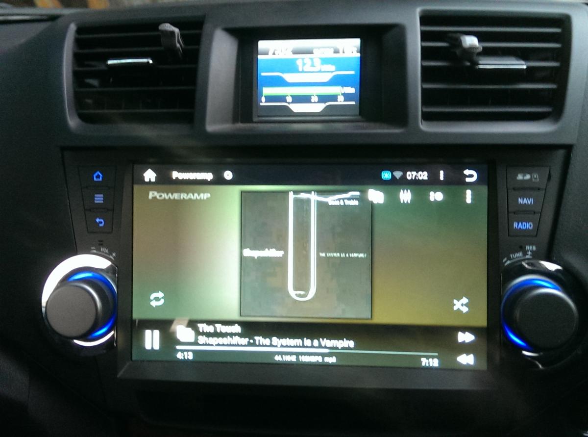

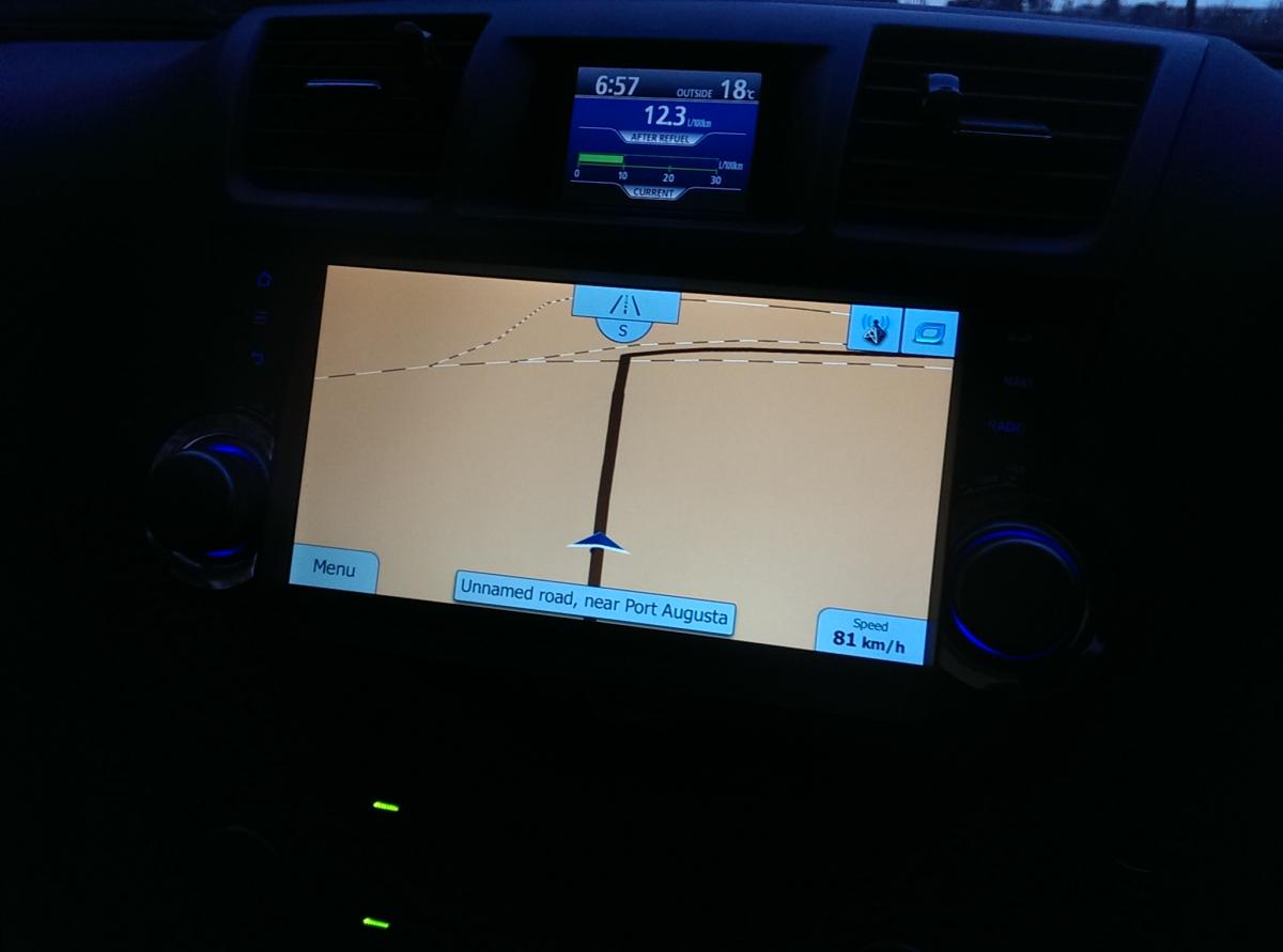

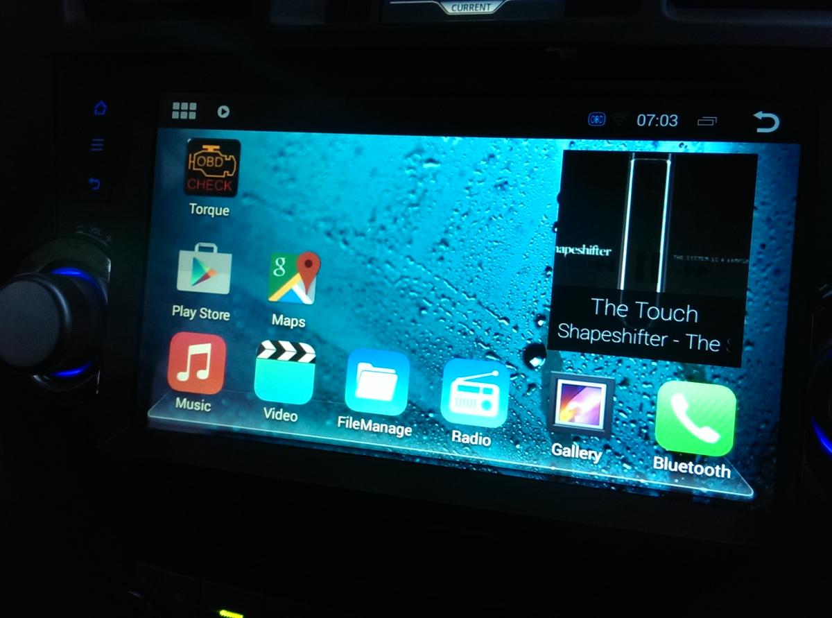

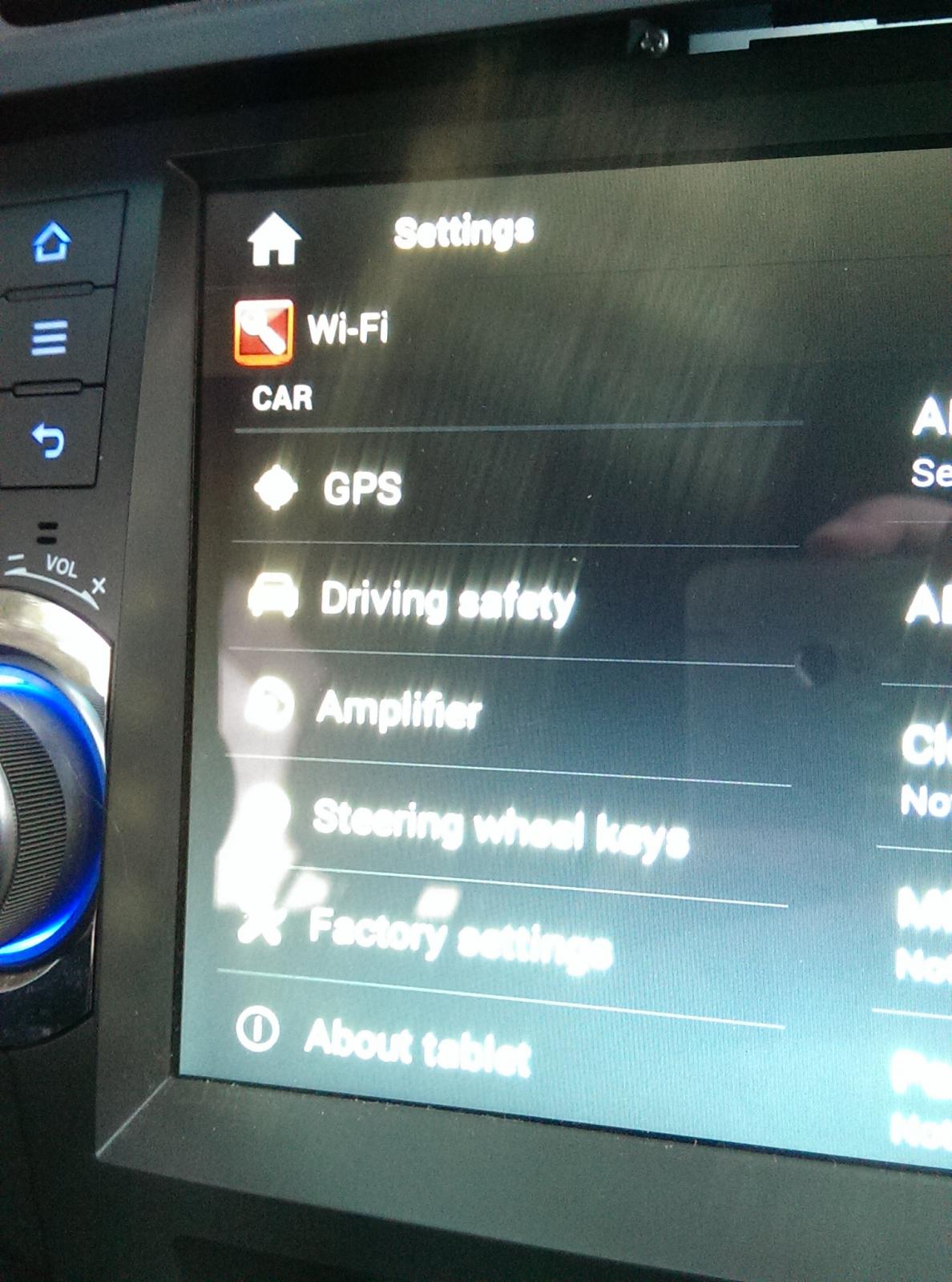

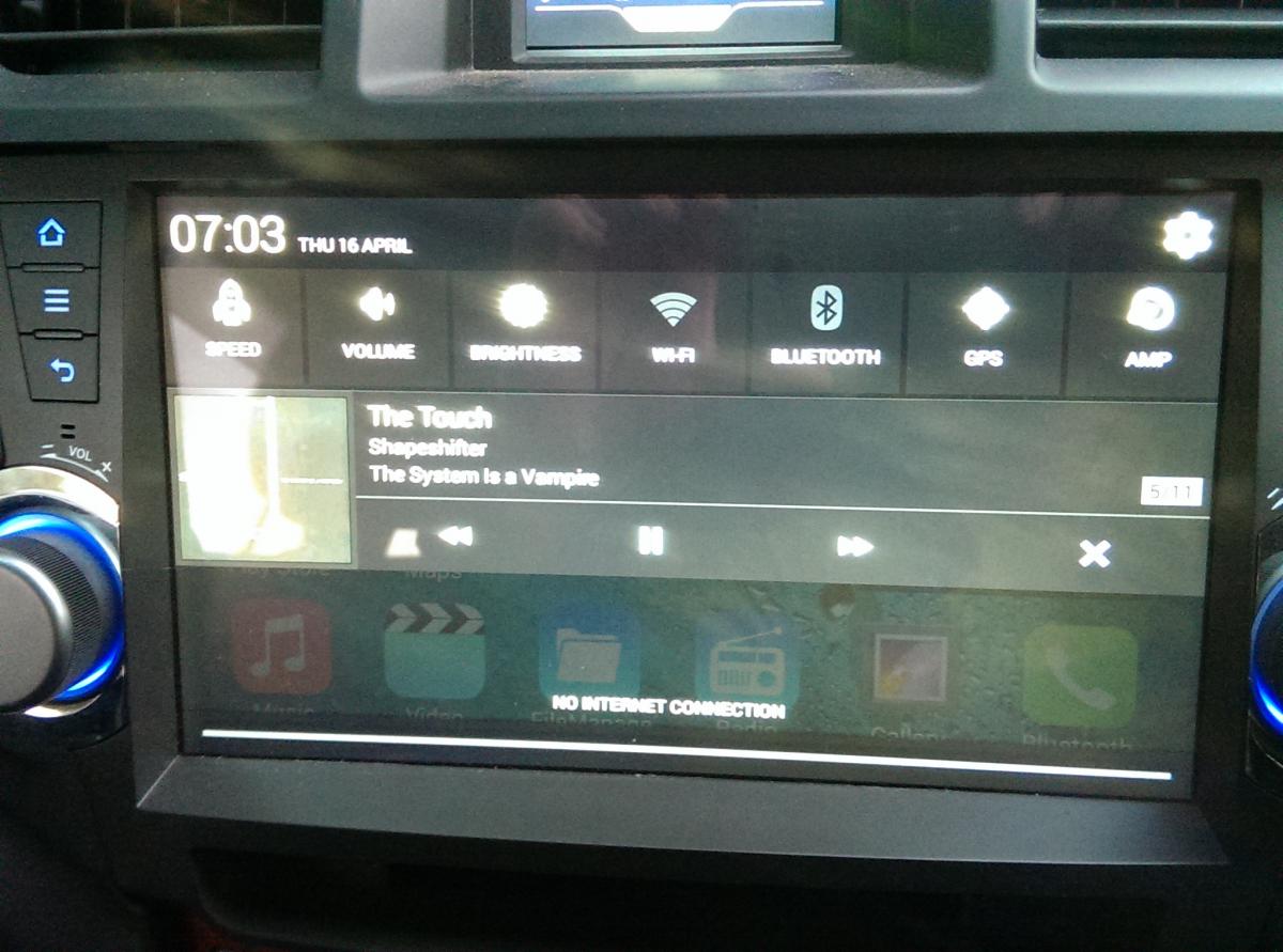

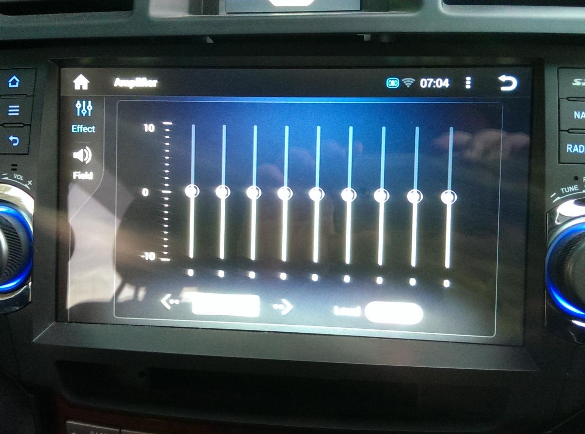

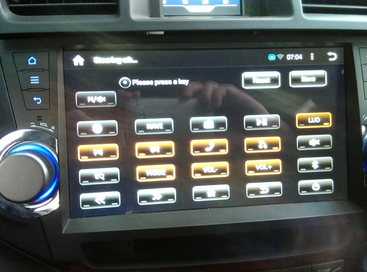

  2. Not the best quality, but they should be good enough. Please note that the dash panels haven't been clicked back in place because I'm hoping the hazard switch assembly will arrive soon and I'll need to pull it all out again to install that. But you can see how the top right edge of the unit doesn't sit flush with the dash, this is the good enough part of the install when I needed to redrill the mounting holes in the factory cradle to suit the incorrectly placed holes in the head unit. First pic is the pre-installed Navigation software, iGo. Second is the music player I currently use, PowerAmp. This player has an amazing equalizer which really comes in handy in a situation like this. Third is the home screen with a PowerAmp widget. Fourth is the notification pull down screen. This is the steering wheel controls screen where you assign buttons to their commands. So you can make any button (related to the stereo) do any of the shown actions. This is the built in 'Amplifier' screen, which is just a crappy equalizer and the balancing (front/rear, left/right fading). This shows part of the settings screen. If anyone wants to see anything specific just ask and I'll see what I can do.
  3. It does dim a little when you put the lights on. But it depends on what app you're in to be able to answer your question. Didn't try the navigation program (iGo is the one it came with), but I think it just changes to a darker colour palette. But just like your android phone, you can change the brightness level. I'll try and remember to put up some photos in the next day or two.
