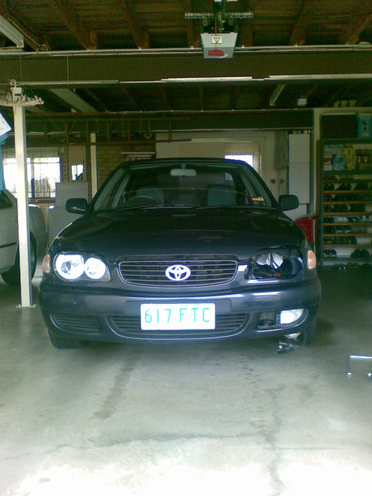

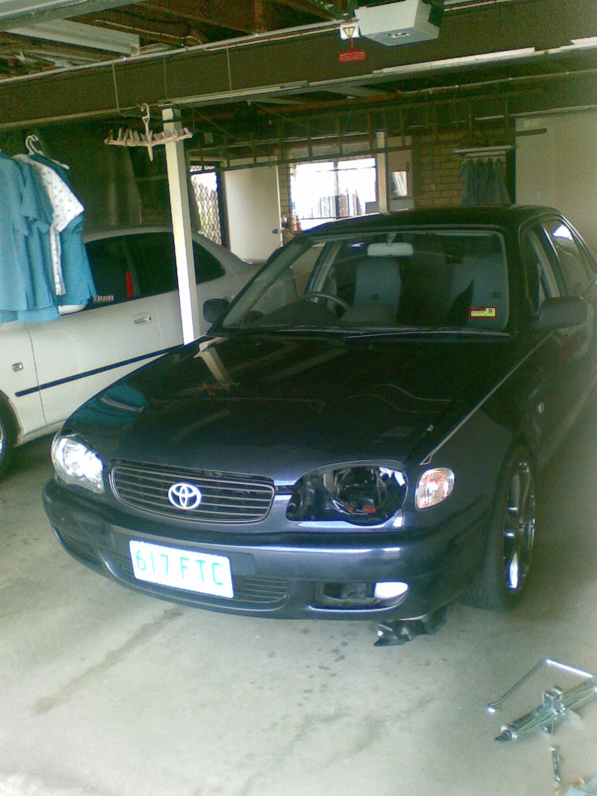

Intake air-temperature sensor, if you're going to get decent cold air from the intake you need to plug it back in, otherwise the ECU will be seeing a different temperature to what is really entering the engine (ECU uses manifold pressure, throttle position and air temperature to work out mass air flow into the engine and thus how much fuel to inject).
Take a look at my photos, you can see the sensor and bung plugged back into the pipe about 30cm before the throttle body, just drill a hole in whatever pipe you end up using and pull the whole sensor, plug and rubber bung out of the airbox and insert into the new hole.

No, windscreen washer bottle is on the other side of engine bay this one is directly under the battery on the side the factory intake is the plastic box is empty, is this the intake resonator. if you look at posts in this thread it has pics of their car Cai done and where the pipe goes in under the fuse box next to the battery there is an empty plastic box under, can any one tell me what it is and whether it is the intake resonator, the box doesnt appear to be connected to do anything
It's an intake resonator, it connects to the underside of your intake snorkel just behind the battery underneath the fuse box - you remove it and the snorkel (as well as the airbox etc), and use the resulting hole in the guard to run your CAI pipe through. If you look at my photos you can see the hole just behind the battery where the pipe runs.
