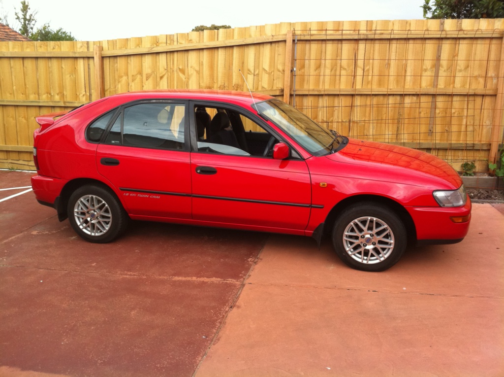

By the way, i got some second hand wheels for the seca, the ride looks awesome, take a look guys.
