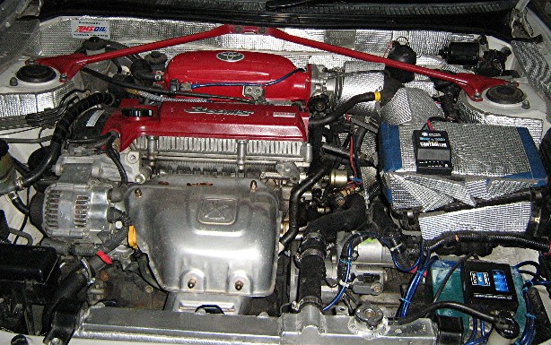

Engine Bay - If you have a noisy motor the foam I use is very good. I have partly stuck some on like a skirt behind the engine. I have a photo attached of my engine bay...You can see in the 2nd photo I have this foam stuck on my airbox. That is to stop air intake noise but also to keep my air intake cooler and help stop it heating up from the engine
