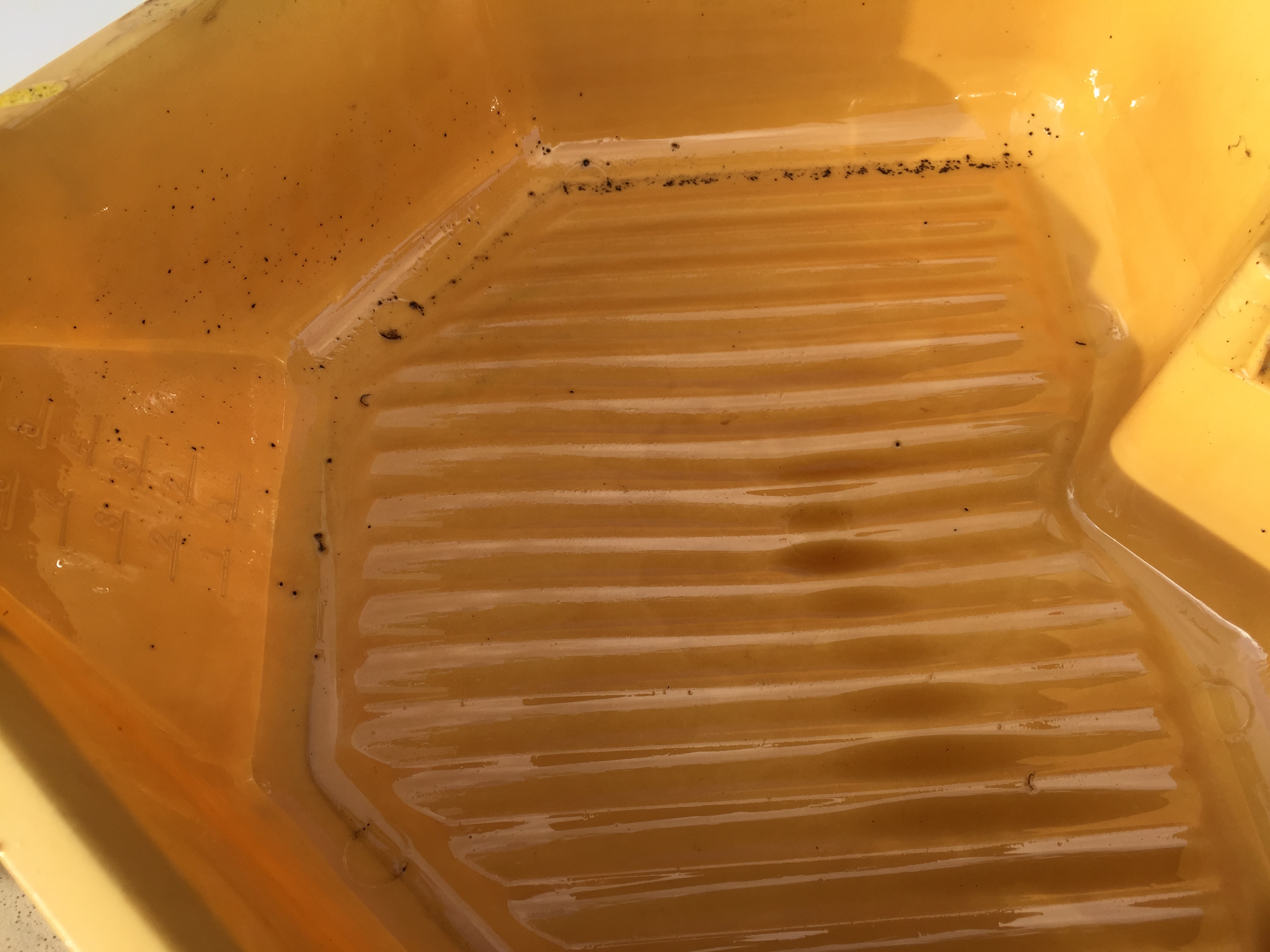

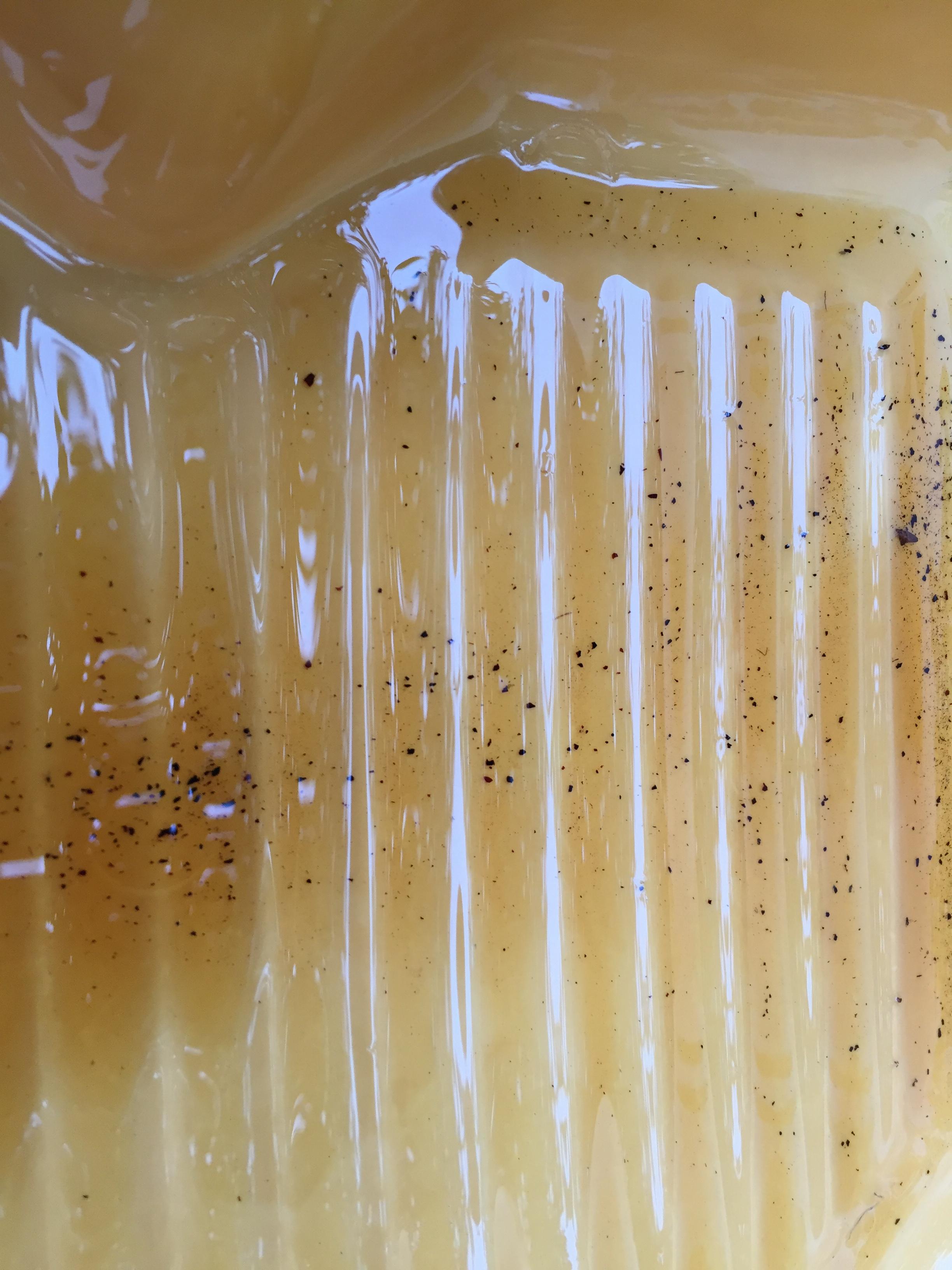

I cleaned the oil filter cartridge and housing of any sludge particles, dropped the used engine oil [about 1 month old] then did an engine flush with 6 litres of diesel.
Following photo shows the results. Cleaned the oil filter cartridge and housing of any sludge particles, dropped the diesel then filled with new oil and performed the Penrite engine flush.
What I did notice was while the engine was running during the Penrite engine flush, the engine was idling a lower revs approx. 600 instead of the usual 700. Guess this is the effect of the oil being thinned during the treatment. After photo does show sludge particles and the oil was not too badly contaminated.

Not raIning yet, so I did a follow up comparison adding the Penrite engine flush to the used engine oil after the engine had been warmed up and idling for at least 10 minutes. As expected, the oil was quite a dark colour after the flush and has been discarded. I then did the diesel engine flush and also idled the warmed up engine or at least 10 minutes. Surprisingly, there were slightly more sludge particles for the diesel flush than the Penrite flush [highly similar to the previously posted photos] .
Only conclusion, I am prepared to draw at this stage is that a 2nd engine flush does produce results.
