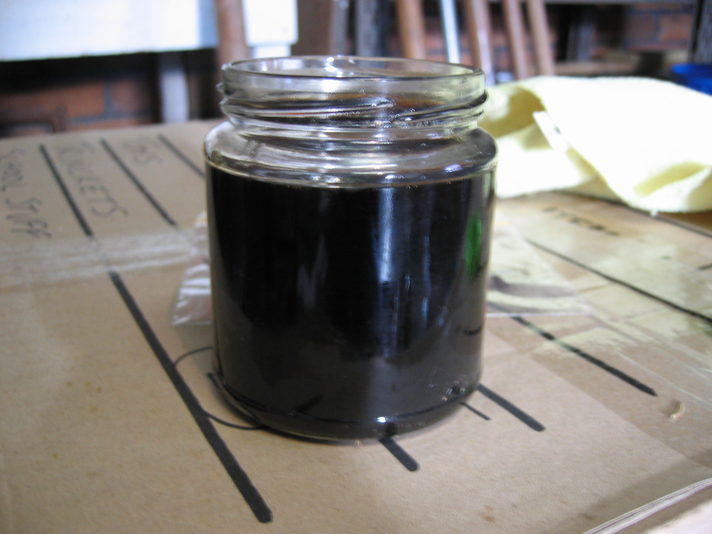

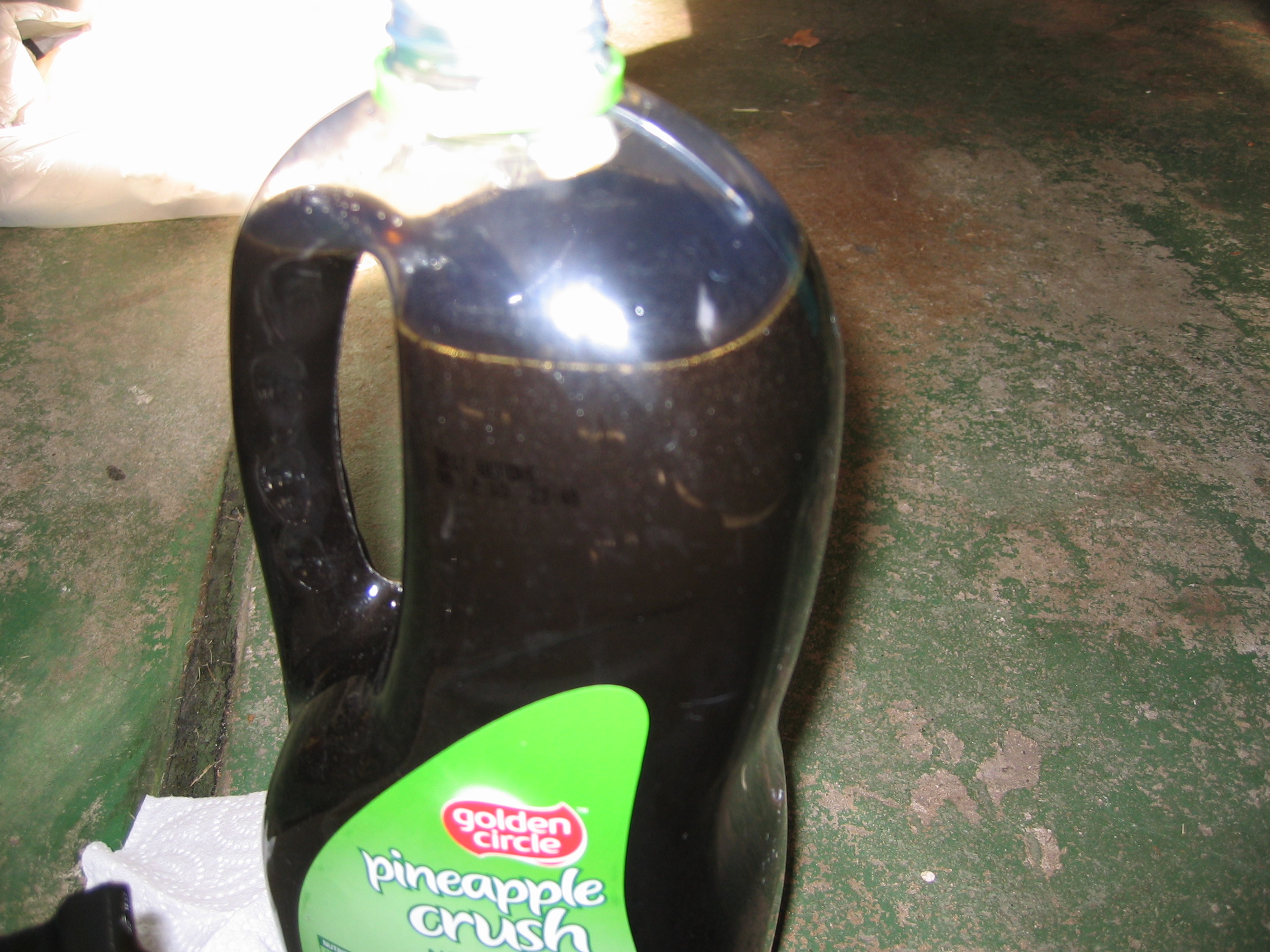

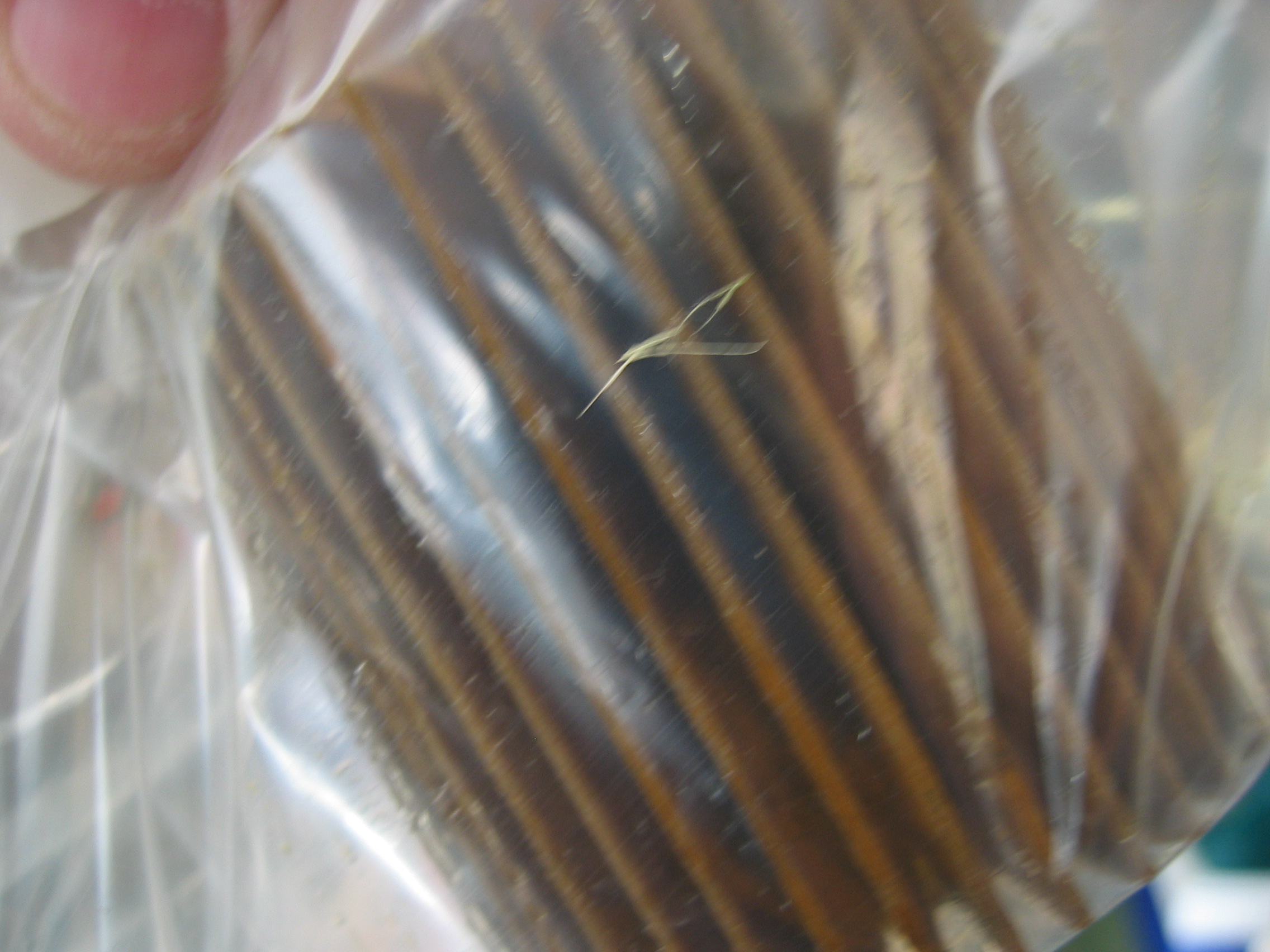

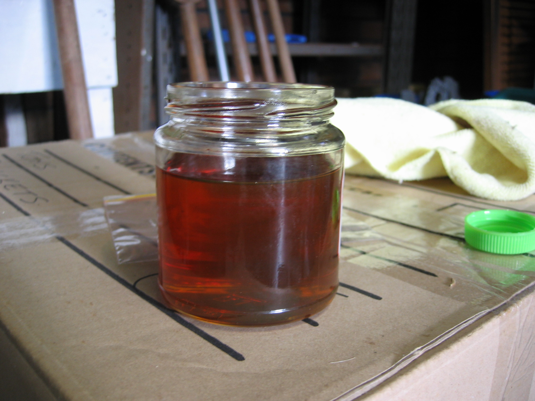

  3. So the big meeting with the dealer took place today. I took in all my samples etc. to the Customer Service Manager. The official line from their mechanic is that he changed the oil and filter as per the normal service then filled the car with their standard oil. After refilling he realised I had my own oil so drained only the sump (not the filter) and refilled with Mobil 1. The problem with this story is that the volumes still don't match as the oil filter holds 0.4 L and they used 5.7L of my oil (pressuming they didn't just tax the first bottle) so 6.1L in total. But the car was over full and we drained close to 6.5L out of the car. Plus the colour was not 2 day old oil. Plus the filter looked old. I'm still not sure what was done but admitting you did something dodgey is enough for me to not believe anything else. Also I left the oil on the front passenger's side floor in clear view so you would see the oil when driving the car in and it was written on the work order. They have also admitted their mistake regarding the fuel injector cleaner. There were a number of other small issues that show a general lack of care but I can't really be bothered listing them. They agreed to refund what I paid for the service and the cost of my oil. They also agreed to replace the oil housing removal tool and a cabin filter that wasn't cleaned or inspected as was claimed on the service. The Customer Service Manager was more than helpful and very interested in trying to get our trust back but since it was going to be my last service with Toyota anyway it's a moot point. I'm glad to know my instincts were correct. :)

  5. Thanks for all the replys. Glad to know it's not just me who thinks this is shocking. The dealer didn't seem that surprised just suggested bringing it back in to get it changed again. I would have gone straight back in the next day but the problem is the dealership is only open during the week and I need my car to get to work. I took a day off especially for the service and couldn't afford to take another day off. We had a tripped plan for the weekend and no way was I leaving that **** in my car so I had no choice but to drop the oil myself. I let the dealer know I would be changing the oil myself and bring him in the samples. He said he'd be very interested in seeing them. Not really sure what that means. They did the previous service on the car too so they can't blame another delaership for over torqueing the filter housing unless they didn't change the filter at the previous service too. <_< I plan on writing up a letter with photos for toyota aust regardless of the outcome from the dealership. I also have another more minor issue with this dealer and my front brakes that they are following up with toyota aust for me. They claim the discs need machining but they were machined by another dealer 10 000kms ago and the pads really aren't that worn to be causing damage. When I explained the discs had just been machined recently the service manager implied that by the look of it he didn't think they had been done by the other dealer. Not sure who is lying here all I know is that I paid for discs to be machine 12 months/10 000kms ago and now I'm being told they need to be done again. Guess I'll need to service the brakes myself too. I'm not sure about the forum rules and naming dealerships with liability etc.

  7. Further to my short post in another thread I was wondering what other forum members think my best course of action is in this type of situation or if you think I'm being paranoid and there is some other explanation. I recently took my Aurion in for it's 45K service. It was my last service for the car under warranty and I plan on doing my own oil changes from now on. I called the dealership and asked them if it was ok to bring my own oil and they said sure plenty of people do that. So I left the car with them for the day along with 2 x 5L bottles of Mobil 1. I picked the car up and was given back one bottle with about 0.6L gone from it so including the other bottle that's 5.6L they have used. I figure that's fine they just underfilled it slightly. I got up the next morning after having the car parked on a flat surface to find the oil level on the dipstick close to a cm above the full mark. I also noticed the oil looked darker than I was expecting on the dipstick. I called the dealership for an explanation and he mentioned maybe they just didn't let the sump drain long enough and to bring the car back in. Now I'm not game to let them touch the car again. So the next day I decided that something was up. The colour was wrong, they didn't use enough of my oil and the dipstick was over full. I purchased a new genuine Toyota filter and their filter removal tool to do the oil change myself. I changed the oil myself and I am now convince neither the oil or the filter had been changed by the dealership. What I think has happened is that one of my bottles of oil has disappeared and then the second bottle has been used to top up and over fill my car then the remains of that bottle returned to me. The oil that came out of the car was very dark. It looks like oil that has been in the car for 6 months not 1 day. The total volume I got out of the car was very close to 6.8L. The filter housing had been over torqued beyong belief. I destroyed the filter removal tool getting the housing off and nearly dislocated my shoulder. That filter had been on for months and the filter paper inside looked quite old. I wont mention the name of the dealer but feel free to PM me. BTW this was the same dealership that told me it was ok to use diesel injector cleaner in my Aurion. I've attached some pictures of the drained oil and a small jar of the original Mobil 1 for comparison.

  12. Thanks for checking. A couple more issues have come up and now this has made me really doubt this dealership so I'll be heading back in there tomorrow. A bit off topic but I thought I better check my oil level the day after the service was done. The dip stick is about 2cms over full which is bad enough by itself. Now what is weird is that I took my own synthetic oil in ( 2 x 5L bottles) and recieved back one bottle with only about 0.5L gone from the bottle. So they essentially used 5.5L but the car takes 6.1L and somehow the oil is overfull. I now think the oil filter wasn't changed. To add more to my theory the oil already looks brownish rather than the normal honeycombe colour it usually looks for the first few weeks after a service. I was very close to changing the oil myself but this was my last service under warranty and since it was capped at $130 I thought i might as well let them do it. The dealer asked me to bring the car back in but basically all the trust is gone. So I'm now going to have to change the oil myself tomorrow morning and then I'll take the evidence to the dealer and request a refund or credit. I plan to take photos and send a please explain to Toyota Australia. I love Toyota cars and Toyota Australia but like so many good car companies they are often let down by their dealers.
