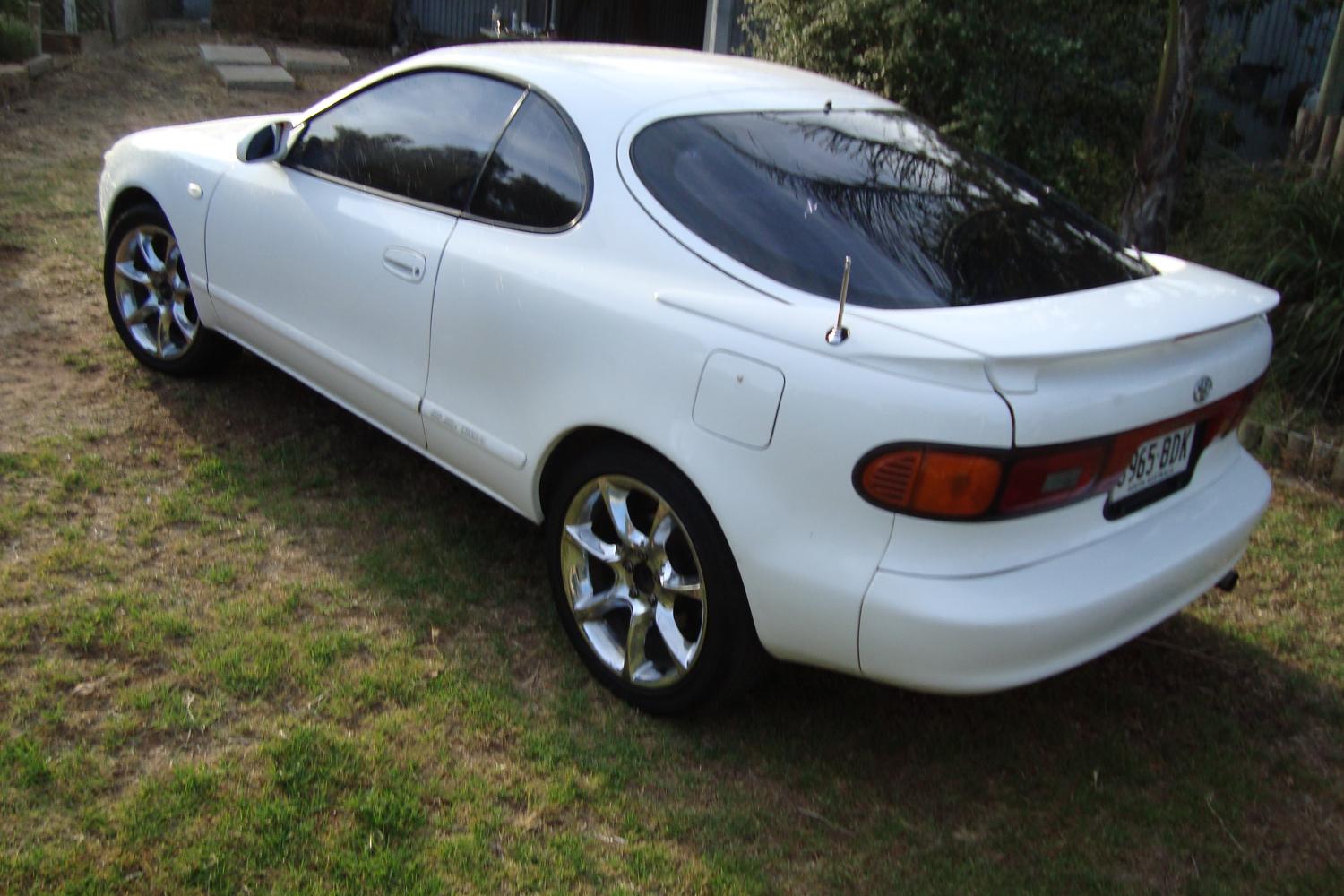

Toyota Celica SX ST184R, here is my celica I purchased privately for $500 an absolute bargain, and is a hobby to fix up where it needs and love cruising in it.

hey guys, I have been working one my 1991 Toyota Celica ST184R SX which I purchased for $500 3 months back... this week I got a new temperature sensor for my radiator which got my fan working finally! so it's all good to drive, I also picked up myself a set of Veloche wheels 215X45X17, so 17" inc wheels. they fit very well however I will need to replace 2 of the tyres as theyre bald, so also I will be having lower profile front tyres on the front as compared to my rears I plan on running a 205x45x17 on the fronts so my speedo isnt out and I dont need to get it recalibrated I just did the research and if I keep the same profiles as whats on it, I will be traveling aprox 5km faster then my speedo says eg. speedo reads 95km when I will be doing roughly 100kmph, also will be getting a wheel alighnment. then next on the cards will be a new exhaust tip I would like to stay away from getting a cannon and would prefer to get a oval dual tip muffler to still retain the meety note my full 2.25" exhaust system. come early feburary this project will be getting closed to complete. down the track I will be seeking a Carlos Sainz bonnet, and maybe body kit could be on the cards aswell. I will keep updates on this project, and my main goal is to have a sleek looking celica which could be good as a show car, and meets, also I have no intention of making it more powerful so an engine conversion isnt on the cards. it would be cheaper to just sell my car and get an st185. thankyou for reading if you have any tips or sujestions let me know. :D
