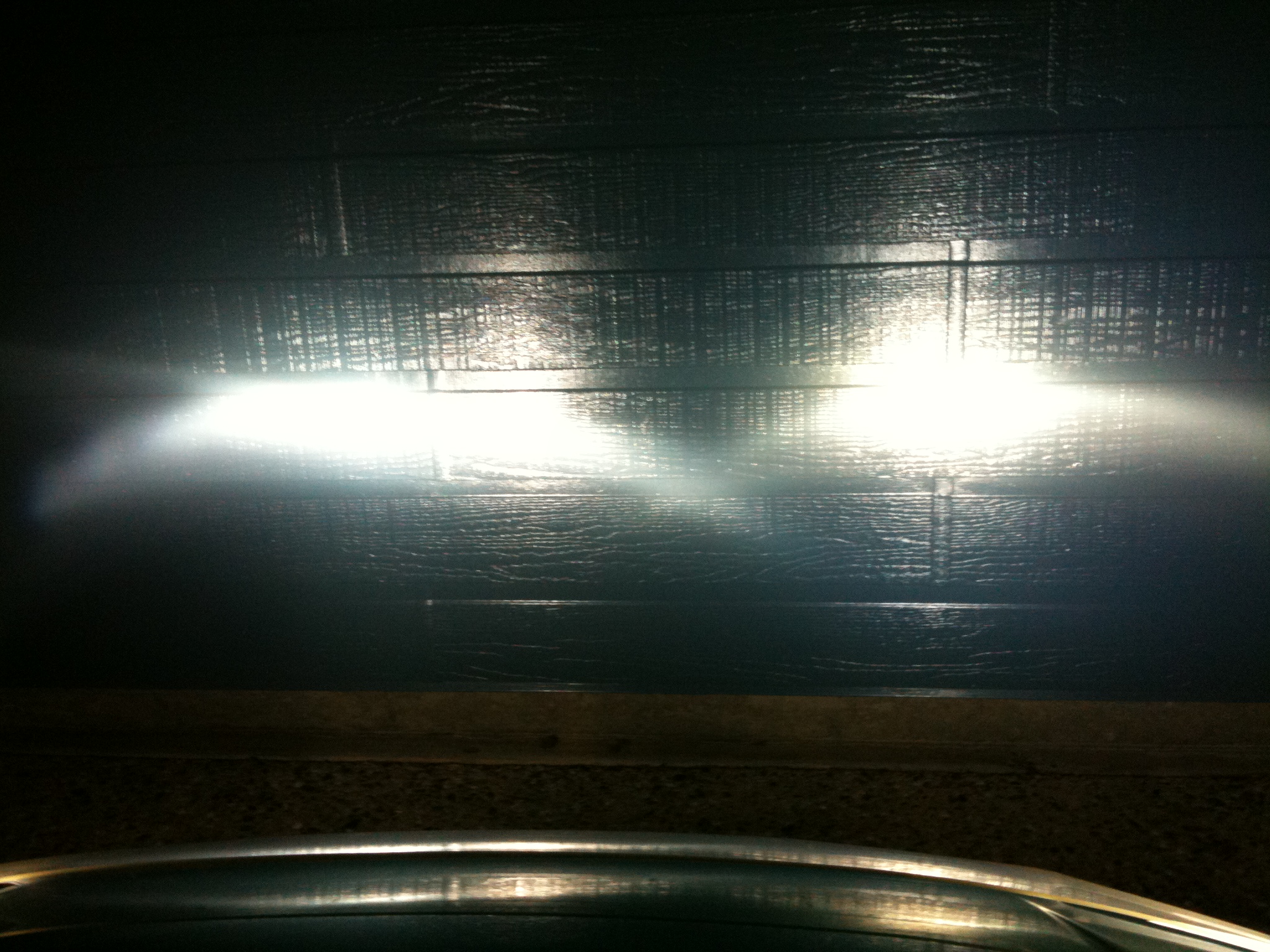

My drivers side headlight seems slightly dull in comparison to the passenger side headlight (see attachment), it also gives a different shape bright spot when parked near a wall.
Does anyone know why one would be dull and the other not? I have looked at the reflectors as best i can without pulling the headlight apart and it looks to be in good condition and also it has HIDs so wiring is not the issue as it was dull before and after the conversion(It wasnt one of those cheap and nasty HID kits, there is no glare for other road users :) )

P.S. the photo doest make it look dull, but there is a noticeable difference when driving and also when looking at the light on the wall.

I had a mechanic look at the reflectors today and the right reflector, while it looks good, is not in fantastic condition, so i will need to get a new headlight assembly at some point.
