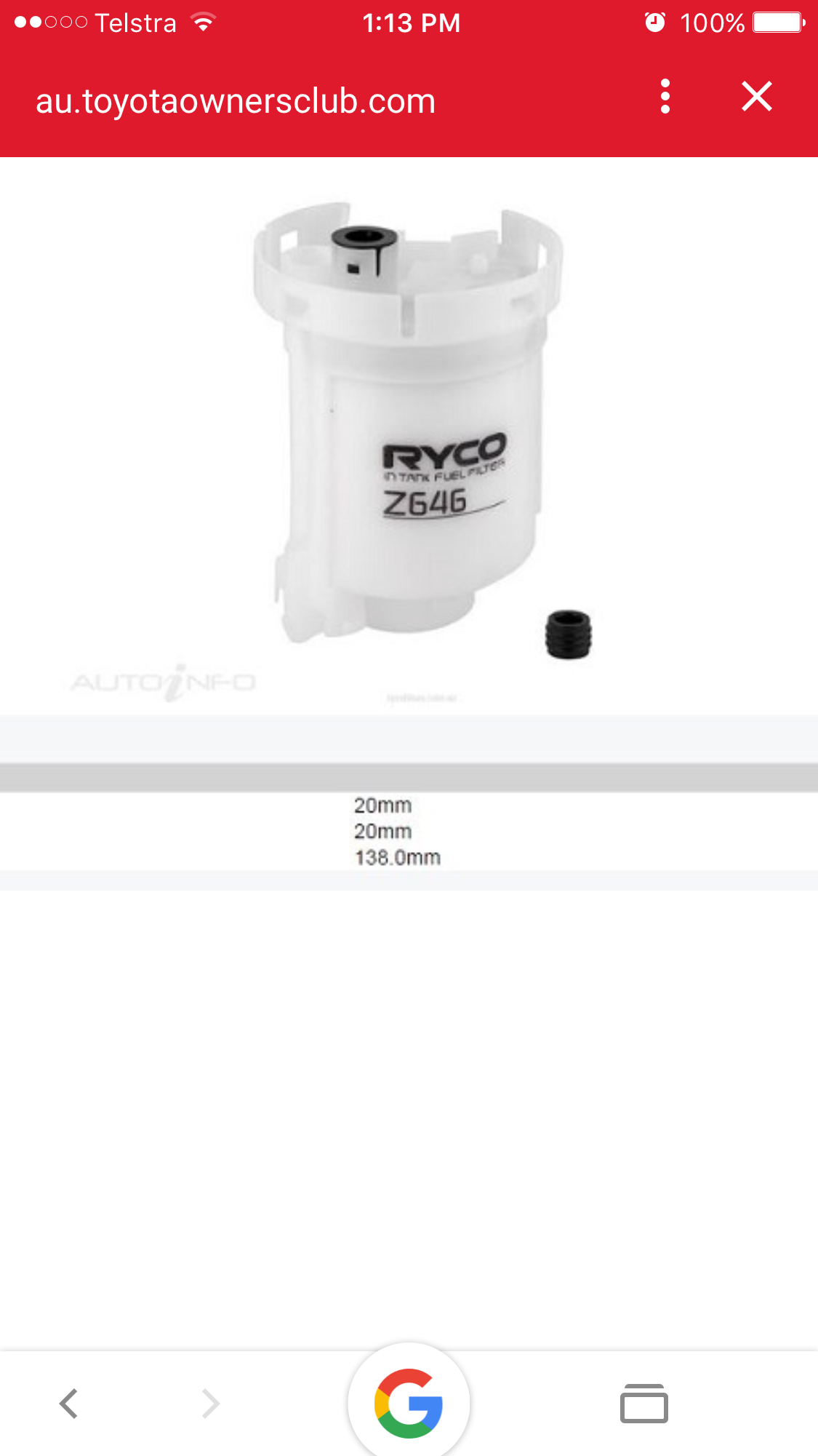

Hi there guys I changed the fuel filter on a 2003 Camry 2.4L with a Ryco Z646 filter now when I got it apart I seen the fuel pump had a oring and a plastic tip on it where it goes into the filter and the new ryco filter didn't come with any new o rings  except for a big rubber bush.
now because it was different I didn't replace the o ring and fitted the fuel pump back to the new filter and put it back in the tank.

now I rang ryco and asked them what the go is and they said the bush replaces the o ring and the plastic tip so remove them and fit the bush.

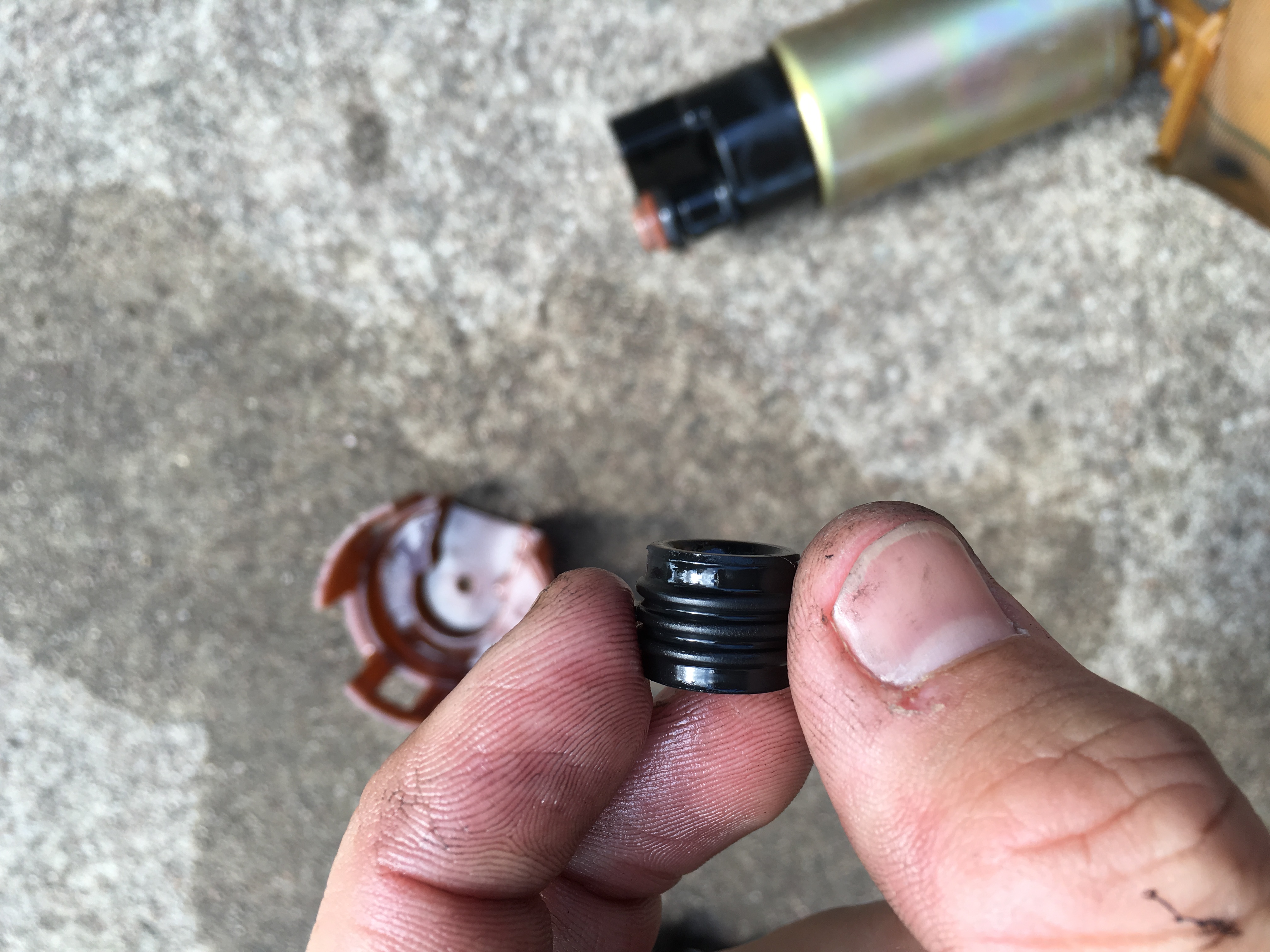

This is the rubber bush supplied with filter

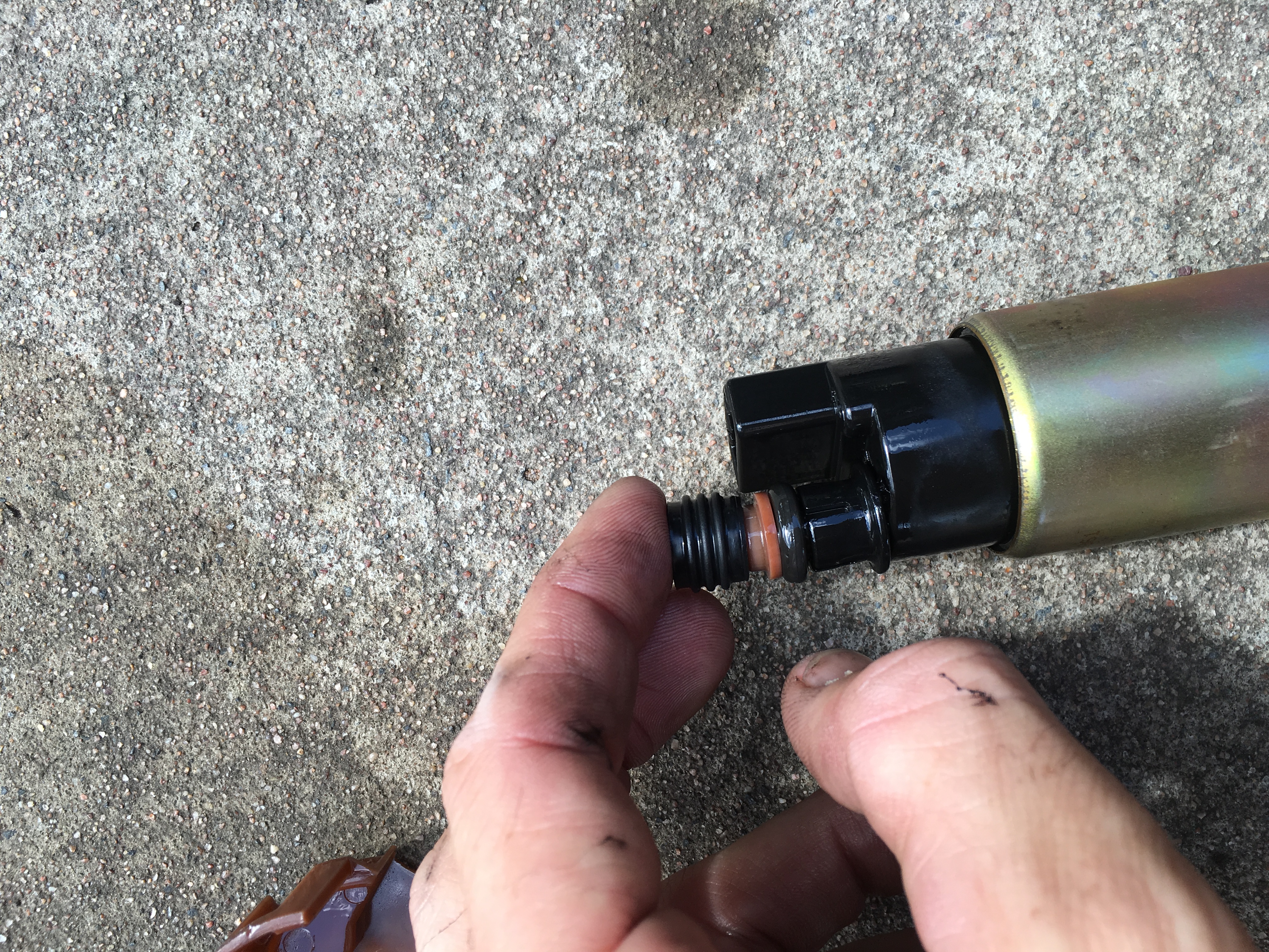

as u can see the fuel pump is different it just has a normal o ring
And it can't be fitted on top as it would be too big so I had to remove the o ring and the plastic tip and fit the bush
As Ryco stated the bush replaces the o-ring. Did you replace the rest of the o-rings?
Yes I pulled the original o ring off and the plastic tip and fitted that rubber bush supplied by ryco with the filter but that's the only one they give you so I didn't replace any other o ring (regulator)

i changed the oring in the pump as shown in above pics but not the reg (that's in the filter assembly) or Dampier what ever it is.

Yes I replaced the regulator o ring with a genuine one, the fuel pump o ring from ryco as supplied with filter (as seen in pic) and that's it
