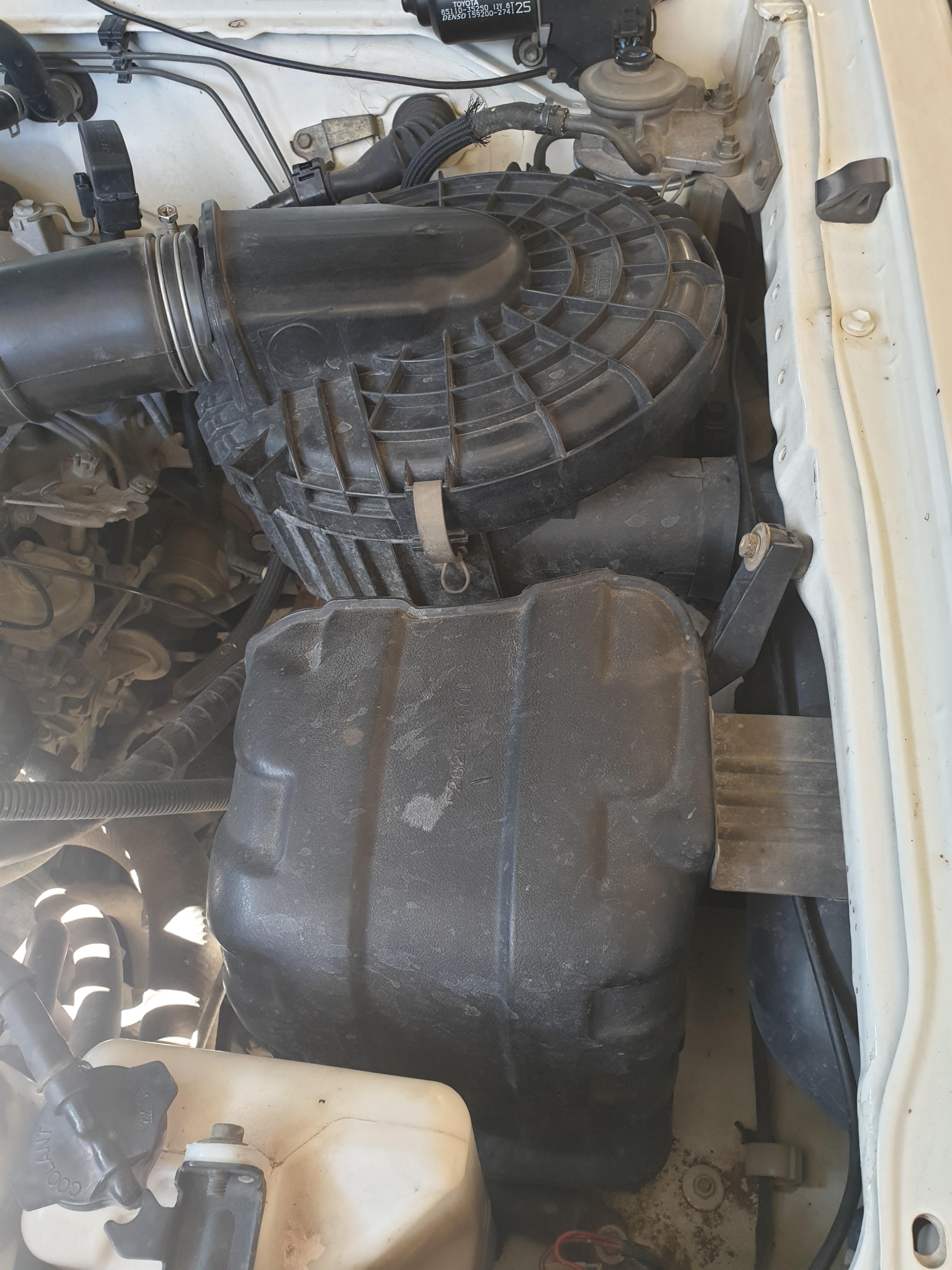

Its just an early version of the intake pictured below. It was put in to reduce intake noise as apparently they used to be pretty noisy. I removed mine to fit a dual battery and I didn't notice any difference in intake noise, although my exhaust probably covered that up. If your want it gone it is perfectly safe to remove as it has no effect on the performance of the vehicle. The only problem is the pipe it joins to will have a hole in it, you can either patch it up to seal it or do what I did and try to track down an earlier model without the baffle that has the same pipe without the hole in it.
