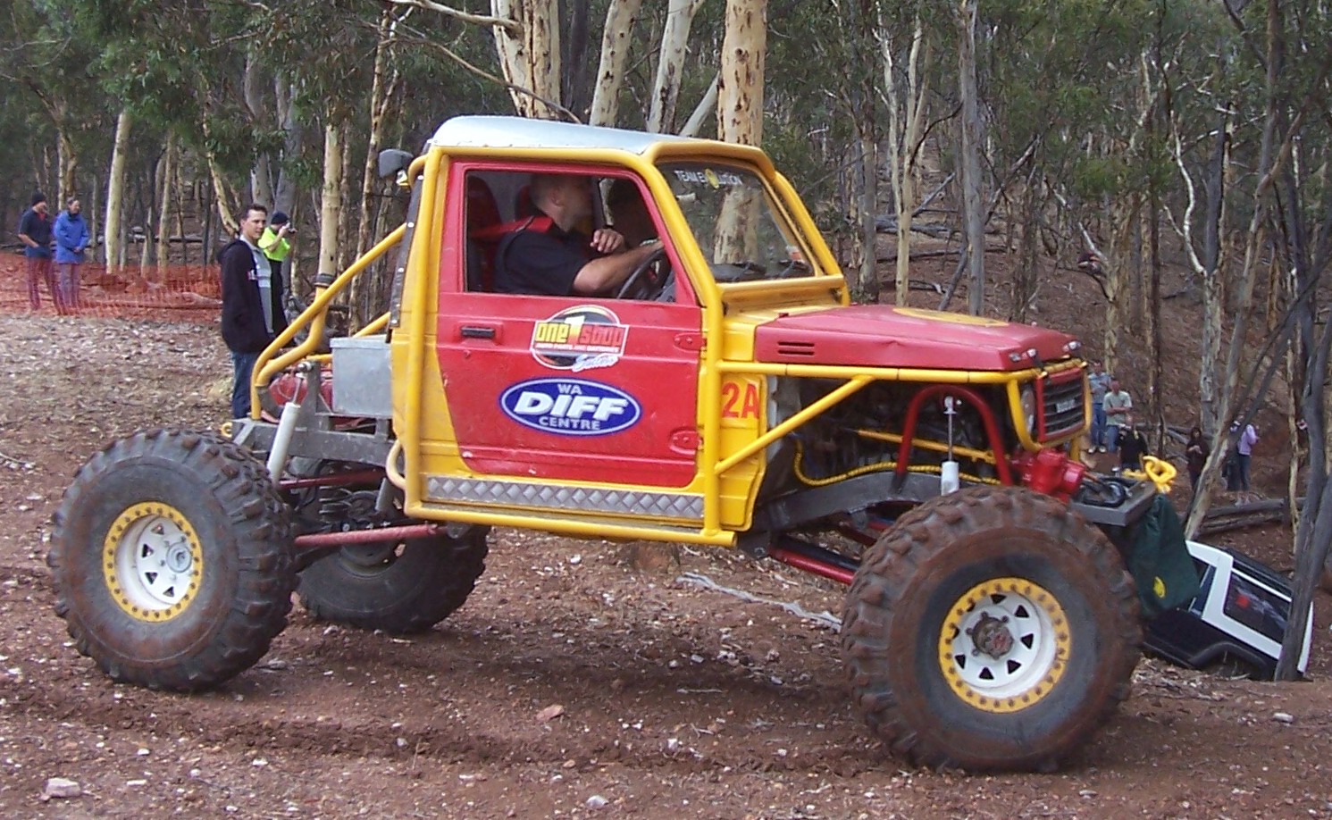

Guys im new to this board and am into 4x4 im competing in WA in a suzuki sieara that has been modified with hilux diffs twin lockers and 38 inch tyres coil suspension with triangulated four links in the front and rear .Looking to run a new engine and gearbox and have been told to find a corona st141 as we want a 4cylinder motor out of a rear wheel drive car that runs injection must be manual.
What are your thoughts about this car how much power dose it produce as it will be left stock for better reliability how much would i pay for a donor vehicle.We are looking for some low down torque but good of the mark sped to spin the tyres as we are running lower transfer case gears and 5.29 hiace centers our first low range comes out at 100 to 1 .
If there are any other motor gearbox combos could you please let me no conversion must be as cheap and easy as possible with ease of parts to get hold of .May use a front wheel drive motor as long as we can bolt it to a rear wheel drive manual box .This set up dosent have to come out of a 4x4 as with a zuk the trans case is seperate and runs a small drive shaft to it from the gearbox
