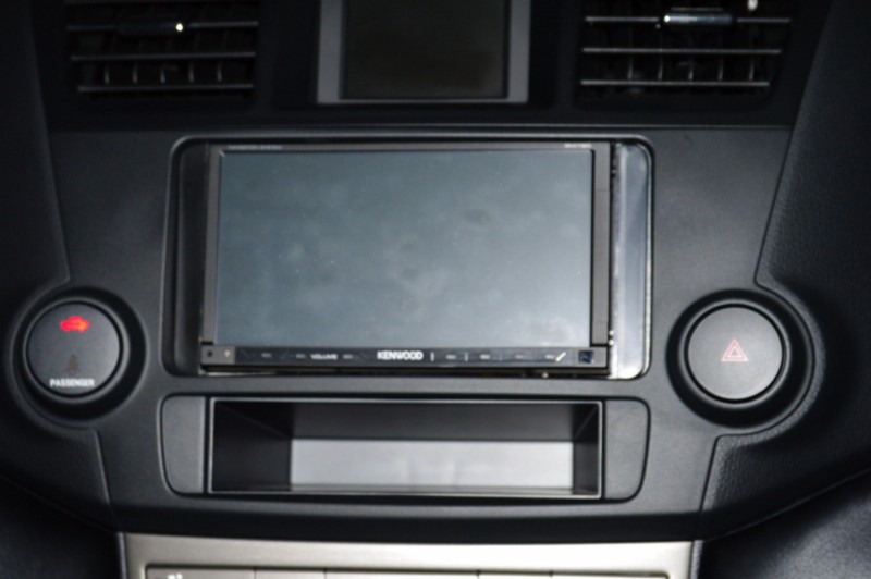

  3. Hi Dazz, any standard double din unit will fit, just need to install spacers either size. A pic of the Kenwood unit I installed in mine is attached. Nice looking unit, what is the model, if you don;t mind me asking. it's a Kenwood DNX7320.
  4. Hi Dazz, any standard double din unit will fit, just need to install spacers either size. A pic of the Kenwood unit I installed in mine is attached.
