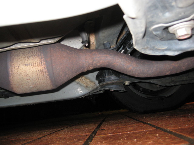

  11. This picture was taken from just behind the driver front wheel. I believe this the pipe we are talking about.
