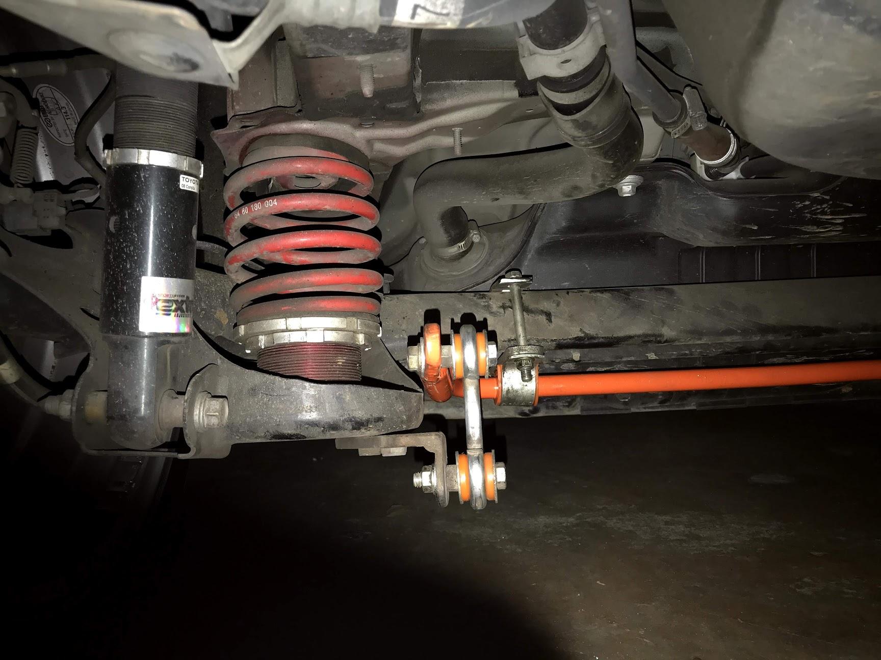

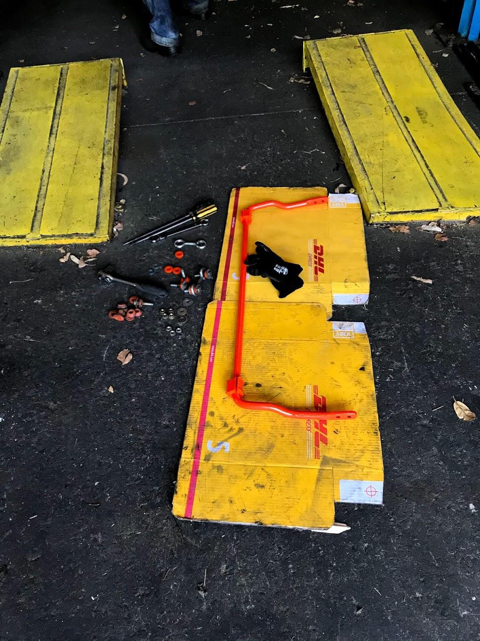

  5. Redo the rear sway bar due to damage by hydraulic jack by some mechanics, it is sprayed in orange so that it is visible. The car bites the corner really good now. The bar is hand made by kmac suspension at rockdale. It has 2 holes adjustable I have done a measurement for front and rear sway bar, 23mm front and 20mm back. The ratio is 20/23=0.87. this ratio is important for fwd cars to control understeer/oversteer That's why it does not have any understeering and little lift off oversteering. For your info, latest corolla use 27.8 front and 24.5 rear , that's why it handles really well. It is really really thick for stock production car

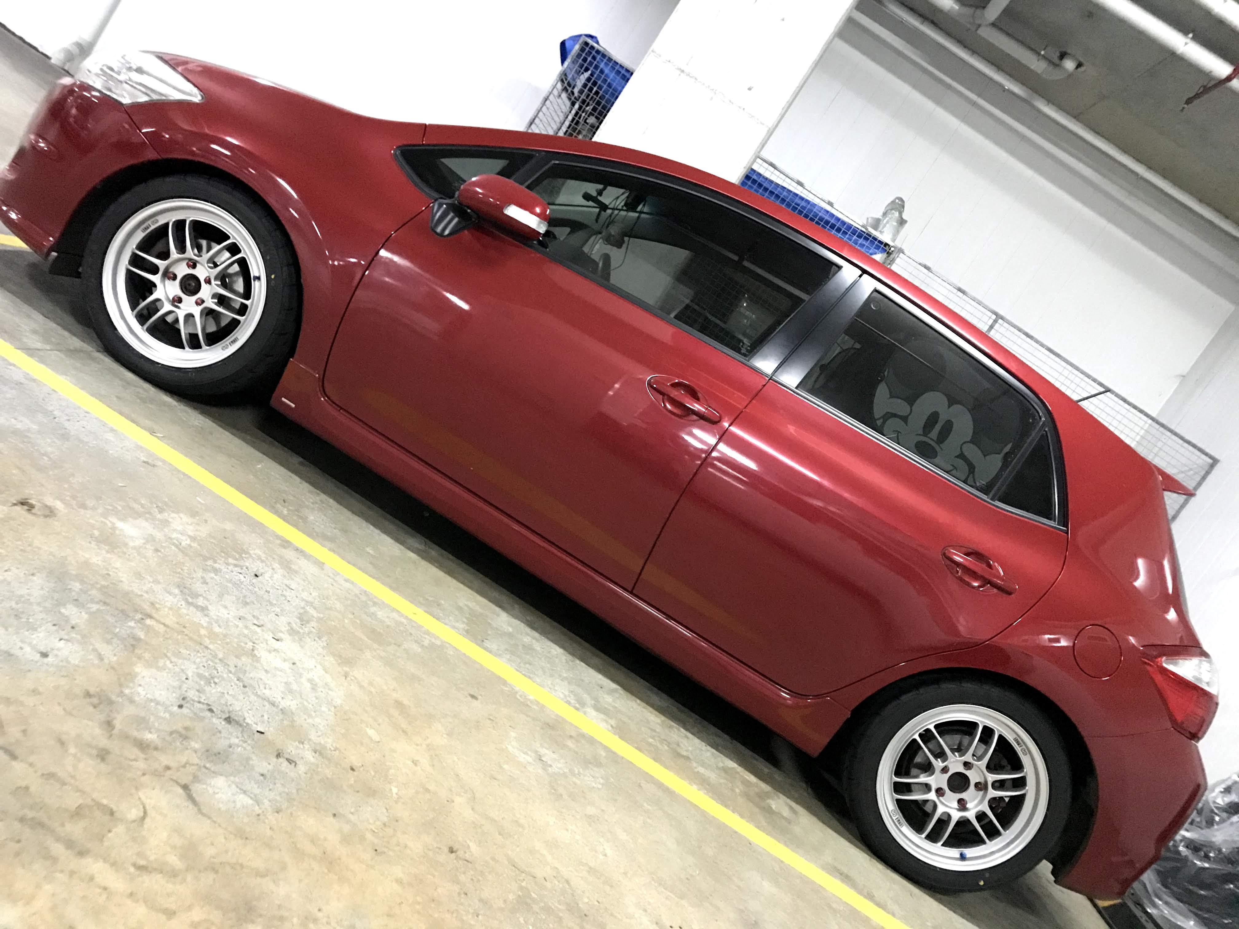

  10. Rpf1 17x7 done. 215/45 bridgestone re003. Light weight wheel and light weight flywheel. What a blast in acceleration
