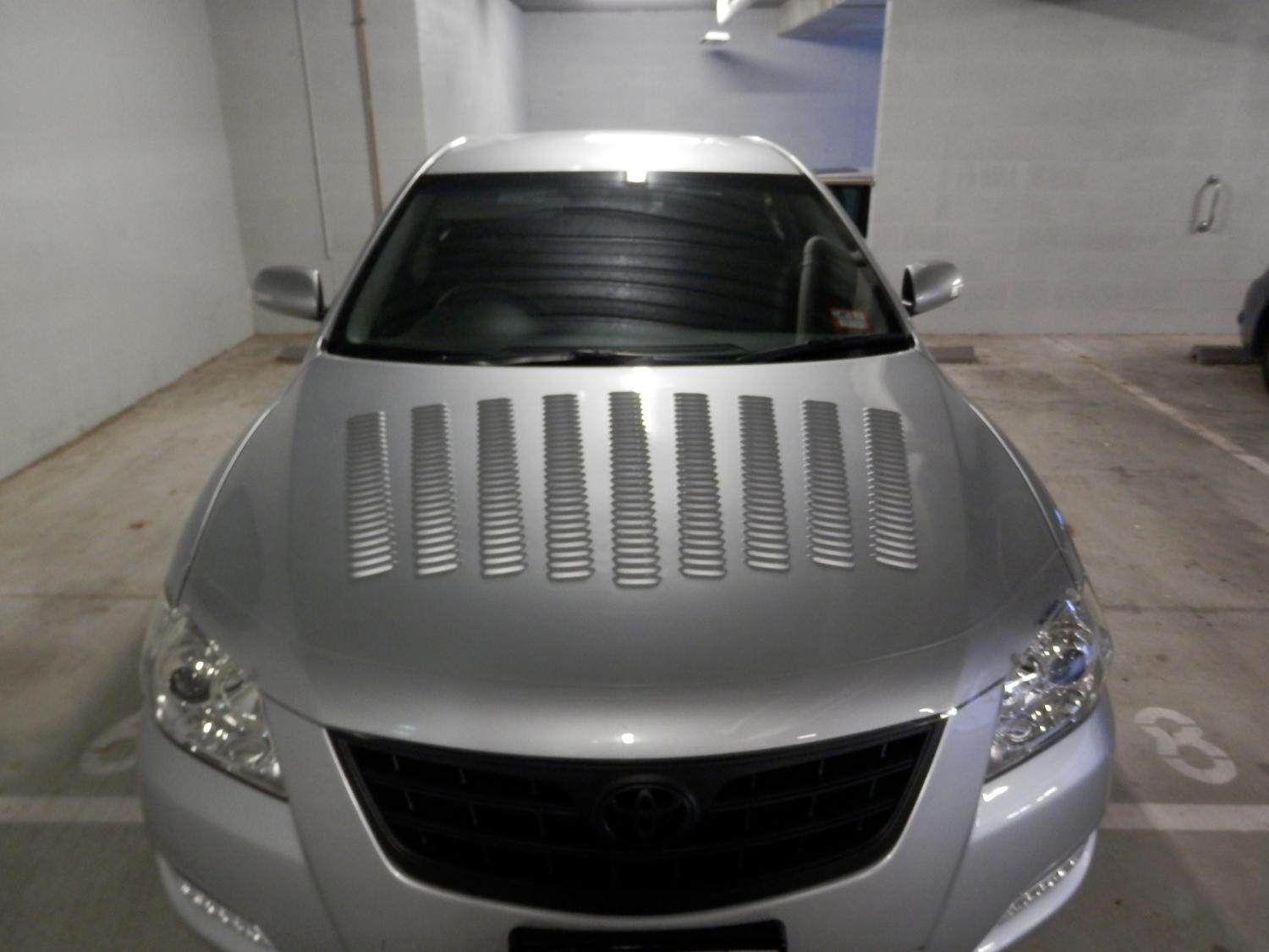

  3. It is a personal statement and the guy that did it for me agreed that we should fill that bonnet as the old school cars might have maybe up to a hundred or so. You've probably seen the oldies with them and they look great but here we wanted to make the car stand out. With the rims we were going for a slant on the muscle ol' school look.
  4. As far as I know it's the only modern car in like anywhere that has a louvered bonnet/hood. It get the looks and keeps the motor cooler in there.
