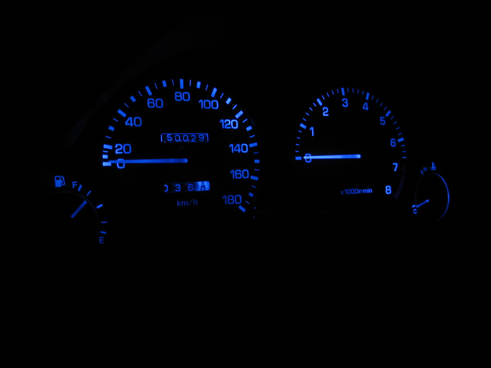

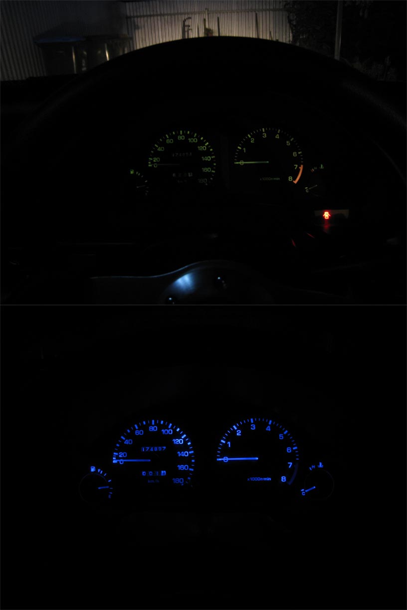

i also attached an image before and after of the dash
doesnt look too bad, alot better then the dull green glow
