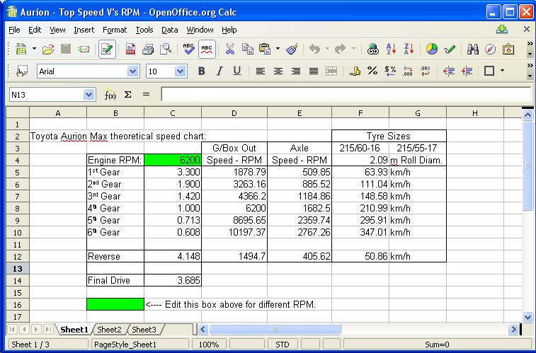

i have made up a excel template to show what your car is capable of in theory.. lets say at max rpm where horse power is calculated, 200kw @ 6200 rpm, in 6th gear the wheels would be doing 347km/h providing you have the standard wheels on it :)
