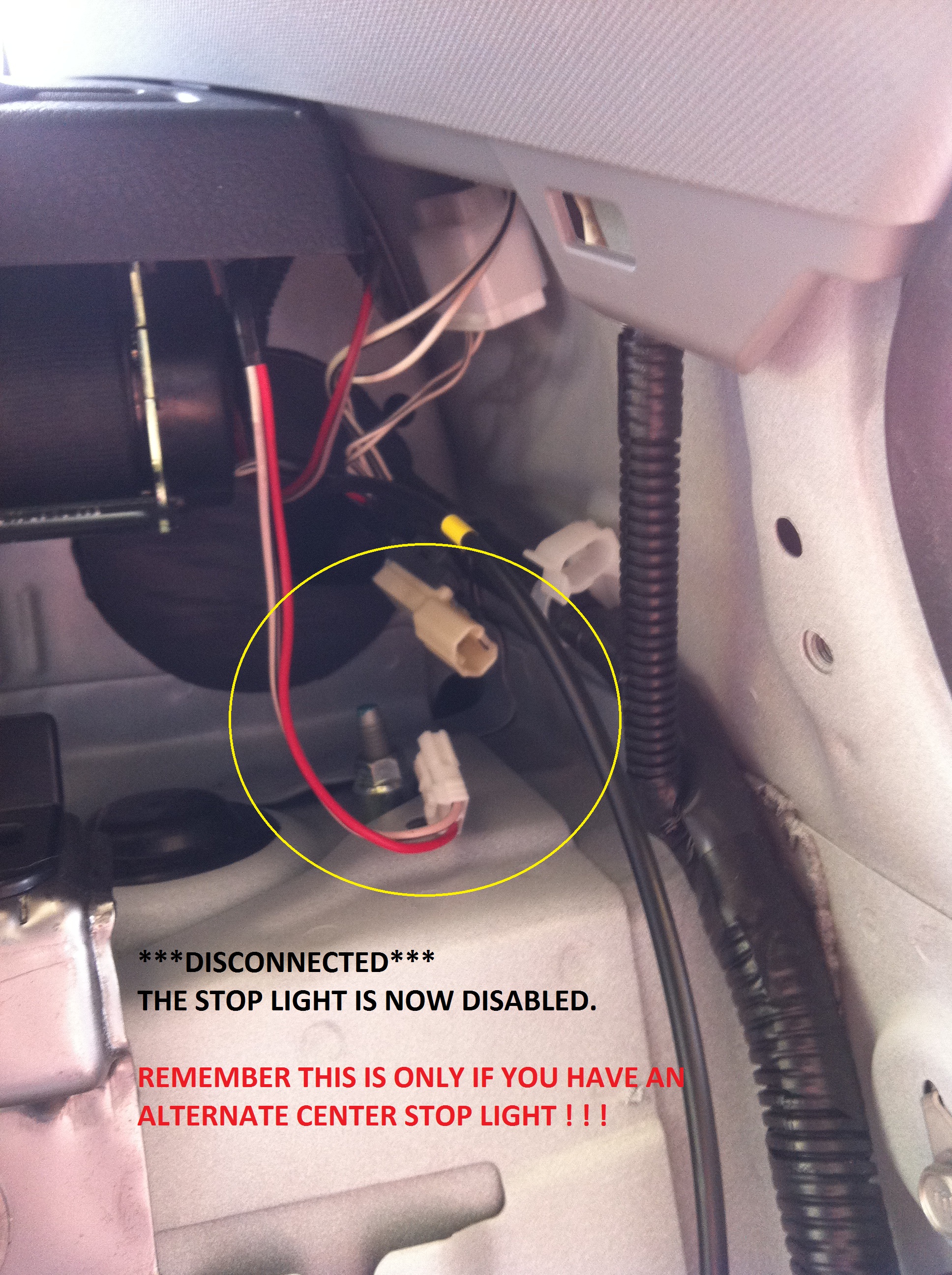

So i recently installed a rear spoiler to my 09 Aurion ATX... With the ATX they DON'T come with a spoiler standard so they have placed a center brake light on the rear shelve, no issue... EXCEPT SHELF IS MOLDED! You just cant pop it open to disconnect.

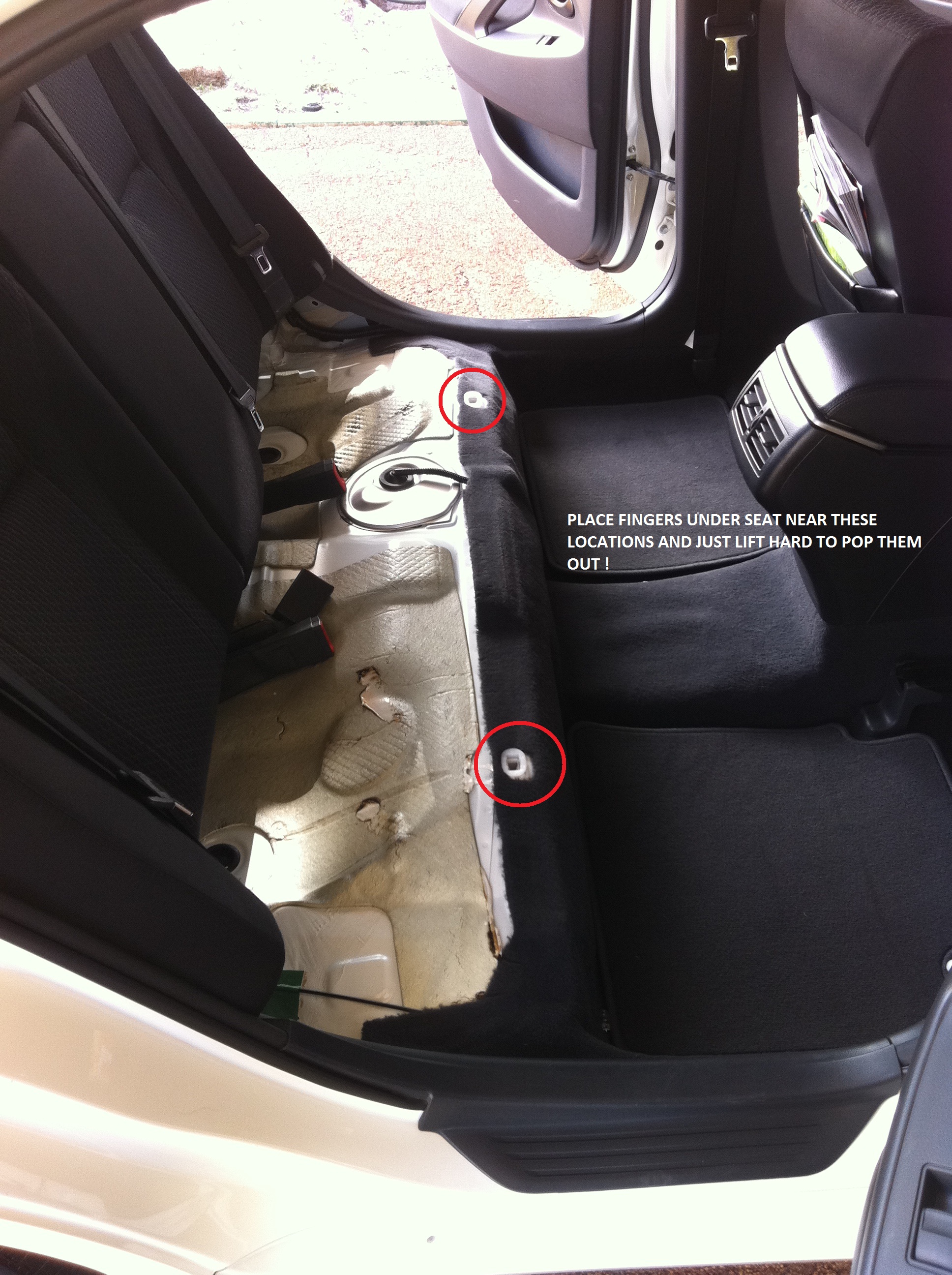

So here is some quick simple steps to remove the rear seat out and get to the correct plug to give it a yank !
( Light reflects off the rear spoiler at night and gives a red glow in rear view mirror + looks weird :P )

STEP 1
post-21214-0-15914600-1306041785_thumb.j

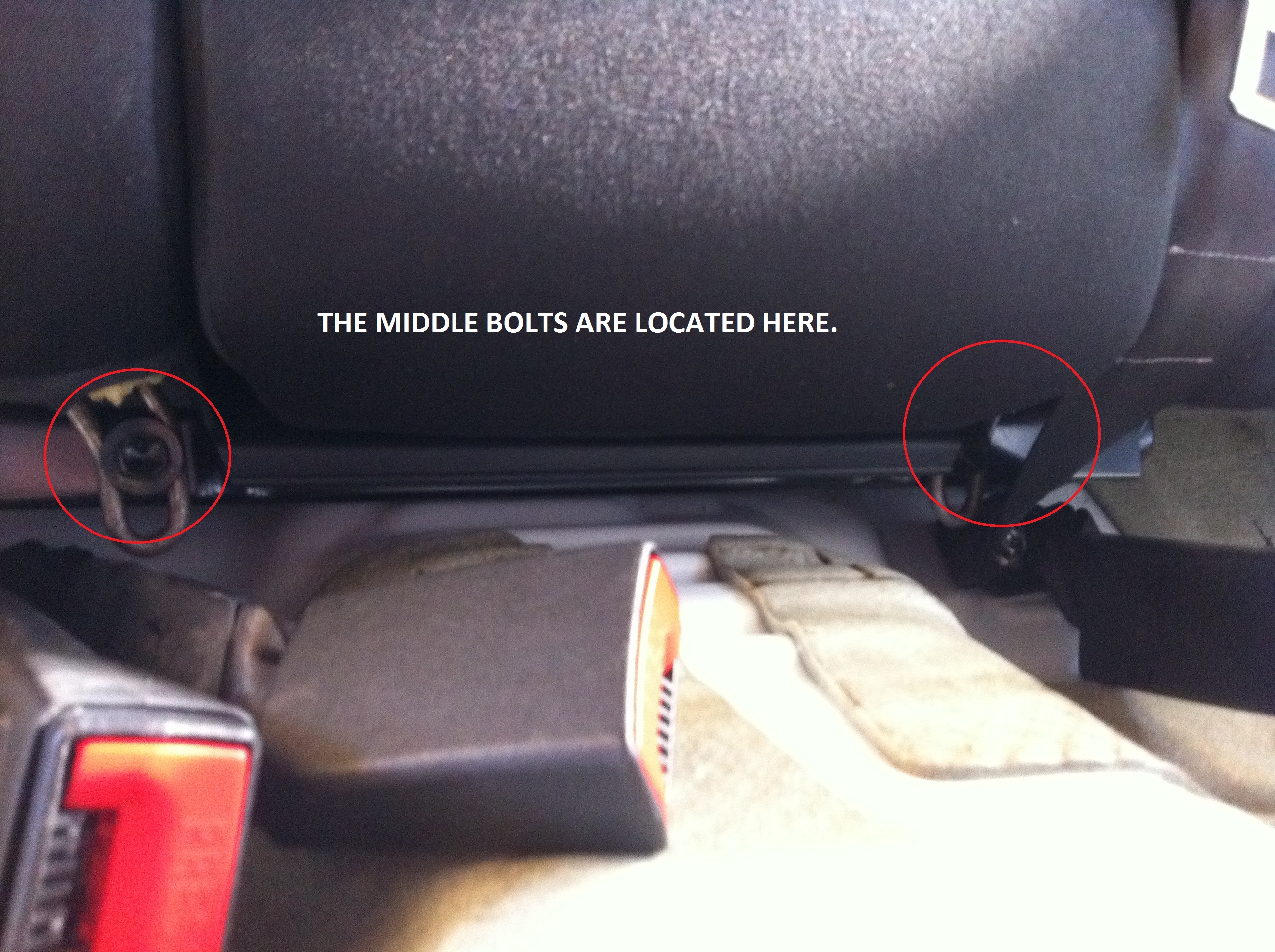

STEP 2
post-21214-0-88363100-1306041806_thumb.j

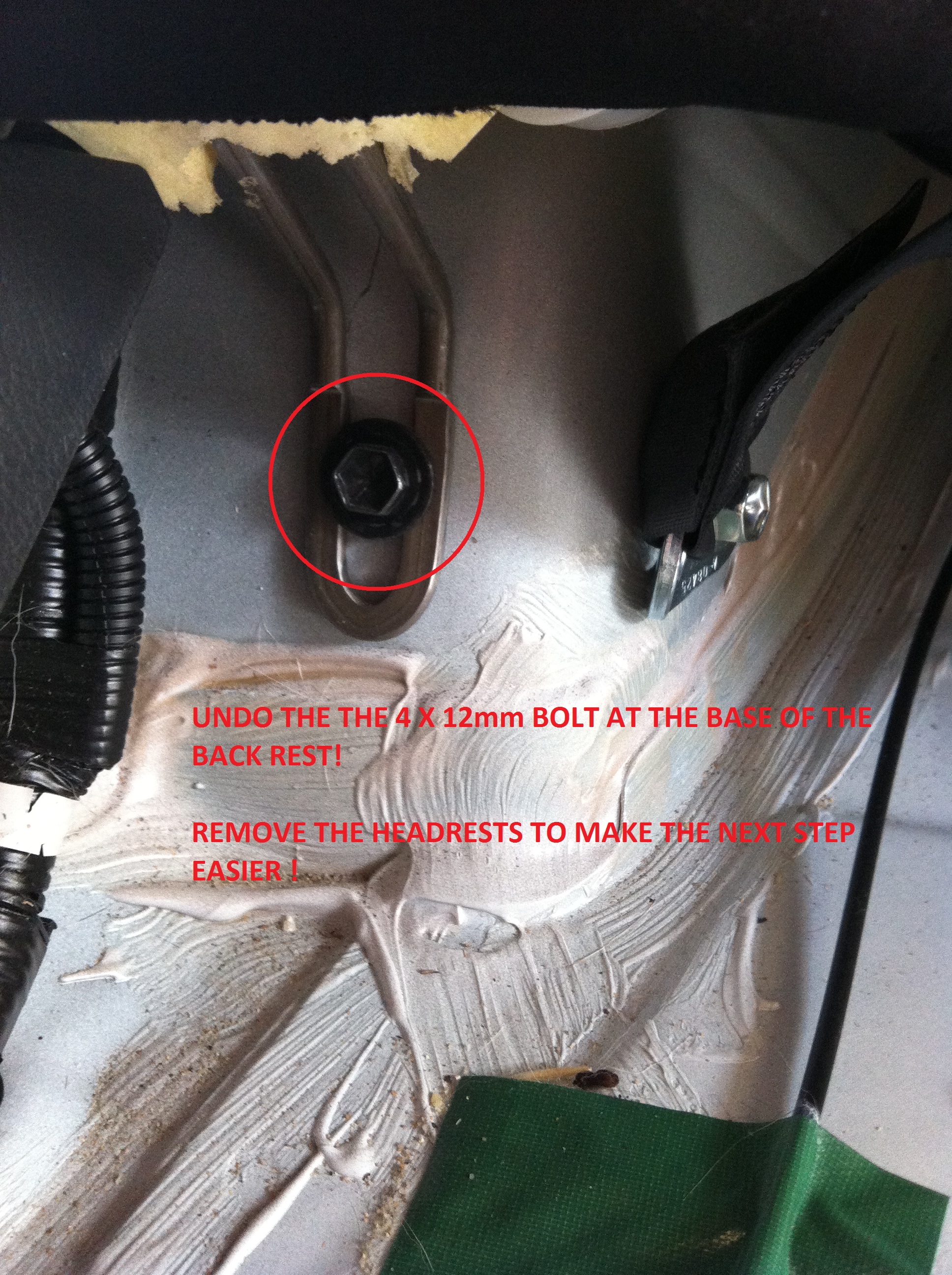

STEP 3
post-21214-0-21547600-1306041825_thumb.j

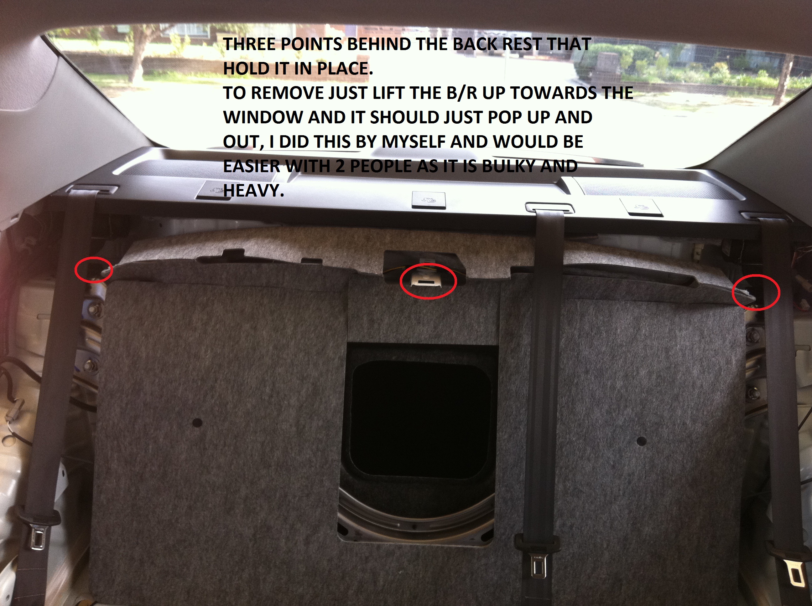

STEP 4
post-21214-0-45605000-1306041841_thumb.j

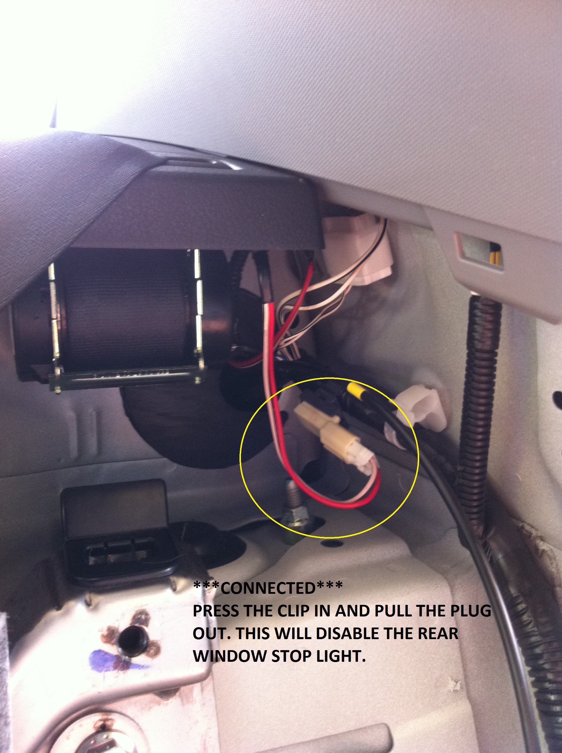

STEP 5
post-21214-0-51445400-1306041856_thumb.j
STEP 6
post-21214-0-62038400-1306041874_thumb.j
